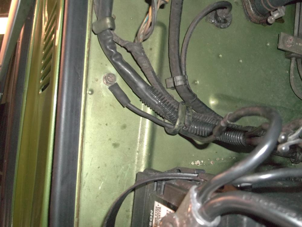

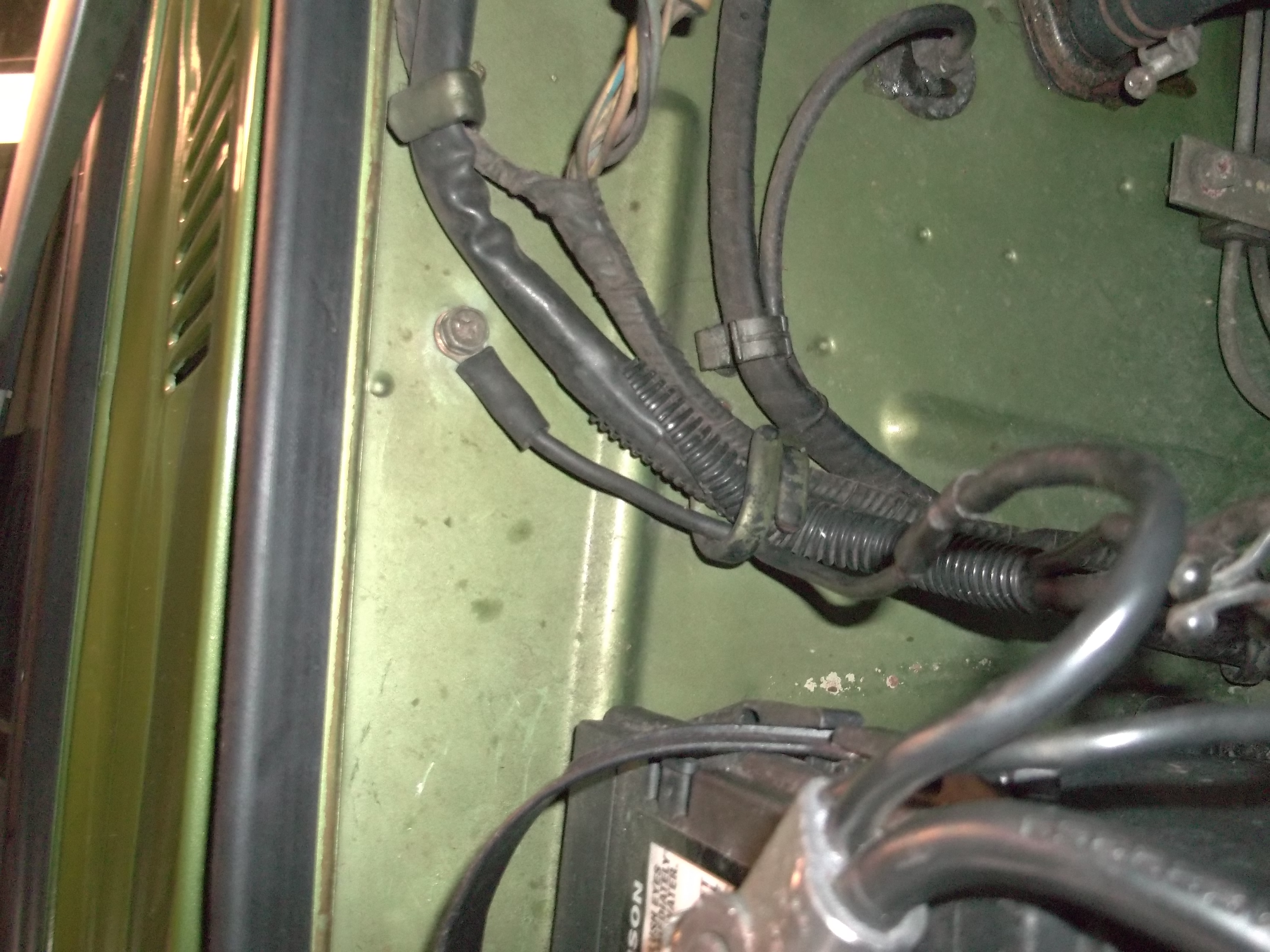

On my 75 there is a direct connection from the battery to the chassis up near the fire wall. so the neg term has 3 leads a big one to the starter mount bolt, one to the EFI harness and one to the chassis thru the firewall bolt. there are more of course but those are the ones directly connected to the battery. interesting how they kept changing that stuff around. I suspect the firewall bolt one may be missing if the battery cables are non OE, its a pretty short connection of about 6-8 gauge IIRC.

added pic
Yeah, the diagram for the 75 and 76 are the same, and what you suggested is exactly what I think happened. The original battery cables are long gone, and the replacement cables did not have provision for the pigtail firewall ground connection. That left only one tie point built into the body wiring harness that runs along the pass frame rail along the engine.
One end or the other of that wiring harness tie point wasn't making good connection, so the body (and everything on the entire car that uses a body connection as ground) was floating. Stuff don't work so good like that.  :)
added a pic. I found that battery connector at a local retail auto parts place, the thicker ground wire was not quite long enough to reach the fire wall, so I had to splice the OE lead. I was careful to get a good soldered joint there. Note the wire from the battery lead was actually a larger gauge than the OE lead to the firewall.
I considered getting the larger gauge to finish the connection but figured if the OE gauge was ok per design I would not need it any larger.
