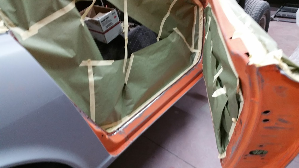

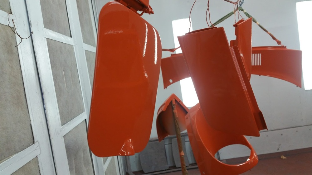

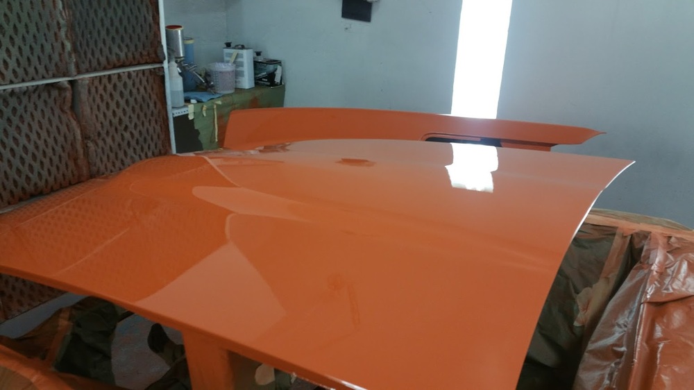

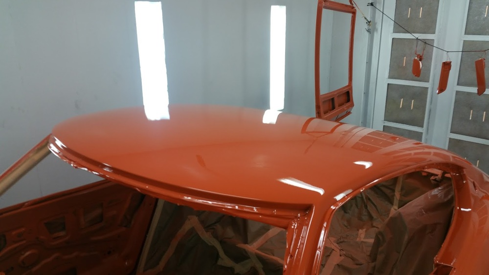

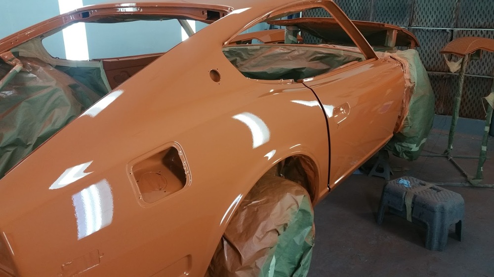

August 22, 20177 yr comment_528618 Door jams, hatch area, and engine bay first. Best when car is mostly disassembled. This is what my paint shop did. Pics on this link near bottom of page 7 Link to comment https://www.classiczcars.com/forums/topic/58366-best-way-to-rebuild/#findComment-528618 Share on other sites More sharing options...
