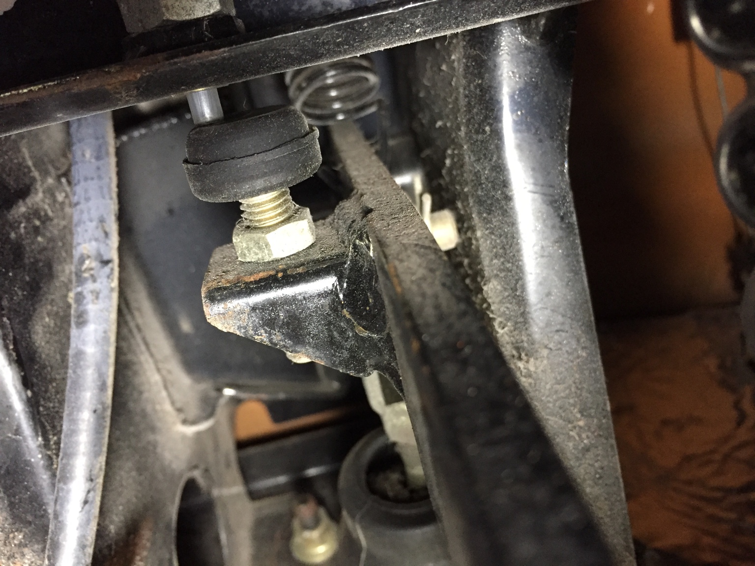

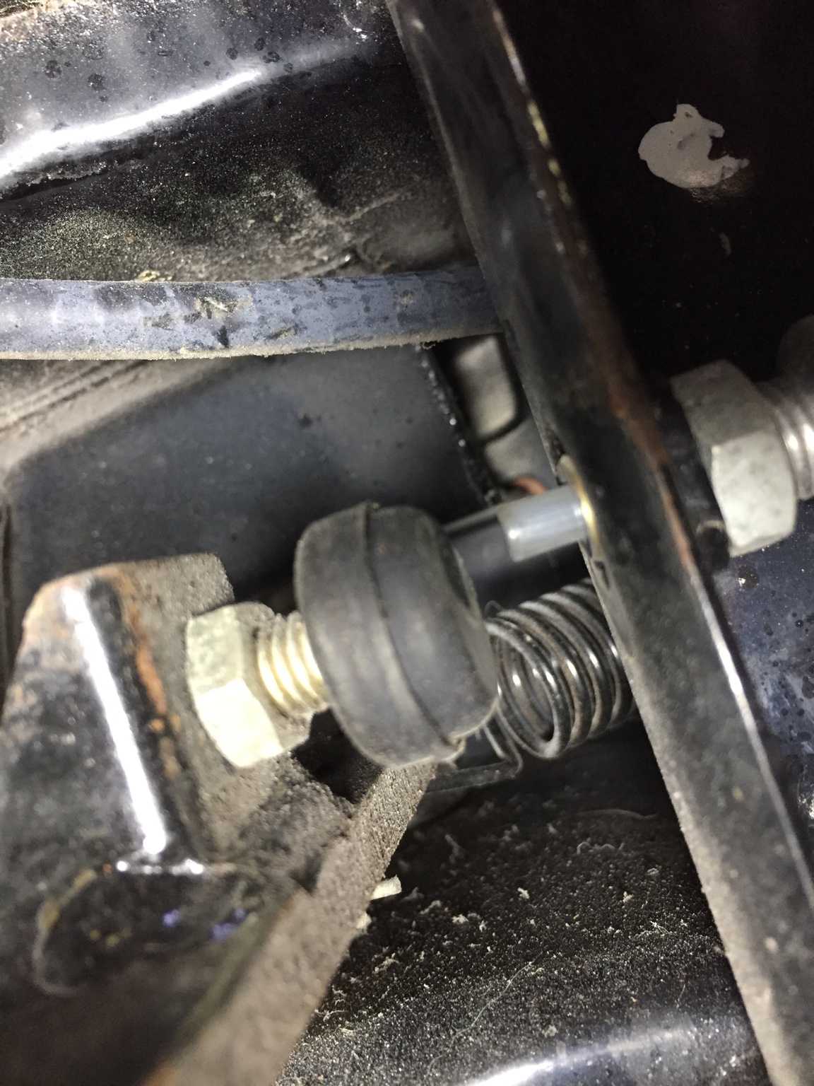

Here are some photos I hope they help. This on a 72. The nut is 12mm and once loose you should be able to turn the bolt by hand with the petal return spring pressure off.
This bolt operates the brake light switch also.
