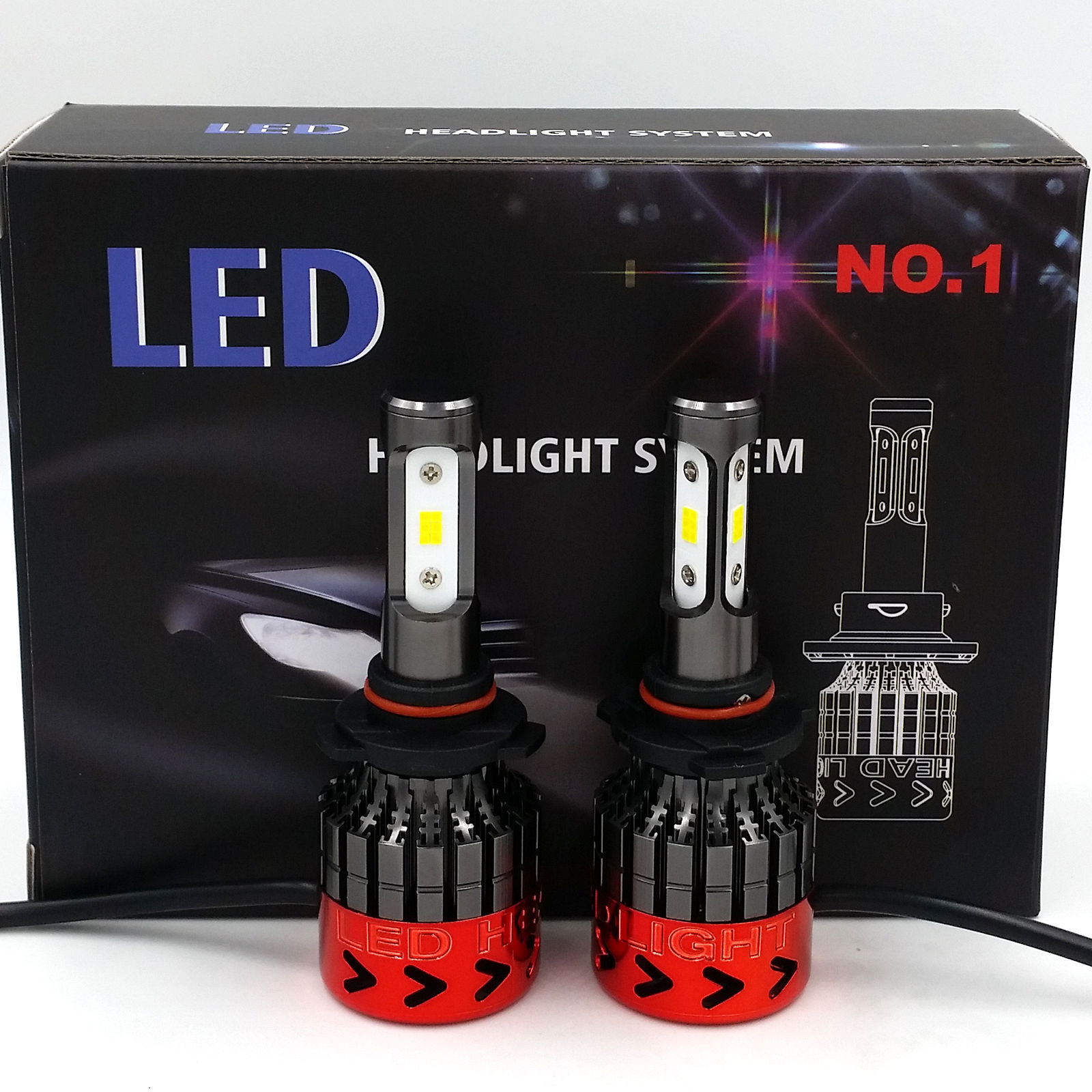

Do those bulbs have a large heat sink or fan on the back side for cooling?  Like this generic example?
They certainly appear too large for the stock housing.
EDIT: Upon following your link, it looks like the set you bought are like sealed LED beams?  The bulb doesn't appear removable, which is why they fit in the stock housing?

That is correct. These bulbs are basically like a sealed beam bulb (same size as a H6024 sealed beam standard 7" bulb), the actual light source is integrated. It's not like a 7" round housing that you then put your LED bulb in that then sticks out the back another few inches. It's like a standard H6024 sealed beam bulb that fits in the standard headlight bucket (with some patience to fit the anti flicker module in there too). From the lens back is cast aluminum, not plastic, so I don't see them having any warp issues from stress or heat. As you can see from the link there's quite a bit of aluminum surface area on the back of these bulbs for heat dissipation, no fan. I've got them in bog stock headlight buckets.

That makes me think that any of the LED bulbs that ARE removable won't fit in the stock housing, doesn't look to be at least.
Looks like a good design with the heat sinks.  I've heard that LED headlights produce a lot of heat on the back/connector side for some reason that I don't know.  It seems crazy to have a fan to cool light bulbs.  But I think it's covered with your setup.  It would be interesting to see what kind of voltage you are getting to the LED's through the stock wiring. I suppose it's not a big deal if it's less than 12v, due to the nature of LEDs.
