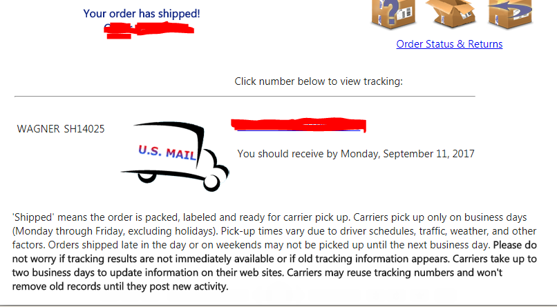

This is kind of funny.  Rockauto says the order has shipped already.  Should just be four thin parts in an envelope, USPS.  But it's expected to arrive in eleven days.  Do they still use Pony Express?  Even that would be faster.  Might be cool enough by then to try a set out.  Supposed to have a heat wave next week, so no tire removal happening then.
Apparently, creating a label is "Shipped!" to Rockauto.

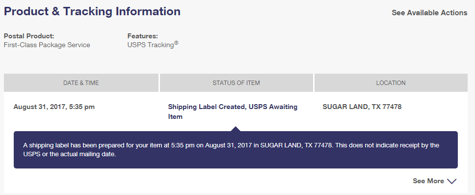

It's because they're in Sugar land, Texas., Just West of Houston... Shipping into or out of these areas is gonna be slow for a while. I have found in the last couple of years every vendor says it's shipped when the label is created. I always have to wait a day or so because I can actually track a package...
Good point, I didn't make that connection.  I'll bet that i don't see them for months.  Not a big deal.
