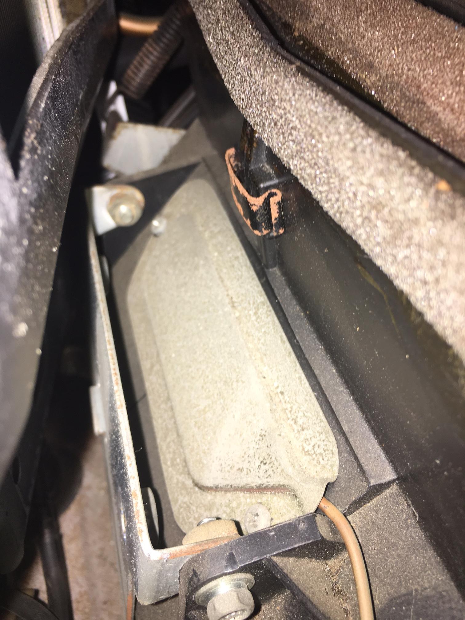

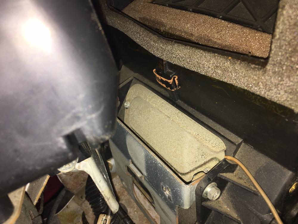

Hi everyone,
I tried to prove Captain Obvious wrong but failed. With the a/c evaporator sitting there blocking the mounting plate for the copper tube it is impossible to access the screws. The dash was actually easy to remove. The heater valve is on it's way to Z Car Source of Arizona for direct exchange for a rebuilt unit.
Siteunseen, I did have to purchase an offset ratcheting screw driver like the one you pictured in order to remove several screws.

32 minutes ago, 882993md said:
Ā
I could have told you that's not possible! Isn't that obvious... :P
You give me way too much credit.Ā  :)
Sorry you couldn't prove me wrong on this one. I was really hoping you could. So much work for two stupid little screws! I've pulled the dash a number of times, and I agree. It's not really that difficult, just awkward. The A/C evaporator in there really crowds things. If it weren't for that, you would probably have been able to get to it from the front.
Anyway, glad you got it out, and here's hoping you're back on the road in no time!

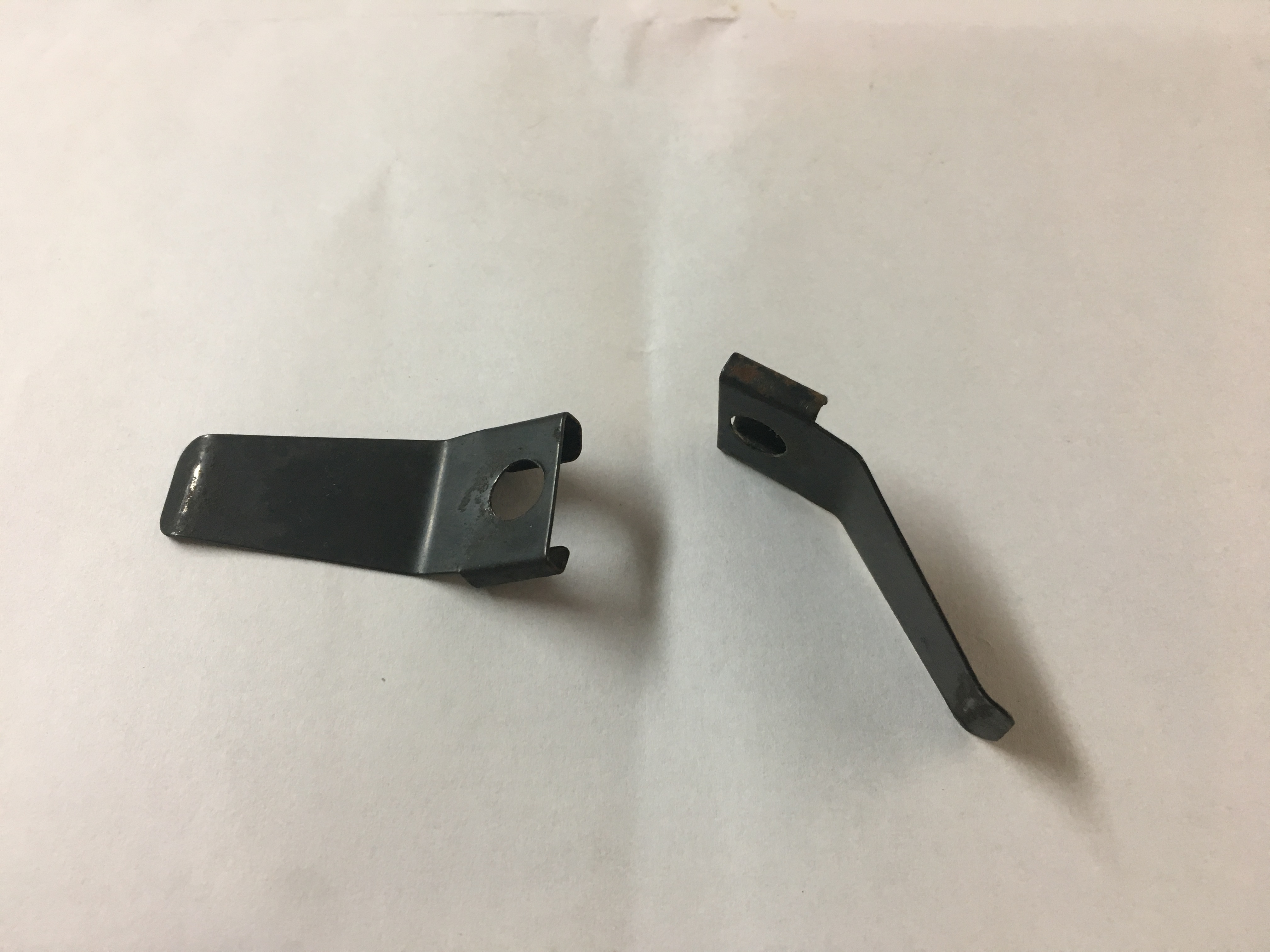

I’m just about ready to reinstall the instrument panel,Ā Ā however for the life of me I have no clue where these two parts go.Ā
I’m pretty good at taking pictures but I can’t find one pic that contains these two parts. Any ideas where they are installed?Ā
