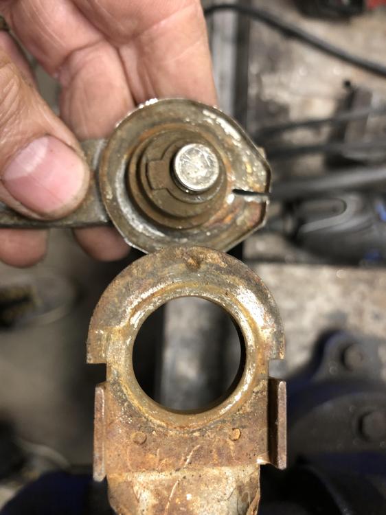

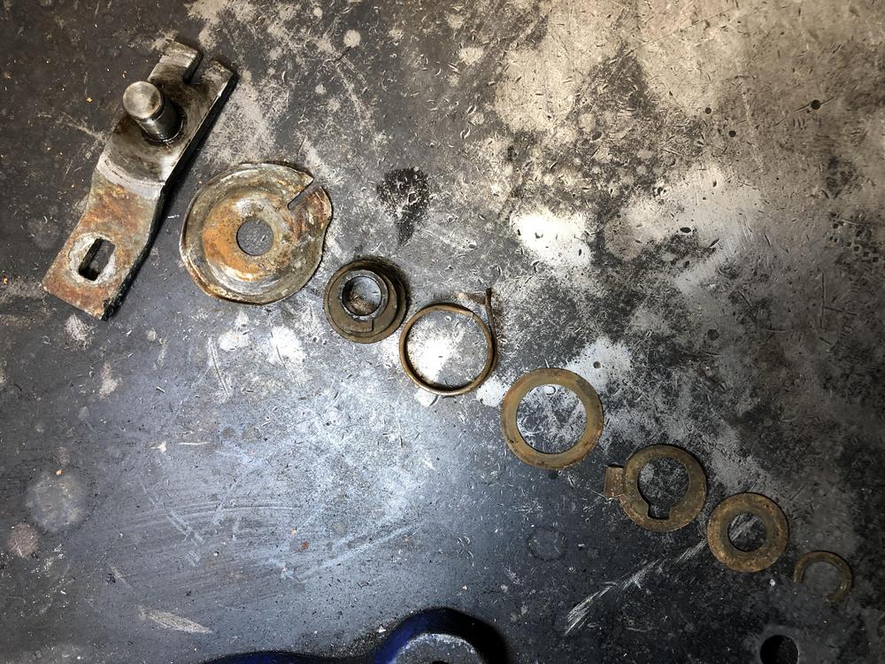

As I am today rebuilding another wiper linkage, I thought I would contribute some more detailed pictures of the fancy wiper park components for future posterity.
Out of, ahem, "several" available wiper linkages, I have only a single one that has an unbroken spring.
Thought I would include detailed pictures of it in hopes of some day creating new ones, as well as to show the assembly order and position of all the components
Here is the little spring with oft-broken off hook engaged where it belongs
Complete and broken example for comparison of where the break happens and how long the bent tang is
Clever photography (ie move it around until you can see it), shows the shiny spots and wear on the bottom of the spring.
All the bits and pieces in order from top to bottom. Top is defined as having the end with the (poor excuse for a ) snap ring/C-clip pointing up when you're taking it apart.
 I have used a real compatible sized E clip to replace that obnoxious soft C clip thing.
This gives you a visual idea of how the eccentric cam part fits with the hole in the arm, effectively changing  the arm length as the cam rotates.
Another shot showing how the spring and the "millennium falcon" part with the slot are arranged in the assembly.
Clearly this proves the designer of said space ship in the movie was a Datsun owner.
