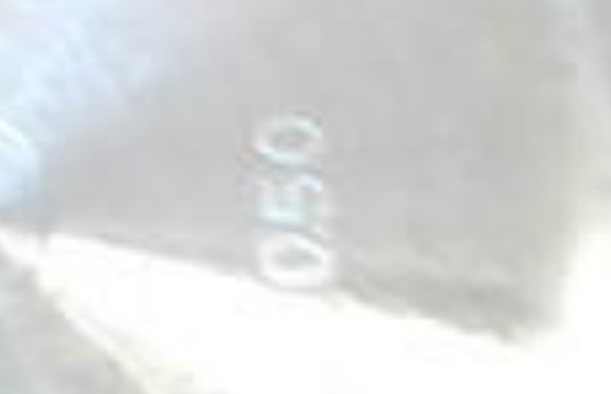

siteunseen Posted September 14, 2017 Share #14 Posted September 14, 2017 Rebelloracing.com would have them most likely, if you're in a hurry. I have seen tens of adds on ebay at a time for a small oversize ITM piston to fit a slightly cut cylinder bore. Zed Head has a great idea, search .5mm. Or go balls out like Dizeazed and have it cut to .030 & shave the head as much as possible without shimming the cam towers. Good luck, hopefully this won't be a big deal bump in the road for you. 1 Link to comment Share on other sites More sharing options...

Diseazd Posted September 14, 2017 Share #16 Posted September 14, 2017 Listen good to the advice you are getting NMcKe97. You'll live with the engine for a long time. The P79 chambers are large....piston contact is not a problem, and even with the flat tops, you will still have a very low compression engine. 1 mm (.040 inches) overbore is the minimum I would bore....ITM Pistons have worked well for me. Nissan used flat tops in the 82 ZX's NA engines.....still was a very, very low compression engine. 2 Link to comment Share on other sites More sharing options...
