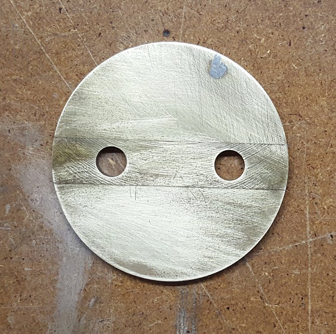

November 29, 20177 yr Author comment_536202 Okay, after reading the post that Philip provided you guys have convinced me to take the carb off and take a closer look at the throttle plate. I do not want to risk any damage the bores in the carb body. Tonight I will attempt to fill the hole and smooth out the outer edge. Seems do-able with some rosin flux and solder. Link to comment https://www.classiczcars.com/forums/topic/58524-hardways-red-rocket-1972-240z-build-thread/?&page=5#findComment-536202 Share on other sites More sharing options...
November 30, 20177 yr comment_536229 4 hours ago, Hardway said: Okay, after reading the post that Philip provided you guys have convinced me to take the carb off and take a closer look at the throttle plate. I do not want to risk any damage the bores in the carb body. Tonight I will attempt to fill the hole and smooth out the outer edge. Seems do-able with some rosin flux and solder. i think that is a good idea. brass solders fairly easy Link to comment https://www.classiczcars.com/forums/topic/58524-hardways-red-rocket-1972-240z-build-thread/?&page=5#findComment-536229 Share on other sites More sharing options...

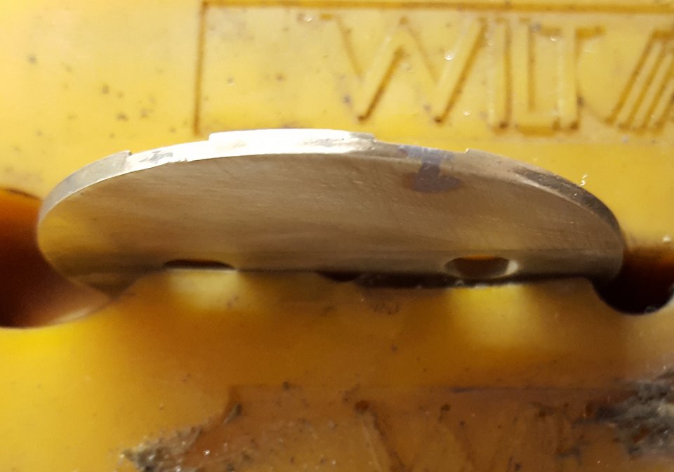

November 30, 20177 yr comment_536255 Well I wouldn't necessarily give up on the replacement and go back to trying to fix the old drilled one. My biggest issue with the replacement is the burrs. I'm worried that they will gouge the aluminum casting inside the carb throat. But it's not hard to fix. You should be able to dress the burrs off easily with a piece of sandpaper on a hard surface. Couple swipes and they should be cleaned off. Just make sure you don't get too aggressive and remove good material. Keep the corners sharp, but not burred. The rest of the workmanship stuff is annoying, but won't affect performance. Except...... Have you verified that the edges are bevel cut and not straight cut? Can you see the bevel on the original plate? Edited November 30, 20177 yr by Captain Obvious Attached pic highlighting burrs Link to comment https://www.classiczcars.com/forums/topic/58524-hardways-red-rocket-1972-240z-build-thread/?&page=5#findComment-536255 Share on other sites More sharing options...
December 4, 20177 yr Author comment_536564 Per everyone's input and suggestion I took a stab at filling the hole in the old throttle plate. Using my soldering iron and some rosin flux paste I let it really cook in the crevice the hole. With it still hot I added solder to it. Once everything cooled I started sanding the solder down with some 600 grit sand paper. I followed the up some 1000 grit and then some super fine 0000 steel wool to clean up the plate. The surface is super smooth despite the visible scratches. I paid attention to maintain the taper of the edge of the throttle plate so that I only flattened the solder and did not disrupt the angle of the taper. All in all it came out better than expected. I really kick myself for not doing this first as it would have saved me $15 and 2 weeks of time. Oh well, need to take more changes in life! I swapped out the throttle plates and after studying the new one some more I could see the taper on the edge was not as steep as the taper on the original. I checked the bore for any grooves and could not see or feel any. With everything re-installed and buttoned up I fired the engine back up and at idle I am getting a solid 5 on my sync-meter across all six bores. Throttle response all seemed the same as before but I rest easier knowing the right part is in the carb. Link to comment https://www.classiczcars.com/forums/topic/58524-hardways-red-rocket-1972-240z-build-thread/?&page=5#findComment-536564 Share on other sites More sharing options...

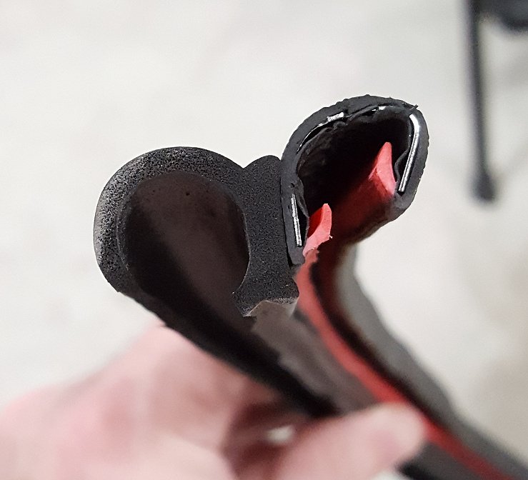

December 4, 20177 yr Author comment_536570 With the valve adjustment done I turned my attention to the driver side door. With the rebuilt hinges the action of the door was much more solid but in order to close it required slamming it hard as I could. Knowing the new weather stripping was a bit big I removed it to ensure the door was aligned properly. With the weatherstripping off the door closed like butter, effortlessly latched, and opened with almost elegant satisfying sound you expect and want in any vehicle. Since the door was spot on I took a risk and cut the bottom third of the weatherstrip off along the lower half of the door opening. This helped a lot as now the door only required a good push to close all the way. However this is not what I want to have to do to close the door every time so I am looking at the Kia Sportege seals and taking a long look at the McMaster-Carr weatherstripping. There is already another recent thread on this topic and I will be following it as well. Link to comment https://www.classiczcars.com/forums/topic/58524-hardways-red-rocket-1972-240z-build-thread/?&page=5#findComment-536570 Share on other sites More sharing options...

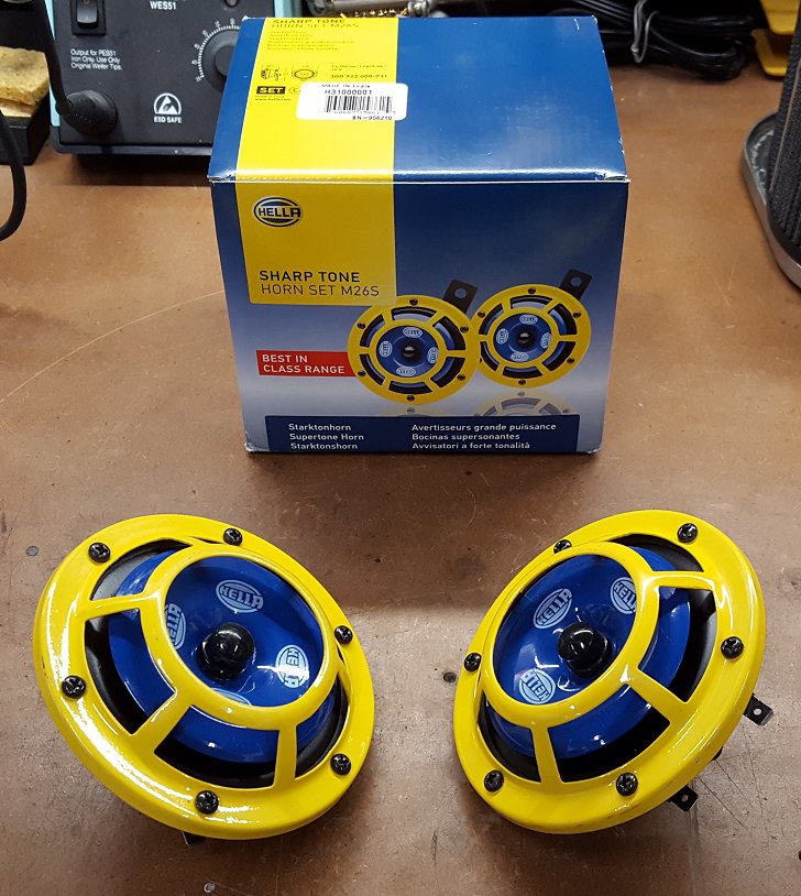

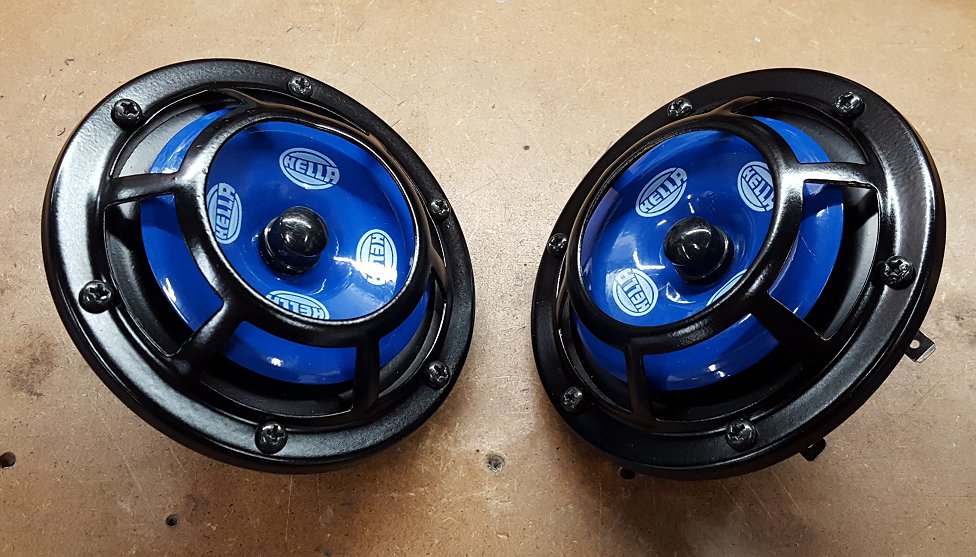

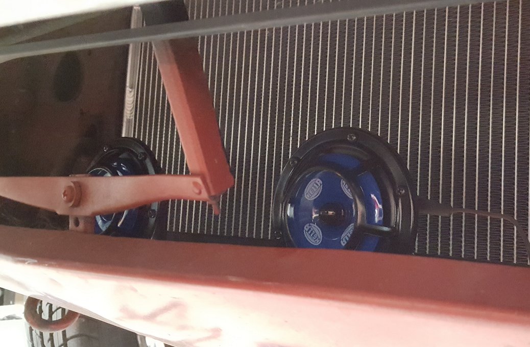

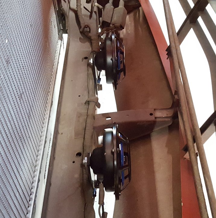

December 4, 20177 yr Author comment_536573 As previously mentioned one of my horns was not working properly and I have purchased a restoration kit for them. I want to get the car on the road as soon as possible so I decided to run some after market horns for now. After some research and YouTube comparison videos I settled on some Hella Sharp Tone horns for $27.99 shipped off eBay. Don't let the name fool you, they sound like modern loud vehicle horns. They come with yellow cages on the front which would make them stick out from the rest of the car so a color change was in order. After a once over with some steel wool to knock the shine off the paint I put two light coats of satin black on them. Painting conditions were not ideal this weekend and but they look much better and on the car you don't really notice them, which is the point. With the horn button pressed everyone in the immediate area will take notice! Link to comment https://www.classiczcars.com/forums/topic/58524-hardways-red-rocket-1972-240z-build-thread/?&page=5#findComment-536573 Share on other sites More sharing options...
