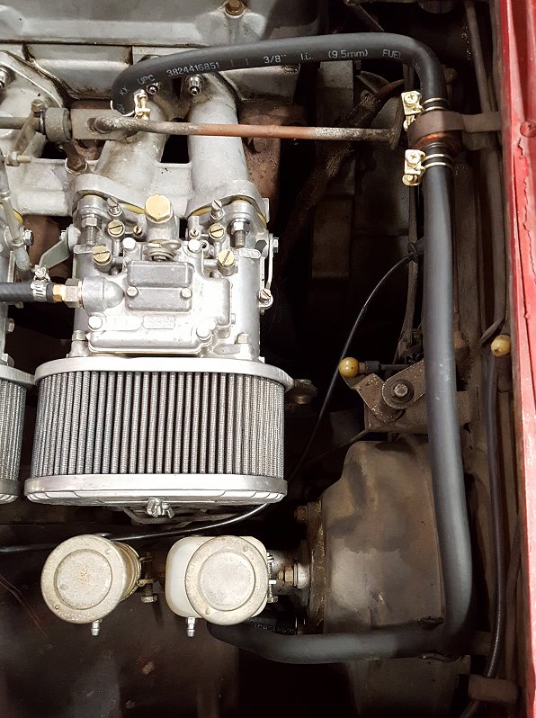

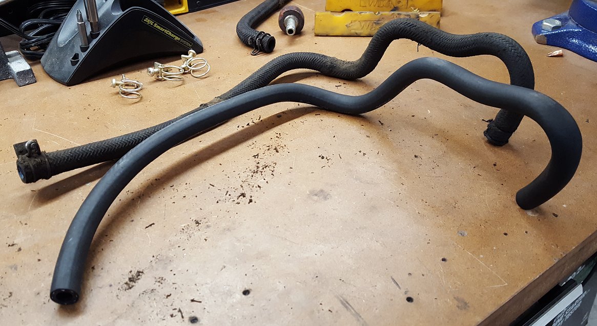

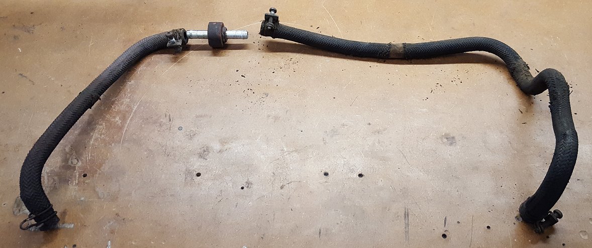

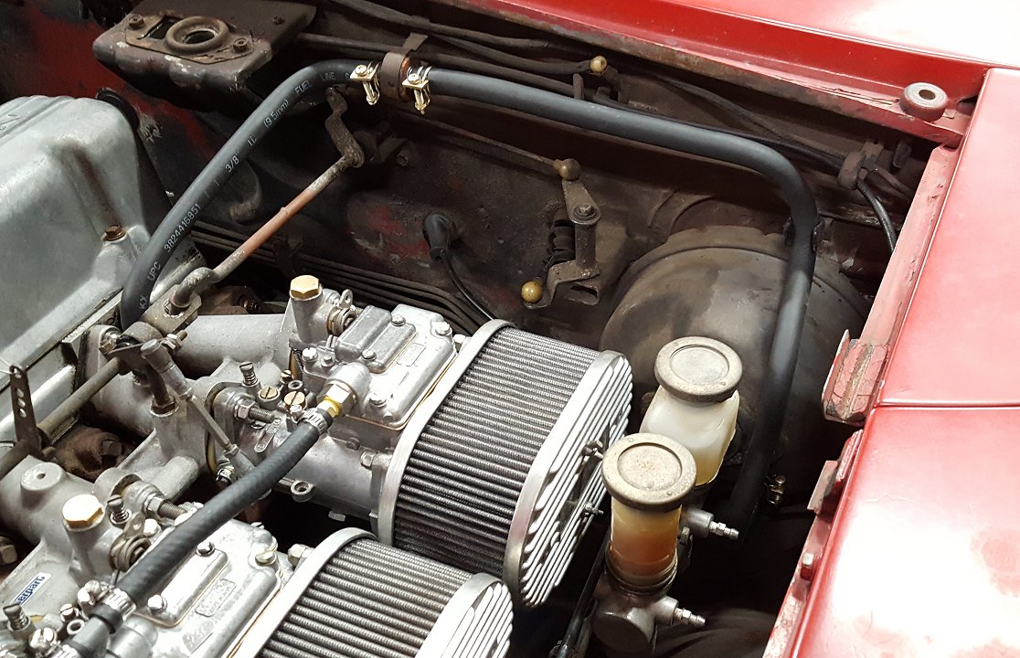

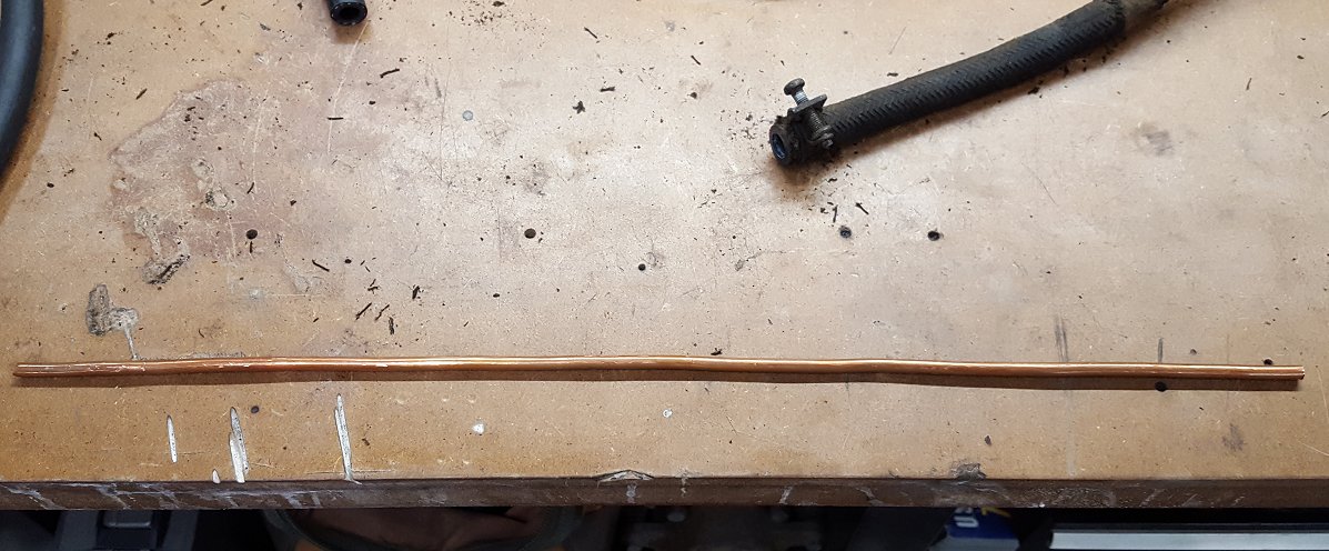

December 22, 20177 yr Author comment_538154 Last night I resolved something that has bothered me ever since I started working in the engine bay... the absolute sorry state of the brake booster vacuum hose. Every time I touched it or breathed hard near it, more of the deteriorating braided fabric would crumble off or leave some part of my skin or clothing dirty. This is no surprise since it is the original hose and I am sure many others are dealing with the same issue. Leaning on the replacement hose experience that AZ-240z made me for my series-1 240z, I knew I could make a new one on my own. I pulled out some solid copper wire I had laying around and straightened a 16" piece of it with my bench vise. I inserted the copper wire in to some 3/8 inch fuel vapor hose and started bending. After about 10 minutes I was pretty happy with the overall shape. I left both ends a little long so I could trim them to fit once they were on the car. I did the same for the smaller hose and used a piece of 4" copper wire at each end to accomplish the bends. With the hoses on the car I did some trimming and adjusting so they fit right. While I was at it I installed some freshly yellow zinc plated original style hose clamps to add a little bling. The end result is not factory or restoration accurate but it is worlds better than what was on the car and fully functional. A few things to note from my personal experience. This was actually the second booster hose I made. When I did the first I used 24 inches 1/4" copper tubing which is much easier to bend and I recommend it over the solid copper wire. However, 24 inches was too much and I had no way to cut it down or push it out once I had formed the hose. When pushing the copper in to the hose, make sure you push it in far enough so it does not interfere with the ports that each end will go on to. That is why you really only need 16 inches of copper. Of course this makes bending the curves on the ends a little challenging but it is do-able. The best part of this project is if you completely mess up, the cost to try again is minimal. Additionally, you are saving yourself a lot of money over buying some pre-molded hose unless you truly need restoration caliber hoses, in that case be prepared to pony up. Next up is my modified choke cable project. Stay tuned and Merry Christmas everyone! Edited December 22, 20177 yr by Hardway Link to comment https://www.classiczcars.com/forums/topic/58524-hardways-red-rocket-1972-240z-build-thread/?&page=7#findComment-538154 Share on other sites More sharing options...

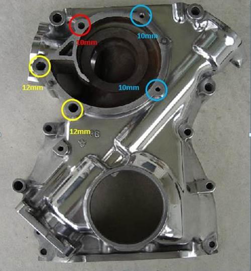

July 29, 20186 yr comment_554073 10 hours ago, Hardway said: Further investigation revealed that one was truly missing and the other is broken off in the timing cover. I wonder how many thousands of Z's suffered from this particular affliction. The problem bolt is the 10mm (M6) item located at the 10:30 position... x I think that innocent-looking bolt head probably fools a lot of first-timers because it conceals the fact that the hole in the timing cover is just a pass-through, with the bolt actually threading into the front face of the engine block. That means there's an inch or so of freestanding length sitting proud of the block face -- permitting just enough wind-up under wrenching torque to trick you into thinking that the threaded part is starting to move. And then.... 'SNAP'. Just for fun, I simulated the set-up by locking a 10mm bolt (6mm shank) in my bench vise and then using an old-style torque wrench to see how much torque it would take to snap the bolt. I located the start of the threaded section right at the face of the vise jaws, with the 1-1/2" unthreaded length sitting about the jaws. IIRC, the bolt broke at under 10 lb-ft! . I was just using a hardware store bolt, but I don't expect that the Nissan OE bolt would offer much more than double the strength. So the threshold between, 'I think it's moving' and 'uh-oh' is about 15 to 20 lb-ft. If the bolt was infinitely strong, I'll bet it would take 30 - 40 lb-ft to break the frozen threads free. So it looks like a losing proposition if your only solution consists of leaning on the wrench just a little harder. Just for comparison's sake, the bolt torque reference chart for ISO fasteners that's included in Wick Humble's 'How to Restore Your Datsun Z-Car' indicates that the recommended tightening torque for a Grade 4 (per the OE Nissan item) M6 bolt is just 2.5 lb-ft! (and only 6 - 8 lb-ft for the heavy-duty, Gr. 9 version). The L-Series FSM is notably silent on recommended tightening torques for these types of secondary fasteners. What a contrast! Install = finger-tight. Remove = beyond snapping point.. The two other 10mm bolts have their own problems. Just like certain other bolts on the L-Series engine, you have a steel bolt threaded into an aluminum casting, so internal corrosion sets up because of the dissimilar metals. I've had good luck with these timing cover bolts on two different engines by using a small, handheld impact driver and a medium-size mechanic's hammer. Just takes a bit of patience (along with removing the radiator). Link to comment https://www.classiczcars.com/forums/topic/58524-hardways-red-rocket-1972-240z-build-thread/?&page=7#findComment-554073 Share on other sites More sharing options...
July 30, 20186 yr Author comment_554138 Some more progress and some more discoveries. I captured a picture of the cover with the bolts pointing to their home for a reference. I had already labeled the others on my bench. Much like all others it was covered in grime. An initial cleaning got a lot off but a final cleaning it still needed. On a good note, there are no broken bolts in the timing cover or the block including the 10mm at the 10:30 position as referenced above. I cleaned out the one hole in the block that I thought had a broken bolt in it. Turned out it was packed with orange gasket sealant. A sharp pick got most of it out and all threads will receive a good clean out with a tap before everything is reassembled. Unfortunately one of the water neck bolts snapped off. I currently have some ATF and Acetone sitting on it and had fed it a few times this evening. I will feed it some more in the morning before heading to work and try to get it out with some heat tomorrow evening. Any thoughts on my harmonic balancer? My search has uncovered that no one makes an original style balancer and the aftermarket stuff from MSA and Z Car Depot do not accept stock Datsun pulleys should I ever decide to install A/C in the car. Link to comment https://www.classiczcars.com/forums/topic/58524-hardways-red-rocket-1972-240z-build-thread/?&page=7#findComment-554138 Share on other sites More sharing options...
