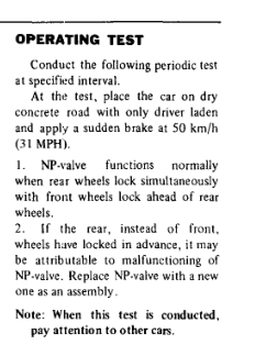

I was being sarcastic about about tzagi1's use of the word "fine".  Your brakes were "fine" with the stock caliper.  With the four piston caliper and bigger pads you created a front bias.  Not fine anymore, weaker in the back now.  Now your front pads and rotors are doing the bulk of the work.
The purpose of the NP valve is to get all four tires contributing to stopping equally.  The whole car is designed to be very well balanced.  The stock stuff works really well when it's working right.

Here is how one knows when the brakes are out of bias, one axle will lock before another, not the case here.

Nissan has a test for proper brake bias, where you lock up the tires to be sure that they're balanced.  So here's the logic - if the stock parts give proper brake bias, how can the Toyota calipers be "better" without changing that bias?  And if they don't change the bias how can they be "better".  They would be the same.  And if they're the same, what's the point of using them?
That's the issue that always comes up with these "upgrades".  What is being improved?
