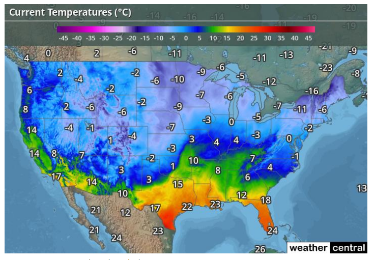

  On 1/22/2019 at 10:38 AM, Home Built by Jeff said:
I have spent the last week sweating it out in the heat fitting seatbelts and reassembling the doors.
Wrong crowd.
