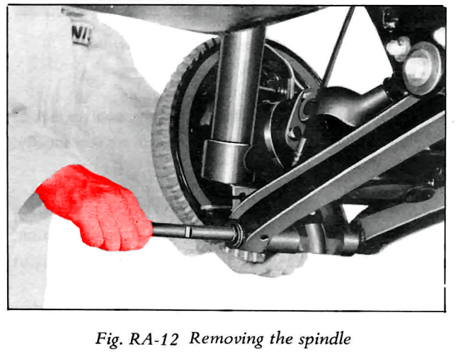

March 7, 20196 yr Author comment_570227 39 minutes ago, Patcon said: You will need a spindle pin puller!! When you do the rear wheel bearings it makes removing the lower control arms possible. I was wondering how it all comes apart. I will need to do some more research about how to do it properly, as opposed to my usual way of blindly undoing things until it comes apart ? Link to comment https://www.classiczcars.com/forums/topic/58542-home-built-z-full-video-build/?&page=46#findComment-570227 Share on other sites More sharing options...
March 7, 20196 yr comment_570233 Spindle Pins are considered a Rite of Passage for Z owners. Lots of good threads here on this site. Link to comment https://www.classiczcars.com/forums/topic/58542-home-built-z-full-video-build/?&page=46#findComment-570233 Share on other sites More sharing options...
March 7, 20196 yr comment_570240 Just the mention of Spindle Pins and I need a drink...Where’s my bottle of Bundy’s? Link to comment https://www.classiczcars.com/forums/topic/58542-home-built-z-full-video-build/?&page=46#findComment-570240 Share on other sites More sharing options...
March 7, 20196 yr comment_570259 Remember Kammy's Red Hand of Power image? @kammy Link to comment https://www.classiczcars.com/forums/topic/58542-home-built-z-full-video-build/?&page=46#findComment-570259 Share on other sites More sharing options...

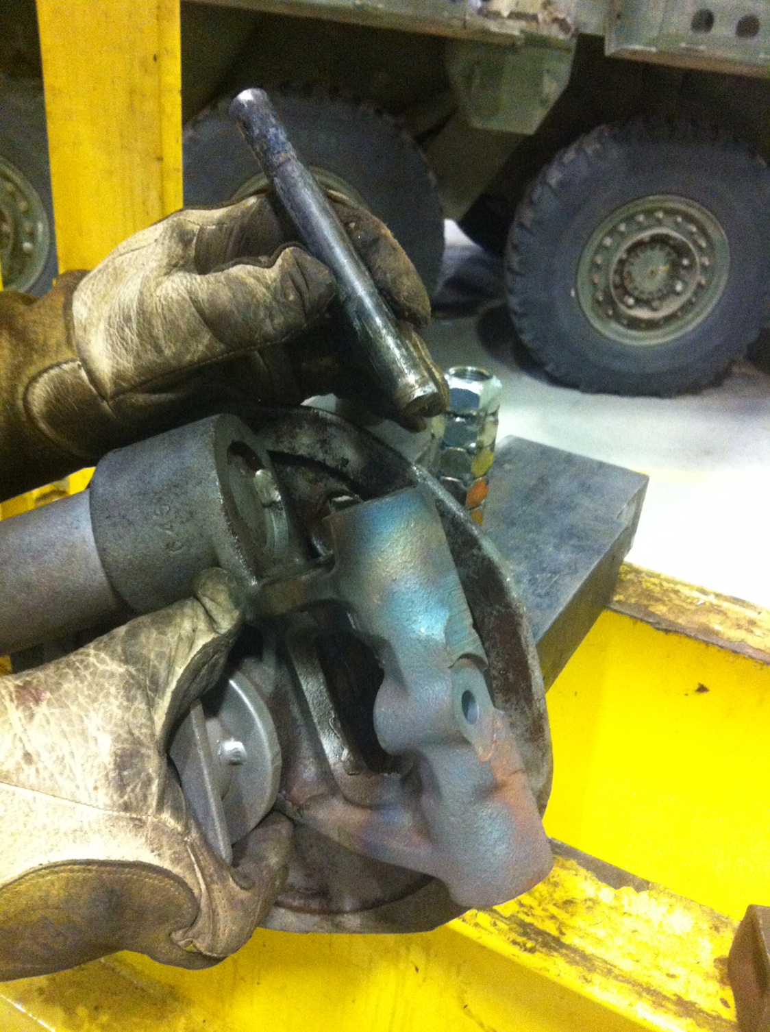

March 7, 20196 yr comment_570260 Jeff. Read through this: http://atlanticz.ca/zclub/techtips/suspension/rearend/index.html P.S. Don't tell your wife about the errand I had Janet do or that will be the end of your resto support! lol Link to comment https://www.classiczcars.com/forums/topic/58542-home-built-z-full-video-build/?&page=46#findComment-570260 Share on other sites More sharing options...
March 7, 20196 yr comment_570262 100 tonne press, acetylene torch and soaked in transmission fluid for three days... barely came out under 60 tonnes of pressure. Link to comment https://www.classiczcars.com/forums/topic/58542-home-built-z-full-video-build/?&page=46#findComment-570262 Share on other sites More sharing options...
March 7, 20196 yr comment_570263 Yeah, glowing red and 60 tons seems to be where they decide to let go, but Jeff whatever you do don't be tempted to get the BFH out, all you will do is mushroom one of the ends that you will need to either press it or pull it out. Link to comment https://www.classiczcars.com/forums/topic/58542-home-built-z-full-video-build/?&page=46#findComment-570263 Share on other sites More sharing options...
March 7, 20196 yr Author comment_570316 Good to know guys. For now then, I think it can stay where it is, as I just need to get it driving first, then I can worry about a few old bushes later ? Link to comment https://www.classiczcars.com/forums/topic/58542-home-built-z-full-video-build/?&page=46#findComment-570316 Share on other sites More sharing options...
