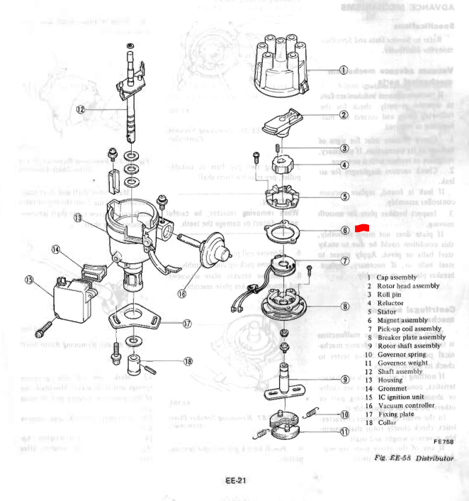

Zed Head Posted March 13, 2019 Share #557 Posted March 13, 2019 You didn't show that you confirmed that you had power to the coil's + terminal. With your previous smoke show maybe you damaged the coil's power circuit. The ZX "match boxes" do go bad. Link to comment Share on other sites More sharing options...

Zed Head Posted March 13, 2019 Share #561 Posted March 13, 2019 14 minutes ago, Home Built by Jeff said: The coil is new, so I didn't directly check it, but I did directly wire it to the battery. I will give it a better check tomorrow, but I am coming around to thinking the igniter is the issue. The module needs a good ground also. Power and ground. Plus the ZX distributors are known for breaking the magnetic ring under the stator. And they have bad bushings which let the sis pointed wheel contact the spikes on the outer ring. Lots of small things to check with a ZX distributor. Link to comment Share on other sites More sharing options...
