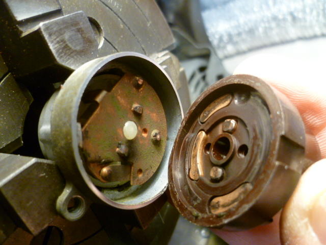

4 hours ago, Home Built by Jeff said:
I have done some more tracing of wires and it looks like there is a faulty ignition switch which is not sending out the power to the green/(white I think it is) which is why there is no power going in to my tacho.
Cool. Glad you got to the bottom of that and glad it was that simple.
I've been inside of multiple ignition switches to date, and I believe it is time for everyone to replace their switches because they all look like this inside:
I pulled the part out but I didn’t spilt it. Does the black section just clip in?
