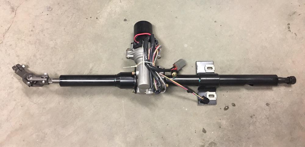

No power steering might be a game changer for Ms Jeff taking the keys.  It's not a problem when driving but turning from a full stop requires some upper body strength.   Combine that with a hot day and no A/C and you've got a free gym membership.  It always surprises people.  ??

The Silvermine Motors site. Complete kit for the car is available. I documented the initial install in my thread.
Edan [mention=27610]silverminemotors[/mention] will set you up
with all you need.
https://www.classiczcars.com/forums/topic/61463-silvermine-motors-electric-power-steering-system/
