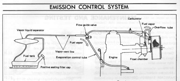

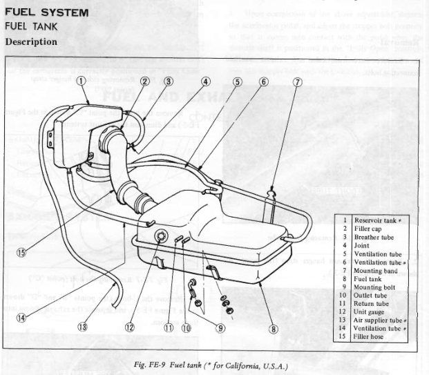

May 11, 20195 yr comment_575239 Nissan's drawings and explanations really aren't very good at explaining the purpose of the various parts. Edited May 11, 20195 yr by Zed Head Link to comment https://www.classiczcars.com/forums/topic/58542-home-built-z-full-video-build/?&page=55#findComment-575239 Share on other sites More sharing options...
May 11, 20195 yr Author comment_575270 On 5/11/2019 at 6:05 PM, Zed Head said: Nissan's drawings and explanations really aren't very good at explaining the purpose of the various parts. That is a handy diagram. One of my viewers pointed out that the way I have it, any overflow in the tank will go straight into the carbon canister. The easy fix is to just turn the T piece at the fuel filler neck, so that the breather line is facing up not down. Hopefully that will avoid any issues. Link to comment https://www.classiczcars.com/forums/topic/58542-home-built-z-full-video-build/?&page=55#findComment-575270 Share on other sites More sharing options...
