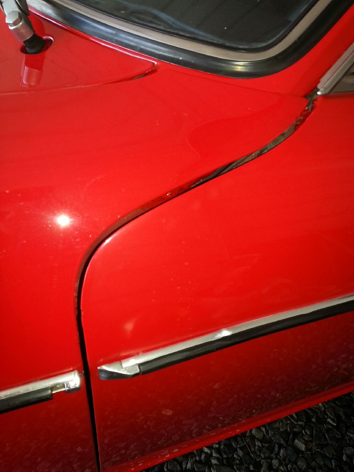

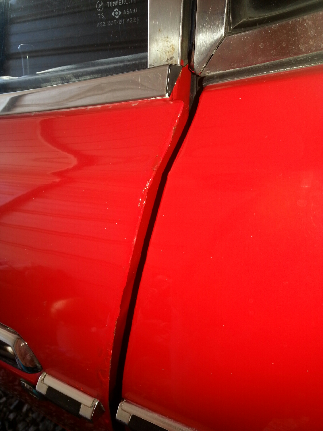

Ok... I made a mistake, or... it may have changed.  Key in door lock does move the inside latch post up and down.  But, it has no effect on the door opening or closing the door tightly.
Photos of the door with the 1/2 inch opening showing how far the door will go, showing wider gap at the top and thinner gap near the bottom..  Back edge and front edge.
No this is the drivers door, repair was on the right side.  Yes this started after the repair but I have been assured that they did nothing to the drivers door.  Curious eh?  Wonder if they leaned on the door, putting pressure to the mechanisms.

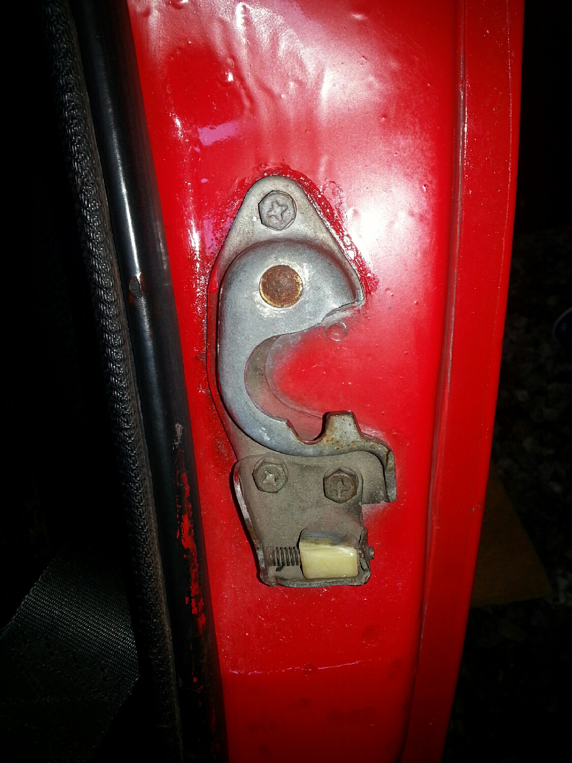

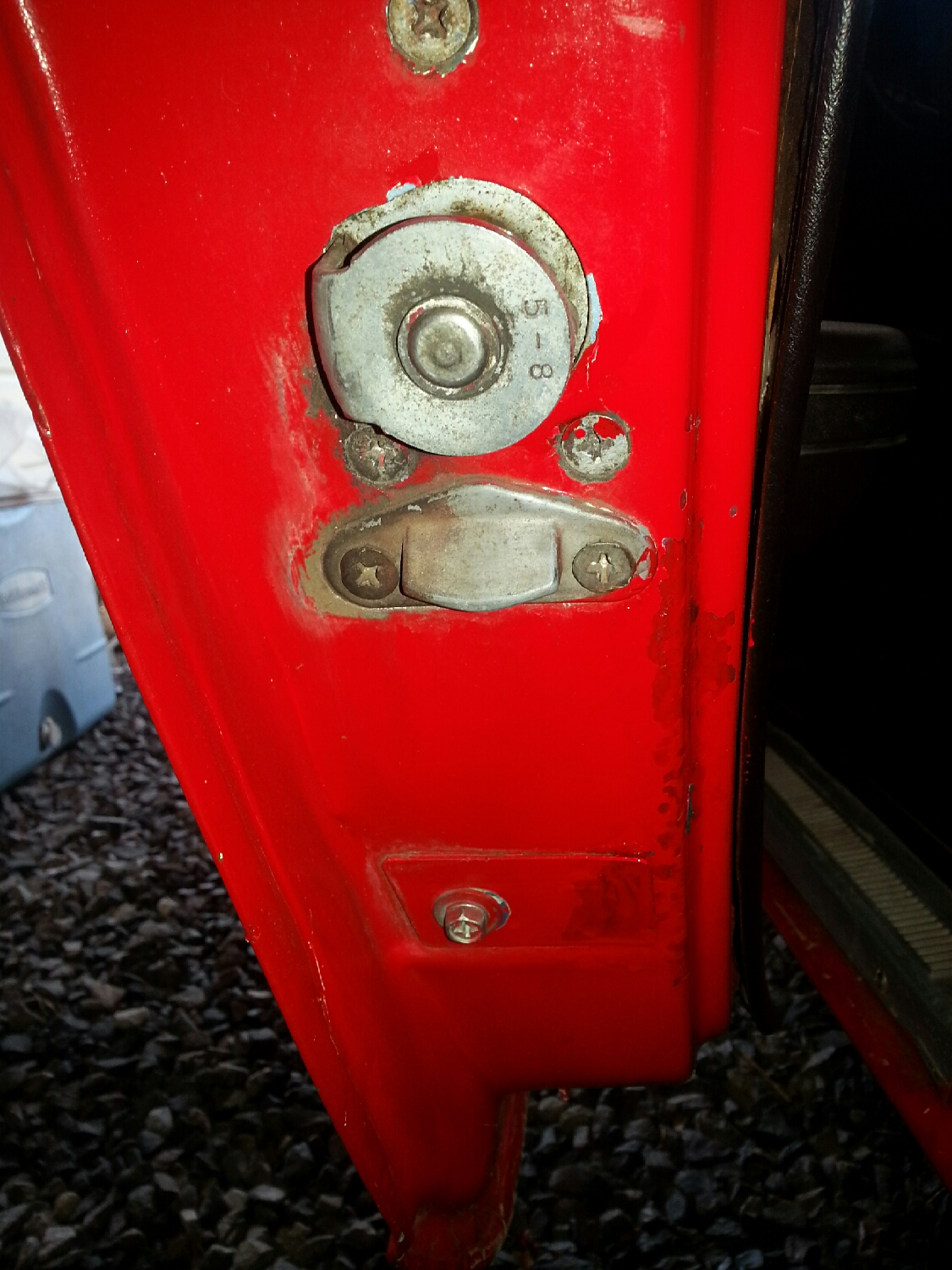

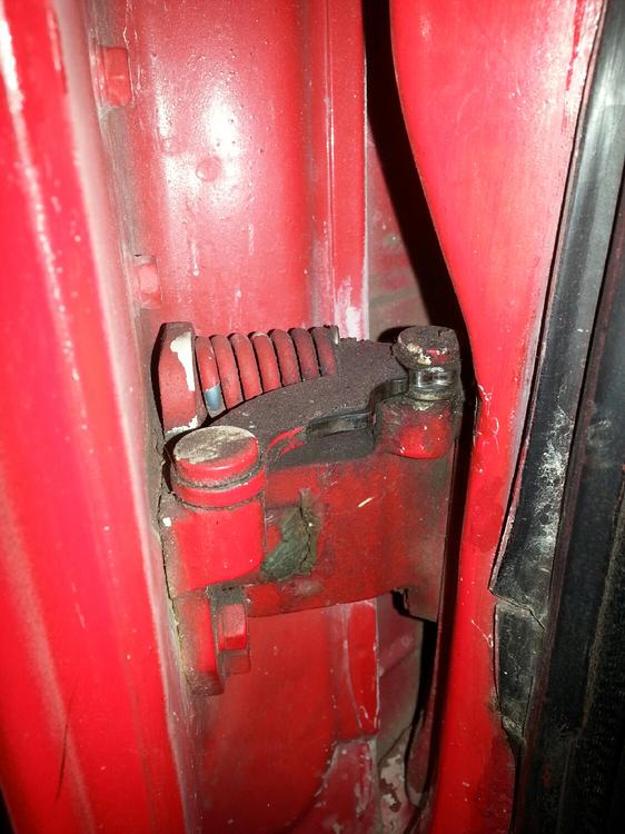

Then photos of the hinge and striking plates, before anyone asks for them.
