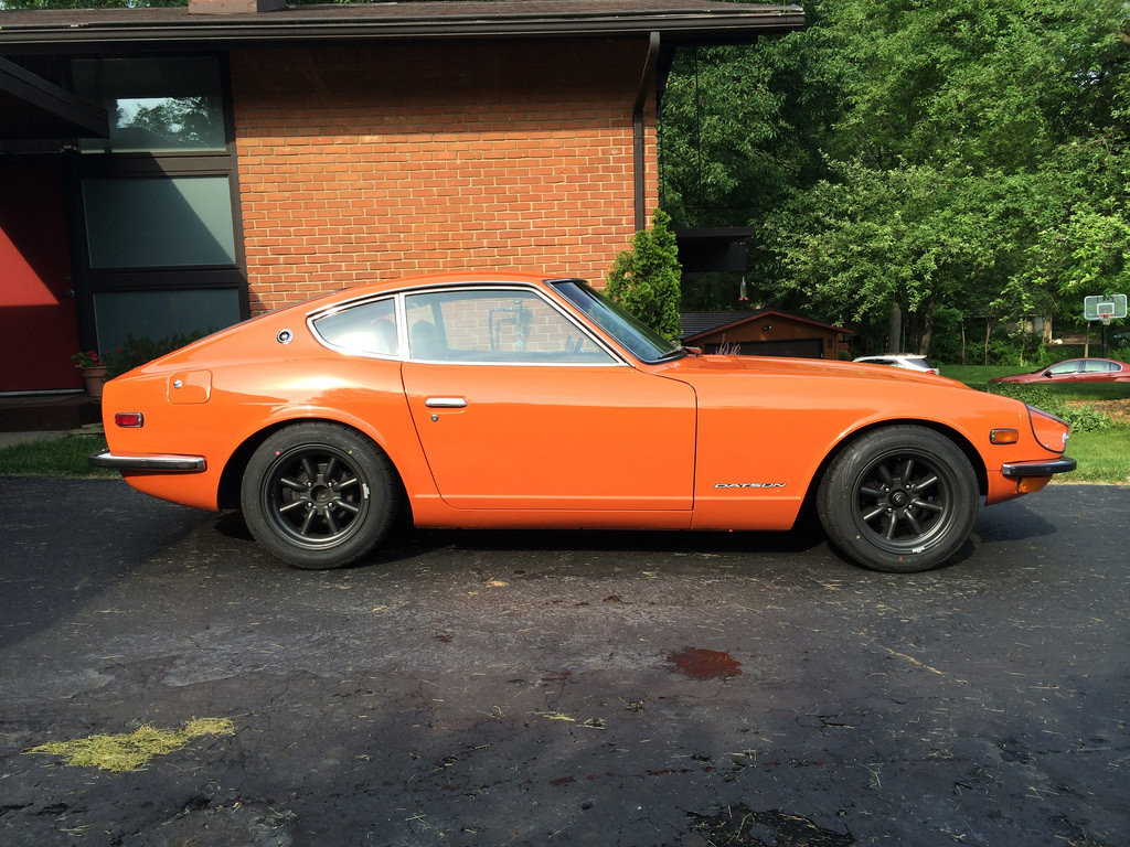

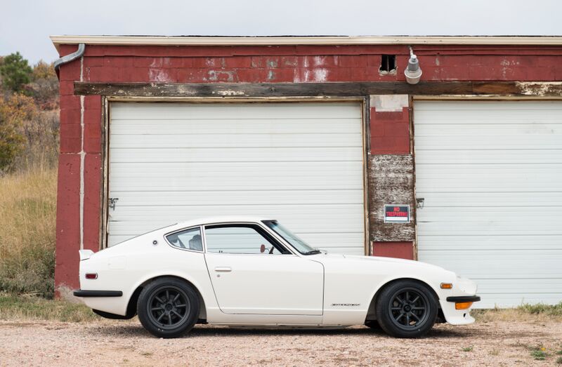

Duffy, I really like what you're doing with the car.  I have also seen and read your posts on Facebook, as well.  Did you mention the size of your new tires?  I would like to know what they are.
Thanks,
Gary
Sometimes I think I am doing the strangest build.  Cleaning up everything but the paint:) The paint is like a 6 out of 10.  Good from afar but far from good.  I just have been burned too many times in the painting process.  Too long, too much money etc.. I just want to enjoy and actually drive one of my cars.

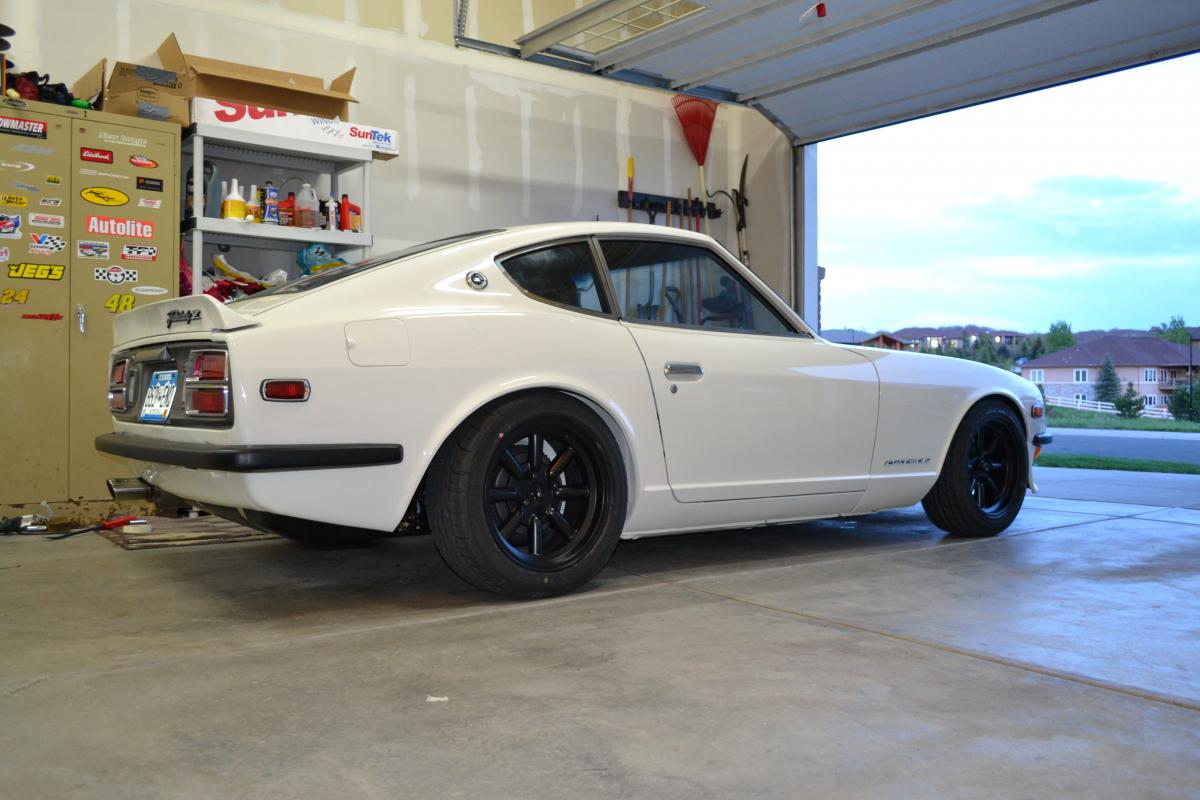

Tires are a 205/55-15 DUNLOP DIREZZA on ROTA WHEELS RKR 15X8 +0 4X114.3.  Here is my inspiration.
That looks like the perfect wheel/tire/suspension combo to me, thanks!
