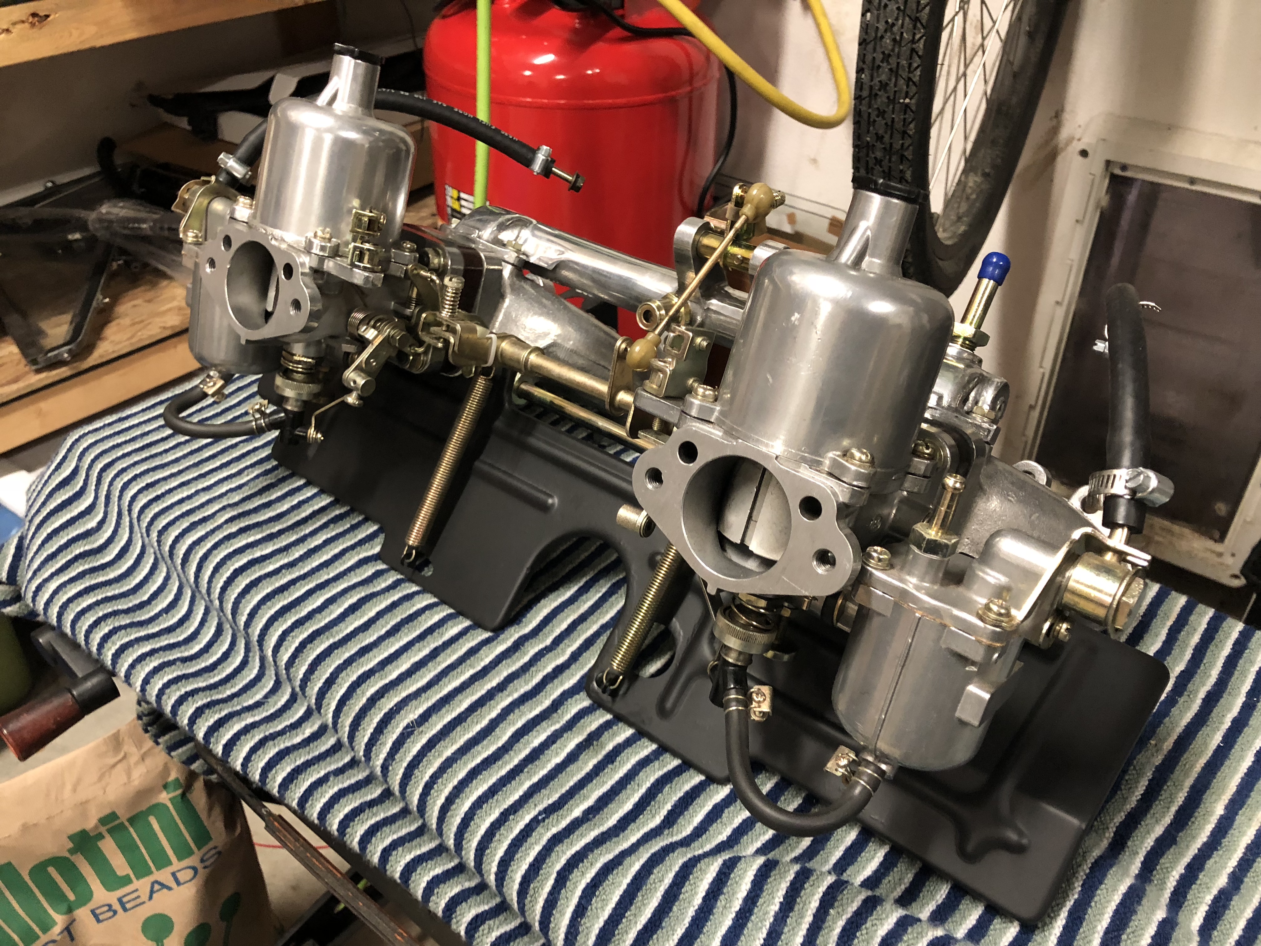

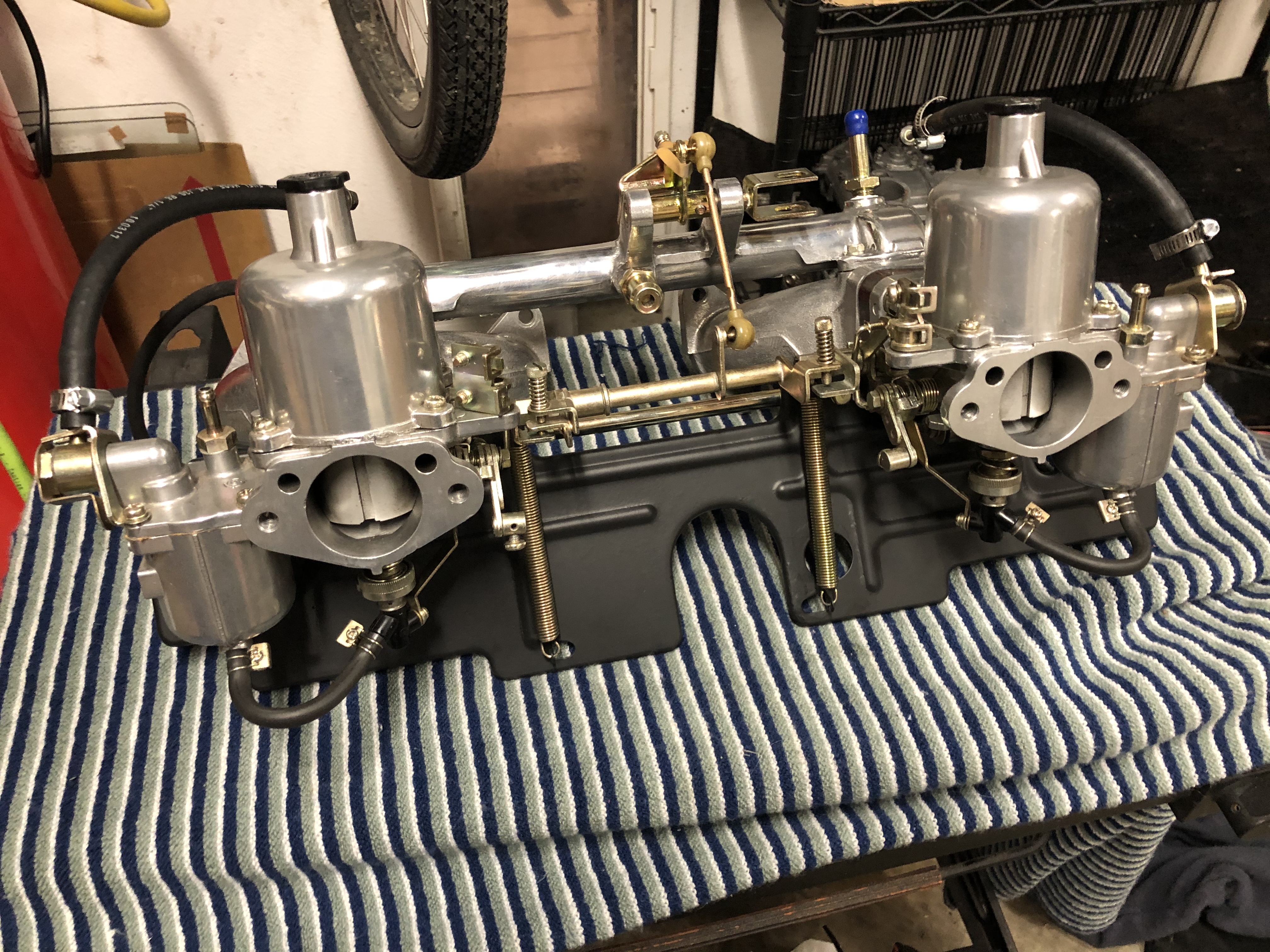

February 11, 20187 yr comment_542027 Those SUs do look beautiful. Link to comment https://www.classiczcars.com/forums/topic/58568-duffys-171-series-1-240z-build/?&page=15#findComment-542027 Share on other sites More sharing options...

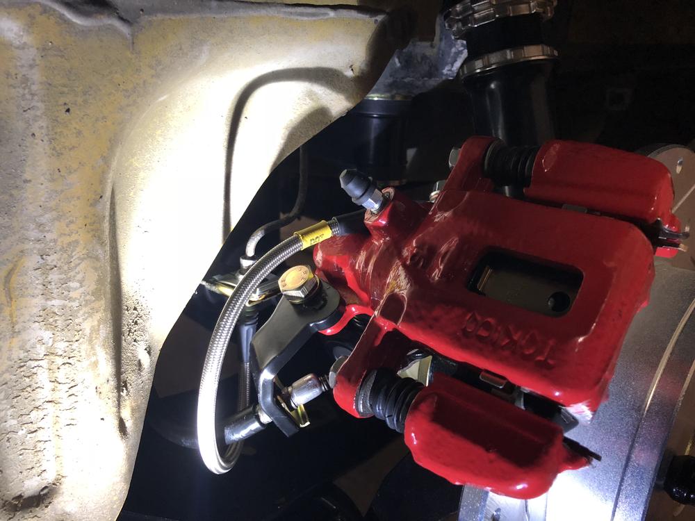

February 17, 20187 yr Author comment_542594 I got all brake lines attached and ready. Also got the ebrake working. Pretty productive sat morning. Now time to bleed them. Think I should put the line on the other side of the ebrake? It should travel together. Link to comment https://www.classiczcars.com/forums/topic/58568-duffys-171-series-1-240z-build/?&page=15#findComment-542594 Share on other sites More sharing options...
February 18, 20187 yr comment_542616 Hmmm... They should sorta travel together, but I think I'd put the brake hose on the other side. I just don't like the looks of the brake line looped around anything. Have you made up your mind on the carbs yet? Link to comment https://www.classiczcars.com/forums/topic/58568-duffys-171-series-1-240z-build/?&page=15#findComment-542616 Share on other sites More sharing options...
February 18, 20187 yr Author comment_542618 No on the carbs. I now own 7- Mikuni 44s and 1 narrow 40. Who knows:) I think this is the best I can get for the brake lines. Link to comment https://www.classiczcars.com/forums/topic/58568-duffys-171-series-1-240z-build/?&page=15#findComment-542618 Share on other sites More sharing options...
February 18, 20187 yr comment_542638 So you're saying you can't get that brake line installed unless you loop it under the parking brake cable? Can't you rotate the banjo connection to another position that would put the line in a better location? I know that many calipers have cast in features that help prevent the banjo from spinning while you turn the bolt... If your caliper has that feature, maybe you could cut one or more of the tabs off? Link to comment https://www.classiczcars.com/forums/topic/58568-duffys-171-series-1-240z-build/?&page=15#findComment-542638 Share on other sites More sharing options...
February 18, 20187 yr Author comment_542645 1 hour ago, Captain Obvious said: So you're saying you can't get that brake line installed unless you loop it under the parking brake cable? Can't you rotate the banjo connection to another position that would put the line in a better location? I know that many calipers have cast in features that help prevent the banjo from spinning while you turn the bolt... If your caliper has that feature, maybe you could cut one or more of the tabs off? Looks like silvermine runs the cable over the ebrake. I just thought it would have been too tight of a turn in the line. Link to comment https://www.classiczcars.com/forums/topic/58568-duffys-171-series-1-240z-build/?&page=15#findComment-542645 Share on other sites More sharing options...

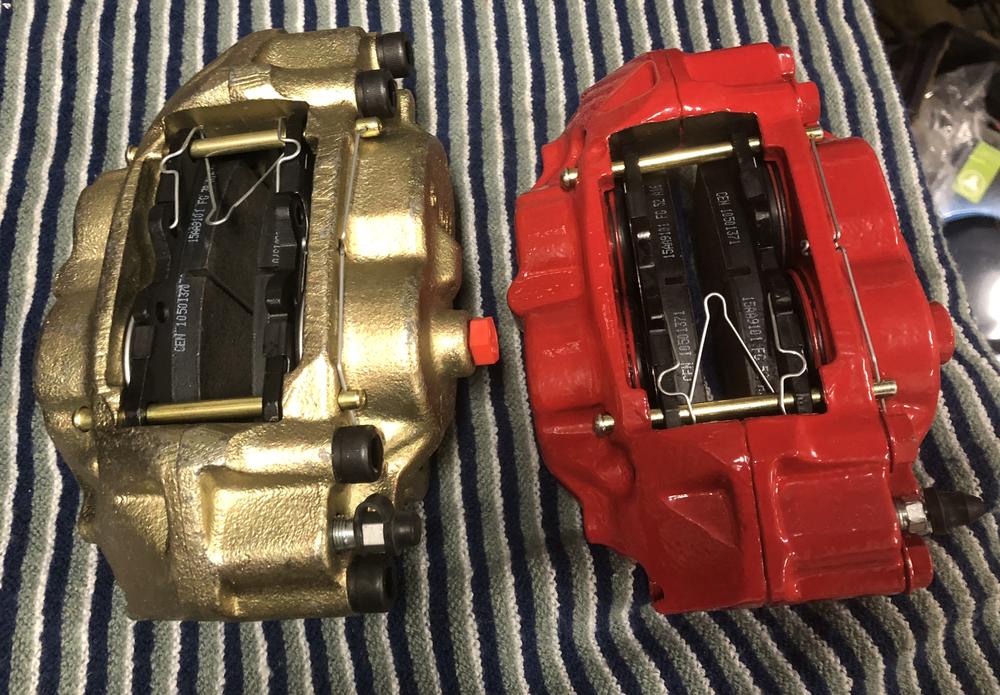

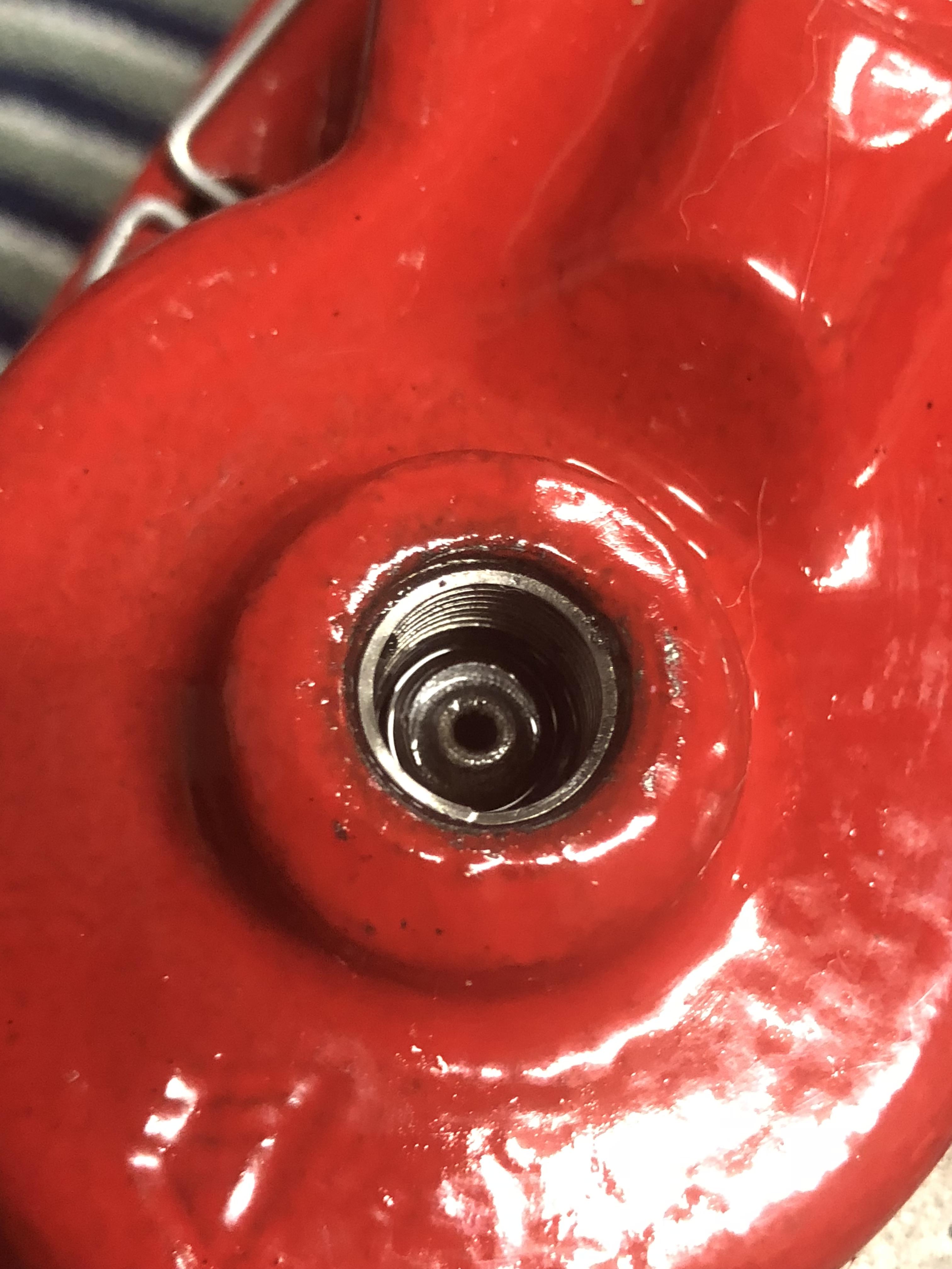

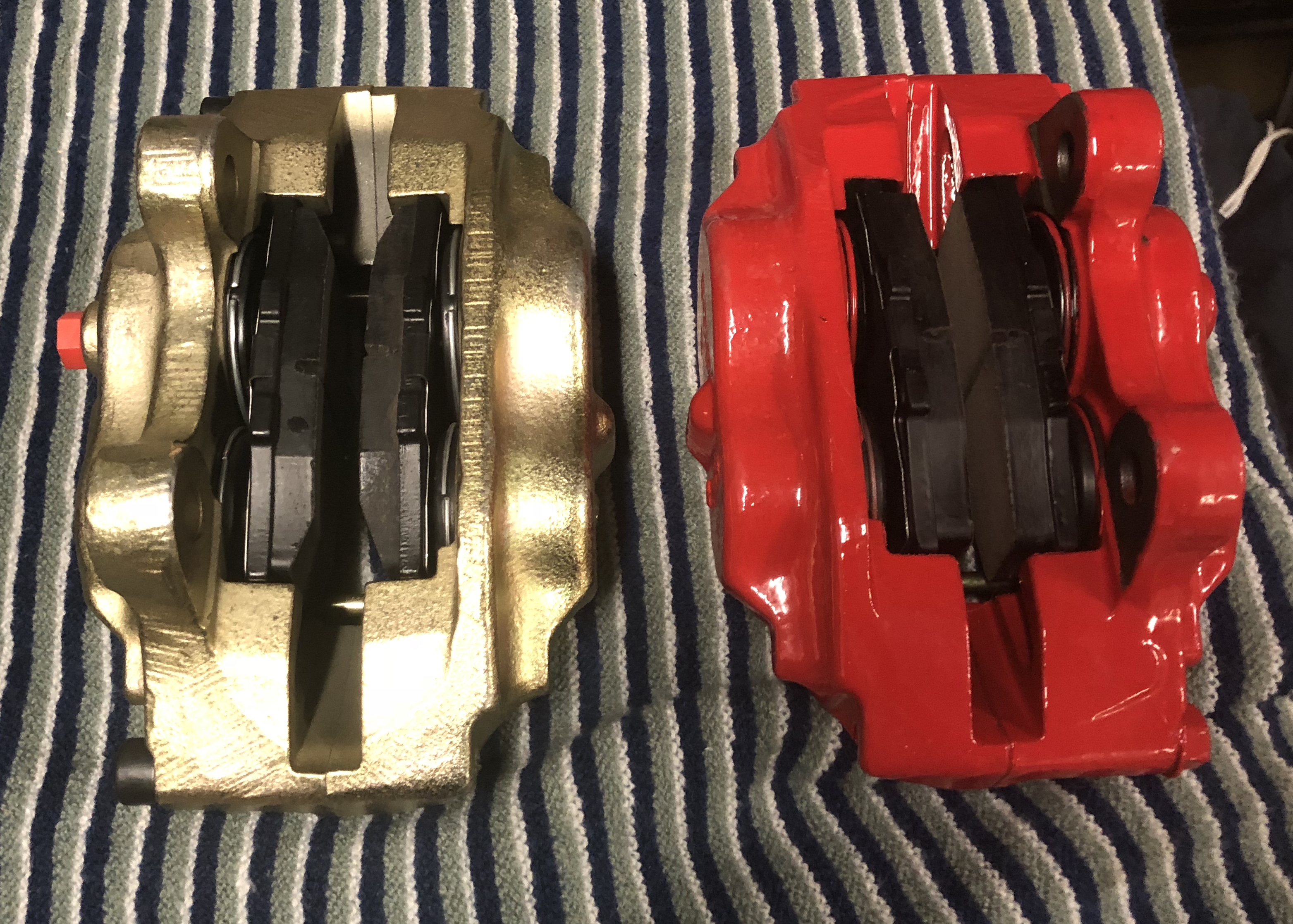

February 27, 20187 yr Author comment_543382 So I bought used calipers and had them rebuilt and powder coated professionally. Well my right front caliper wouldn't stop leaking, so I decided to take it apart. Turns out they had used a helicoil to repair some threads without telling me. It wasn't seated correctly, which caused the brake line to leak. The company claims it to be a normal repair, but what else did they half repair or fix? I honestly I don't want anything repaired or half repaired in my brakes system. So I searched for another powder coated version or zinc. Which I found, http://www.centricparts.com/products/calipers posi quiet loaded centrics calipers.They are gorgeous and pretty affordable. Summit and rockauto carry these. Any centric brake caliper with 142 as the starting 3 digits is this repaired this way. The toyota S12+8 non wide versions are 142.44011 and 142.44012. I am very happy with the quality. But one did come damaged:( I ordered the maxima rears but they are back ordered. Here is the info, basically as brand new as they could be. Posi Quiet Loaded CalipersPosi Quiet loaded calipers are a full line of original equipment replacement brake calipers providing unmatched quality and value. These loaded calipers feature application specific Posi Quiet brake pads already installed. When installing Posi Quiet loaded calipers, technicians can be assured that they are getting top quality products that have been engineered to meet or exceed the function of the original part. Each component is specifically designed for each application and the attention to detail throughout the manufacturing and testing process ensures each caliper will perform to the exacting standards of today’s vehicles. Each Posi Quiet caliper is finished in the same way as the original from the factory; Posi Quiet calipers feature a Zinc Dichromate finish, or O.E. colored powder coating depending on the application. This feature ensures that the caliper will look as good as it works throughout its lifetime. Ask for Posi Quiet 142 series replacement brake calipers.Posi Quiet Friction Every Posi Quiet loaded caliper comes complete with application specific Posi Quiet brake friction. For more information on Posi Quiet brake pads go here. All new pistons Every Posi Quiet brake caliper piston phenolic or steel is replaced to guarantee proper performance throughout the lifetime of the caliper. New Hardware Posi Quiet calipers have all new hardware installed. All guide bolts, pins, through bolts and seals are replaced guaranteeing the caliper will function correctly. New Boots and Seals Posi Quiet calipers come complete with all new dust seals, O-rings and boots. Less Noise Posi Quiet calipers utilize the new Quiet Clips™ style abutment clips. These quiet clips ensure proper pad fitment and reduced vibration related noise under braking. To learn more about the Centric Parts caliper rebuilding process click here. Centric Caliper Core Return Guidelines Link to comment https://www.classiczcars.com/forums/topic/58568-duffys-171-series-1-240z-build/?&page=15#findComment-543382 Share on other sites More sharing options...
February 28, 20187 yr comment_543410 Oh how I hate rebuilt components that I did not do myself. That helicoil should not be in the sealing path for brake fluid. The seal should be made at the beveled surface inside. Assuming, of course, that the helicoil is installed straight and square to the seal, and is actually the correct metric thread for the application..... No guarantees on any of that! I hate rebuilds!! Link to comment https://www.classiczcars.com/forums/topic/58568-duffys-171-series-1-240z-build/?&page=15#findComment-543410 Share on other sites More sharing options...
