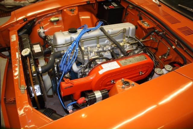

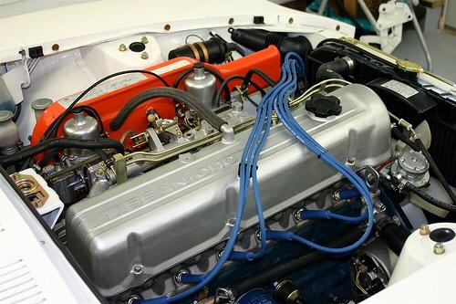

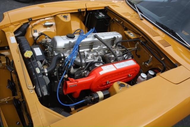

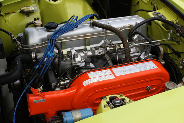

June 1, 20186 yr Author comment_550207 So working on my air cleaner. I want to powder coat it. I ordered every single orange I could find from prismatic powders. Like 30 shades. Hemi orange is almost correct or flag orange. Both are super close. Hemi matches the older paint, then flag is closer on the inside areas, I will go with flag. Link to comment https://www.classiczcars.com/forums/topic/58568-duffys-171-series-1-240z-build/?&page=19#findComment-550207 Share on other sites More sharing options...
June 2, 20186 yr comment_550257 It's easy to get yourself into a tailspin with a handful of paint samples. I think either of those would work out just fine. I suspect the original paints have all darkened a little over time, so picking the slightly lighter of the two is probably perfect. Link to comment https://www.classiczcars.com/forums/topic/58568-duffys-171-series-1-240z-build/?&page=19#findComment-550257 Share on other sites More sharing options...
June 2, 20186 yr Author comment_550275 On 6/2/2018 at 1:46 AM, Captain Obvious said: It's easy to get yourself into a tailspin with a handful of paint samples. I think either of those would work out just fine. I suspect the original paints have all darkened a little over time, so picking the slightly lighter of the two is probably perfect. I believe I will pick flag orange. It matches other inside areas better. Link to comment https://www.classiczcars.com/forums/topic/58568-duffys-171-series-1-240z-build/?&page=19#findComment-550275 Share on other sites More sharing options...
