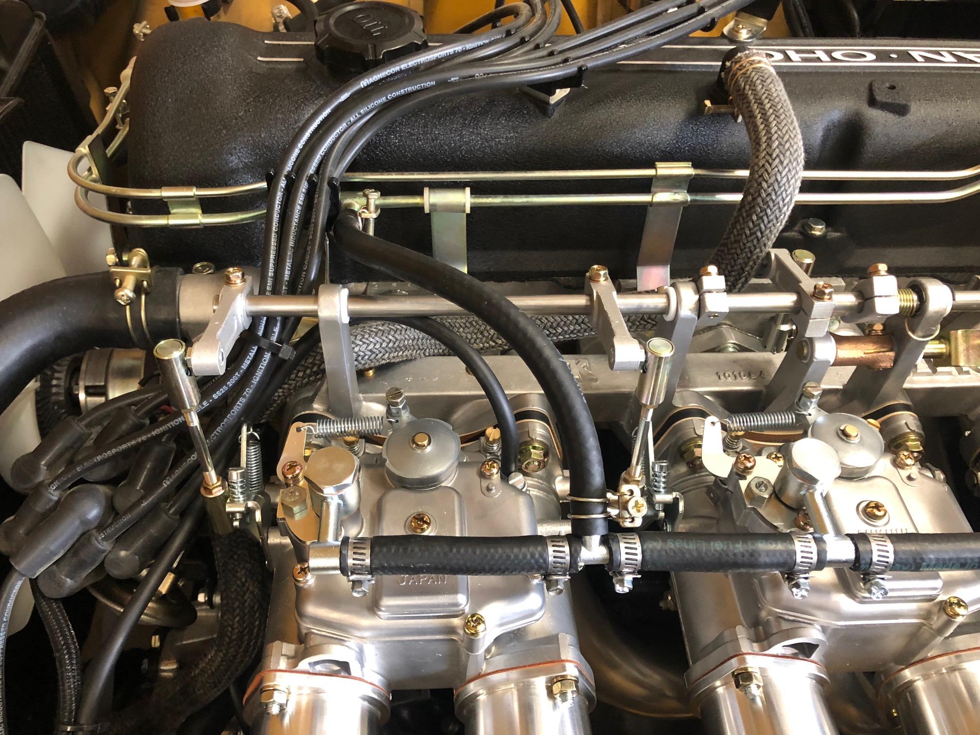

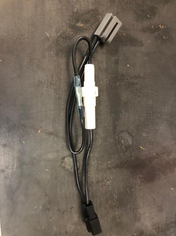

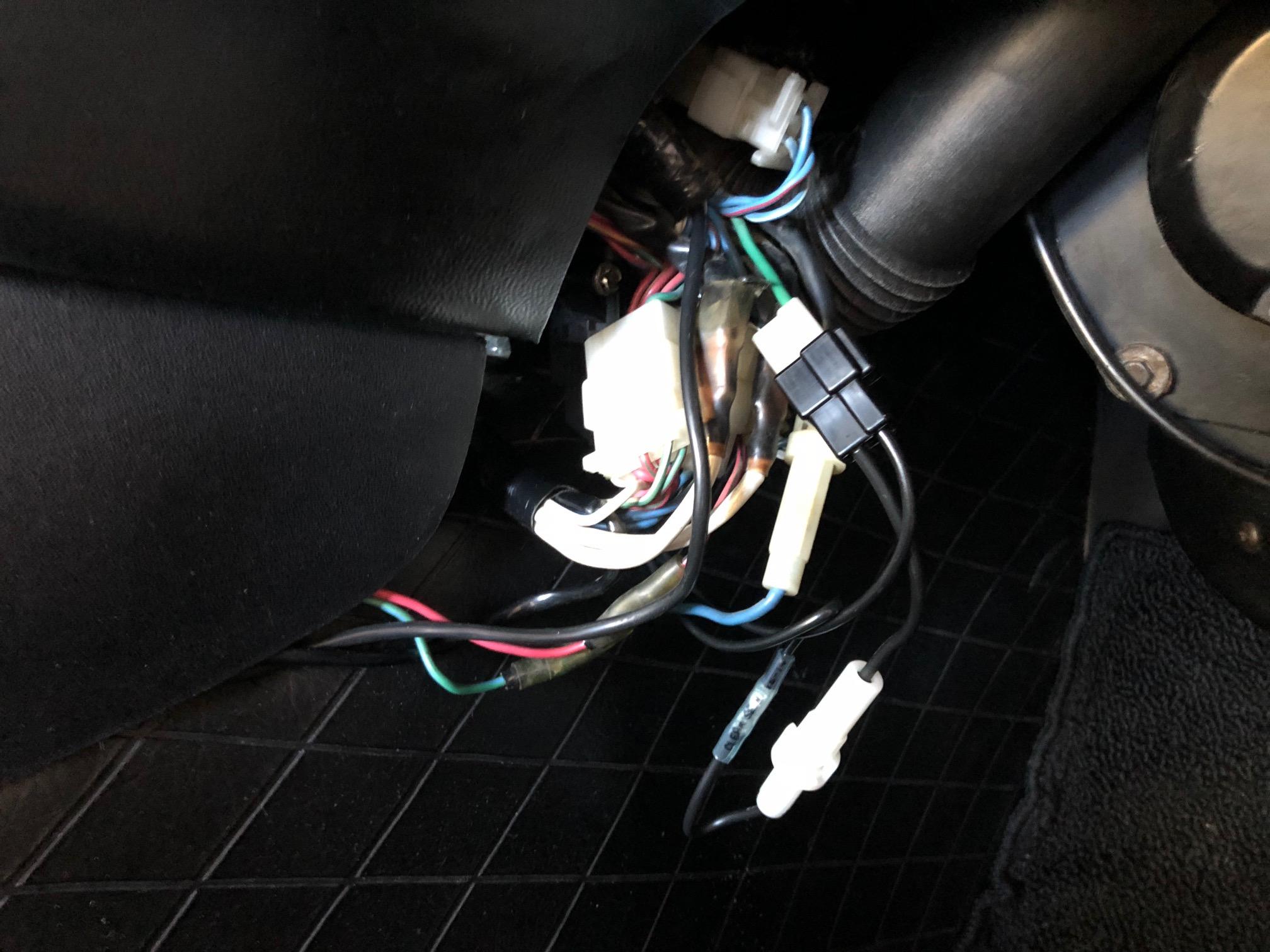

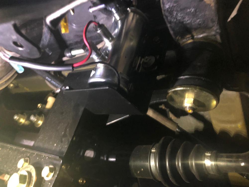

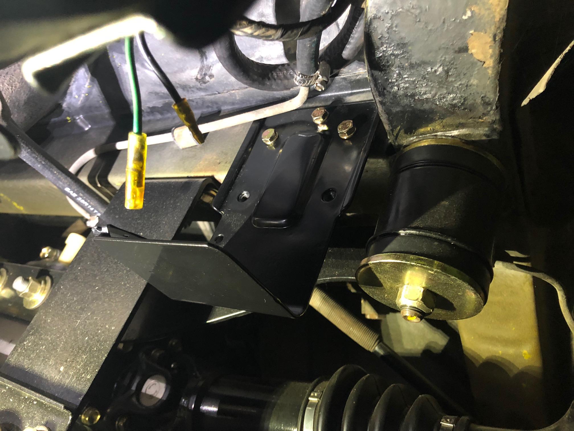

October 15, 20186 yr Author comment_559642 So my 3 best mikuni 44's didn't have the same patina, these had been rebuilt by a legend. I made the decision to try and take them 95% apart myself, vapor blast and put them back together. Honestly most of the process made perfect sense. I am pretty detail oriented, so I just took my time and took lots of pictures. The throttle shafts and pins are the hardest part. So far the only thing I think i screwed up is one of the butterfly valves isn't seated 100%. I am going to take each carb off and double check no light passes by when closed. I am getting a high idle, which I believe is from that. I installed a nismo fuel pump with my 73 bracket, bolted right in. Hoses were easy to install. I installed a inertia switch/ rollover switch for the electric fuel pump (factory used a oil pressure switch). Since I have it attached to the stock spot on the ignition. Also a 14amp fuse. Looks factory. I wanted to use the stock fuel rail, I like the way it looks. I also re- zinc'd a bunch of smalls for the intake and carbs. So far I am very happy with how they sound. Now time to sell my z therapy carbs. Don't judge the fuel fitting. The correct one is on order. Link to comment https://www.classiczcars.com/forums/topic/58568-duffys-171-series-1-240z-build/?&page=23#findComment-559642 Share on other sites More sharing options...

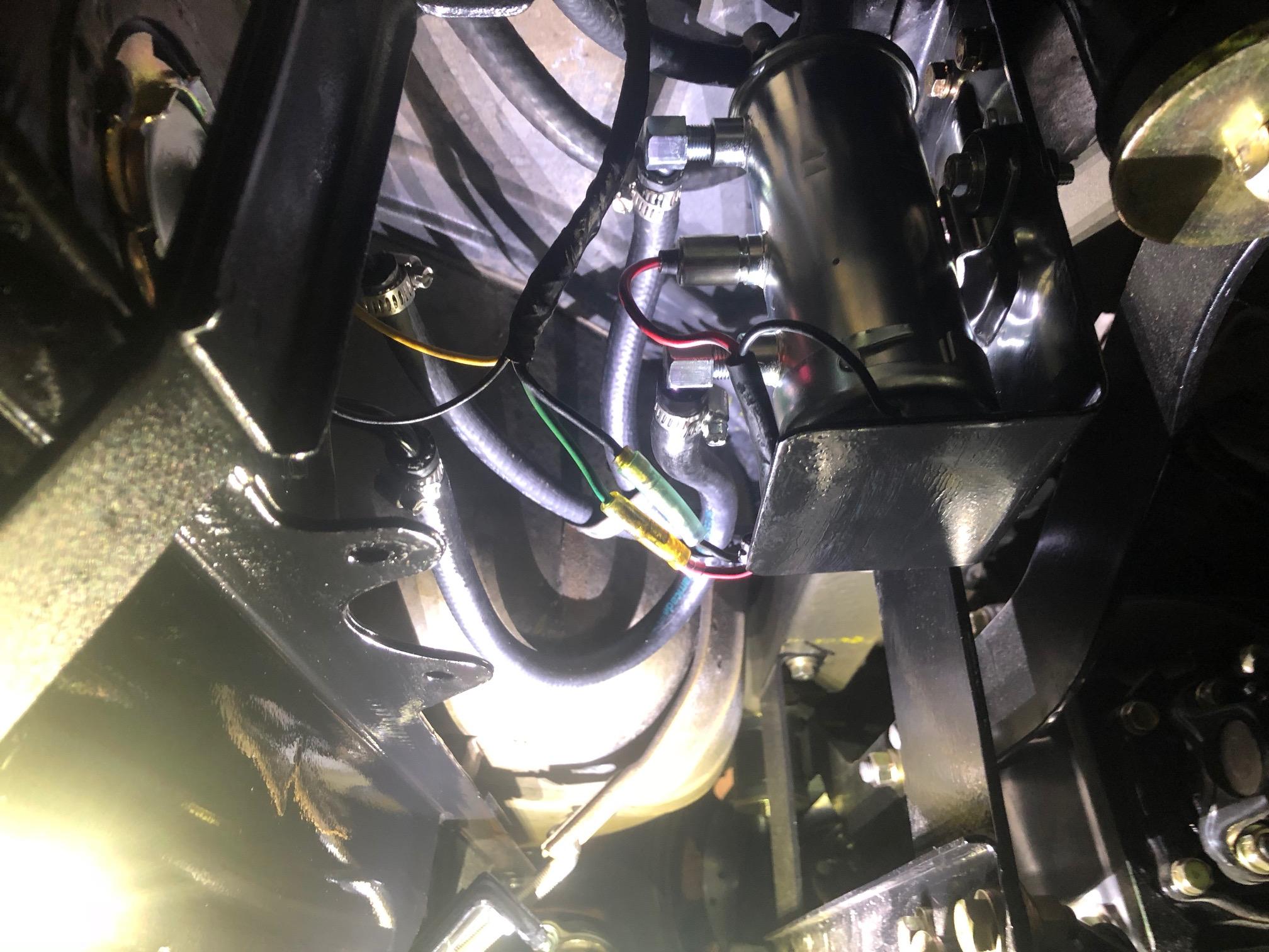

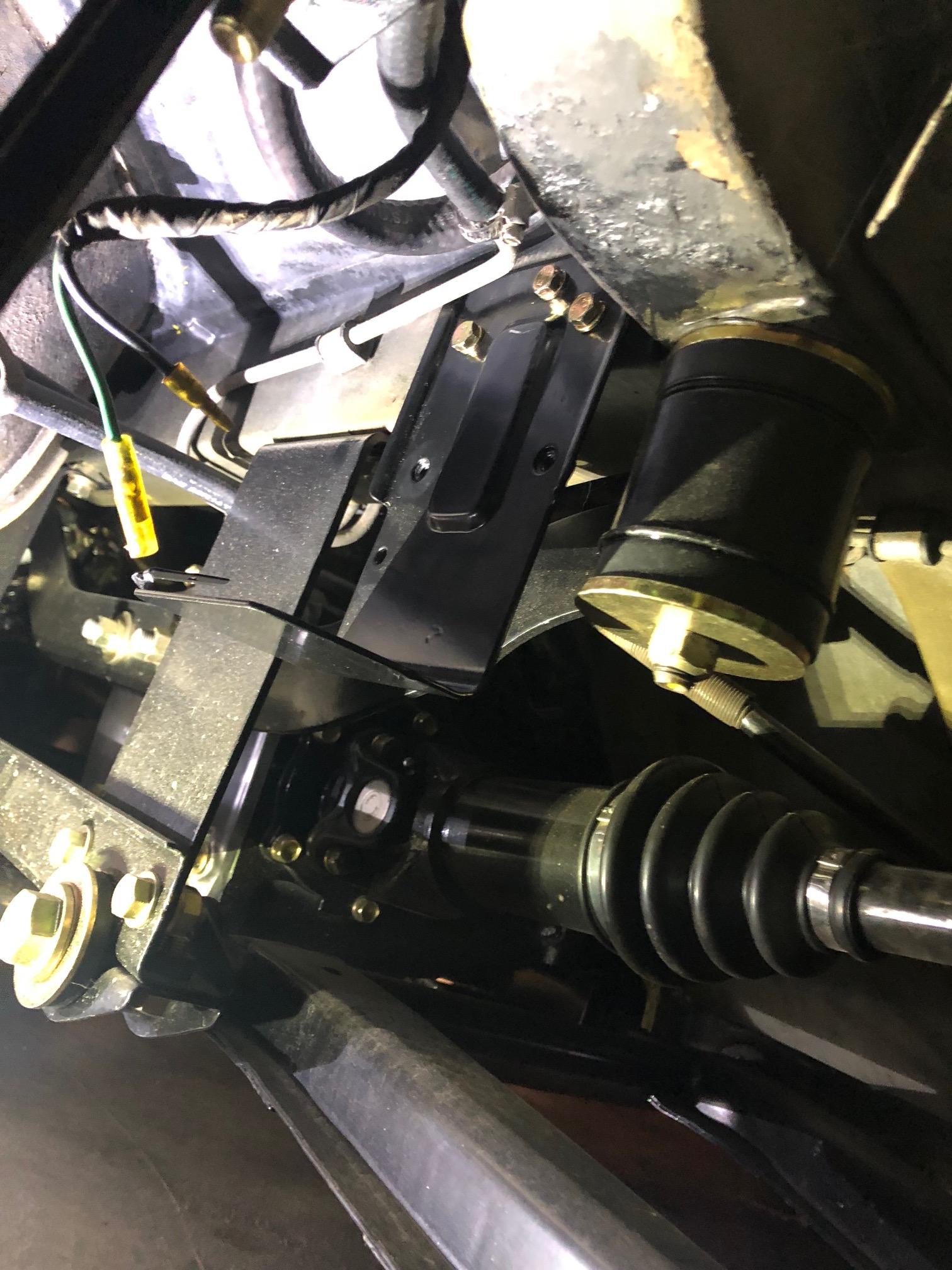

October 15, 20186 yr Author comment_559644 Some pictures of the fuel pump install. Link to comment https://www.classiczcars.com/forums/topic/58568-duffys-171-series-1-240z-build/?&page=23#findComment-559644 Share on other sites More sharing options...
October 16, 20186 yr comment_559676 On 10/15/2018 at 4:11 PM, duffymahoney said: Some pictures of the fuel pump install. Nice and tidy. I wish everyone did work like that! Great job. Link to comment https://www.classiczcars.com/forums/topic/58568-duffys-171-series-1-240z-build/?&page=23#findComment-559676 Share on other sites More sharing options...
October 16, 20186 yr Author comment_559694 On 10/16/2018 at 2:12 AM, lordkarma88 said: Nice and tidy. I wish everyone did work like that! Great job. Thank you. I am trying to make whatever i do as nice as it can be done. By a hobbyist .The interia switch was actually the first hole I have drilled in my z. It worried me a little. I screwed up the the butterfly’s a little on the Mikuni’s. They are now all set pretty perfect. I can see a sliver of light when closed. The heat shield I bought doesn’t fit. Weirdly the carbs stay nice and cool. My header is ceramic coated. Maybe that’s enough? Also the header design keeps the pipes pretty far away from the carbs. Thoughts? Anyone? Next goals. Next is taking the starter apart and zinc, vapor blast and paint it. Re zinc the horns, they have over spray on them. Pull oil pan, powder coat and re zinc all the bolts Link to comment https://www.classiczcars.com/forums/topic/58568-duffys-171-series-1-240z-build/?&page=23#findComment-559694 Share on other sites More sharing options...

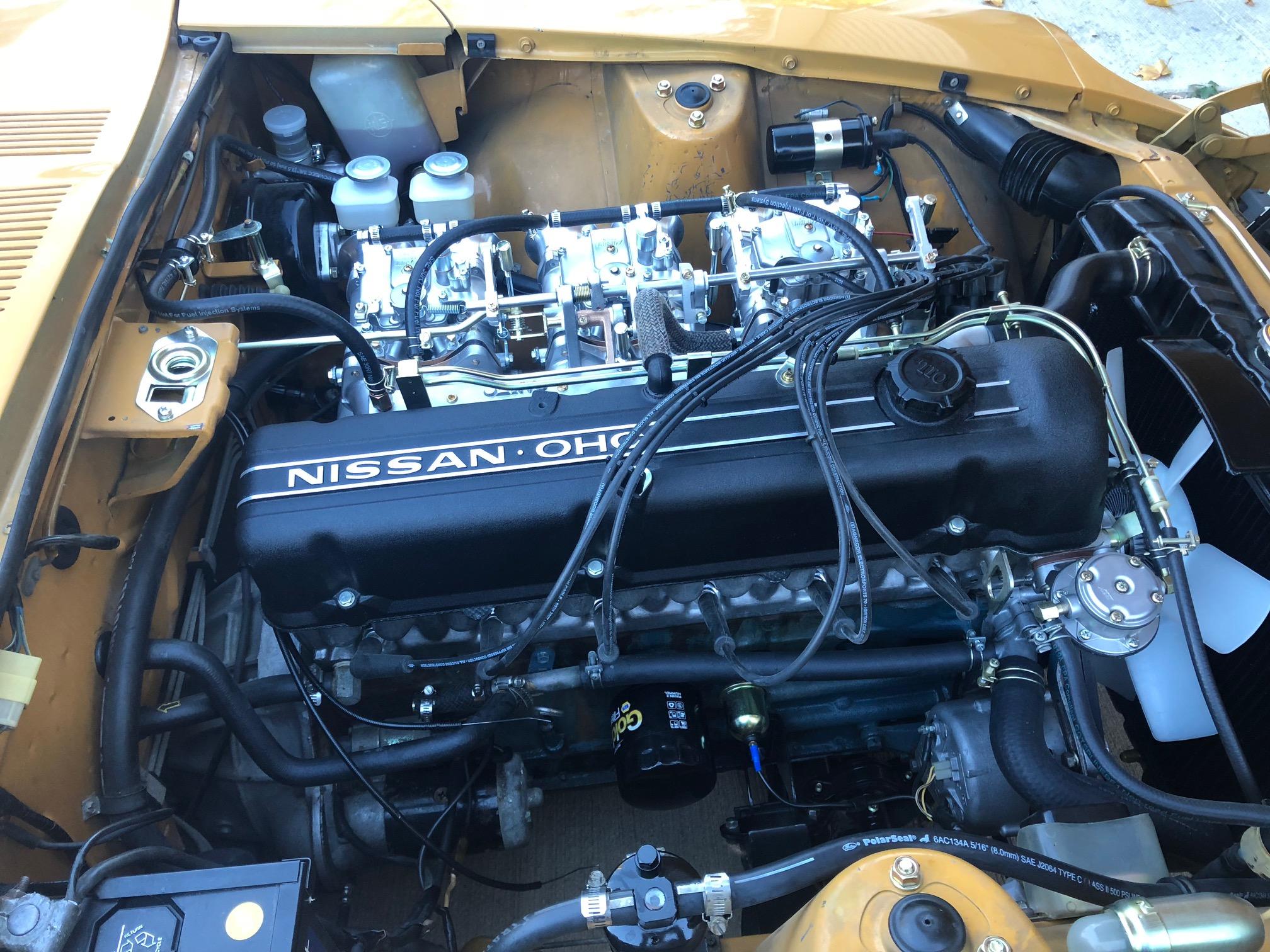

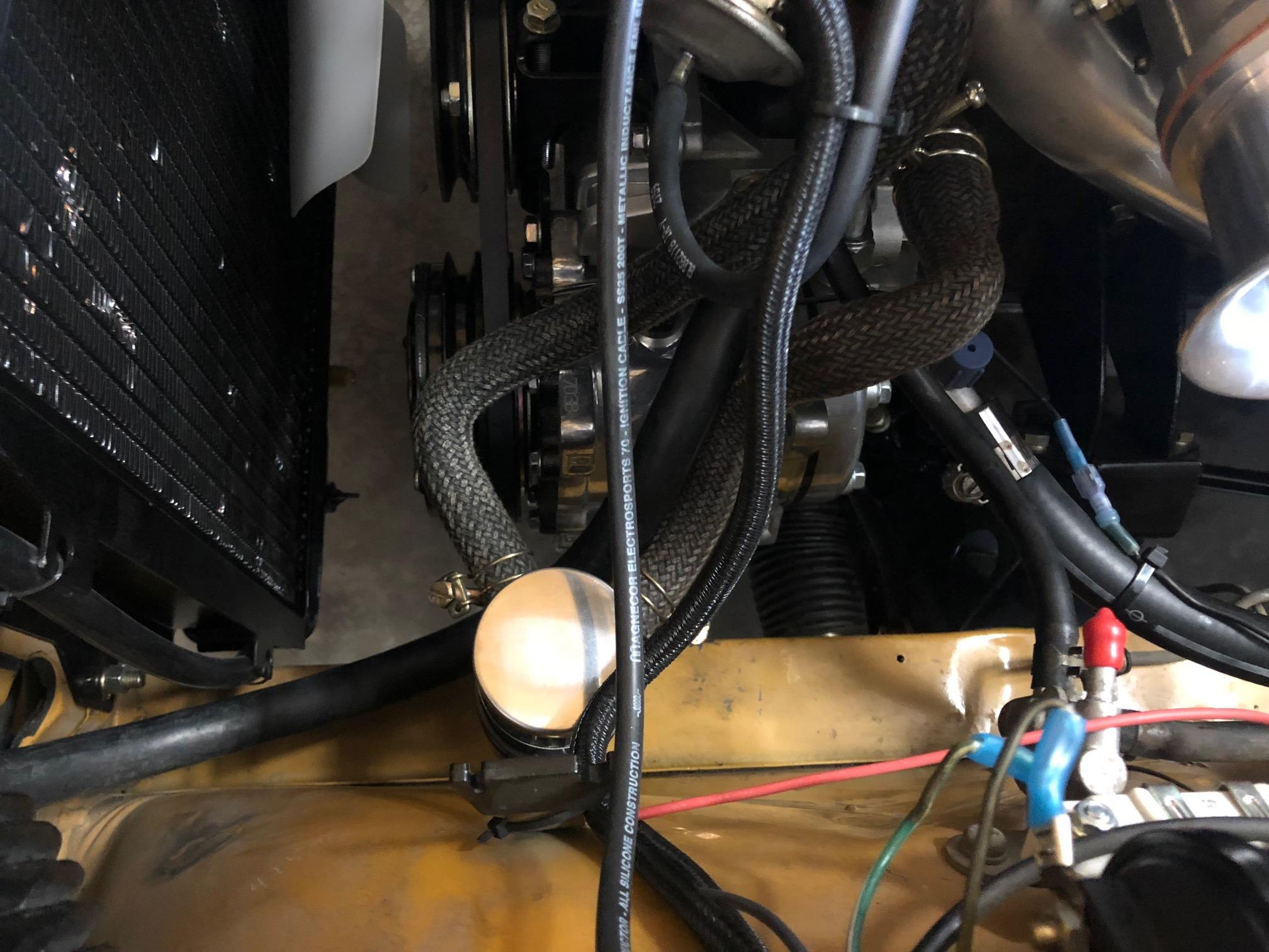

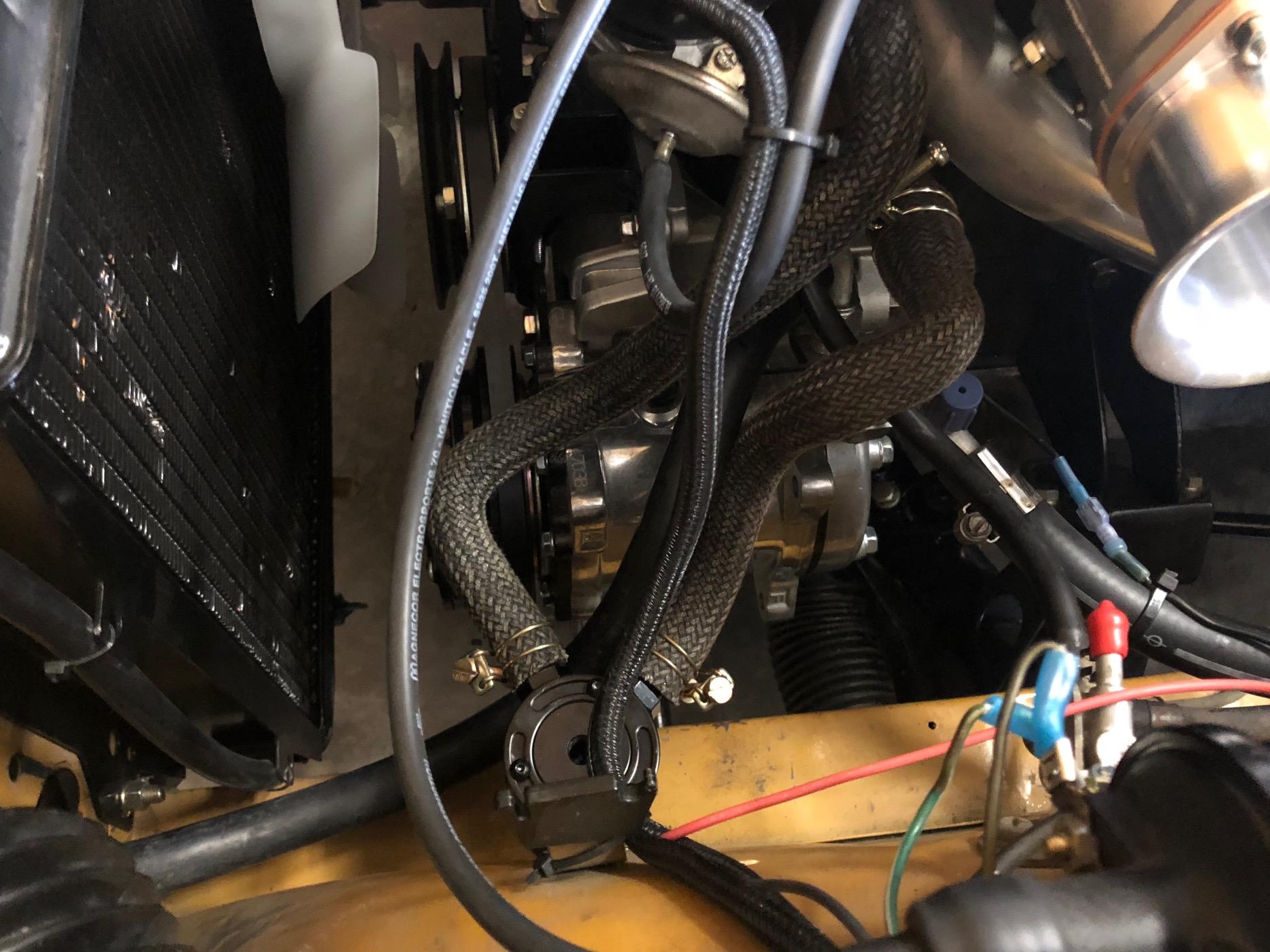

October 25, 20186 yr Author comment_560321 Oil catch can is done (some ebay smaller aluminum one). Time to drive it! The goal was stock looking as possible, also no holes drilled. This is two pvc hoses spliced together with a 5/8 brass union, the pre- bends worked awesome and looks like I meant it to happen. Catch can has a nice little drain on the bottom. Link to comment https://www.classiczcars.com/forums/topic/58568-duffys-171-series-1-240z-build/?&page=23#findComment-560321 Share on other sites More sharing options...

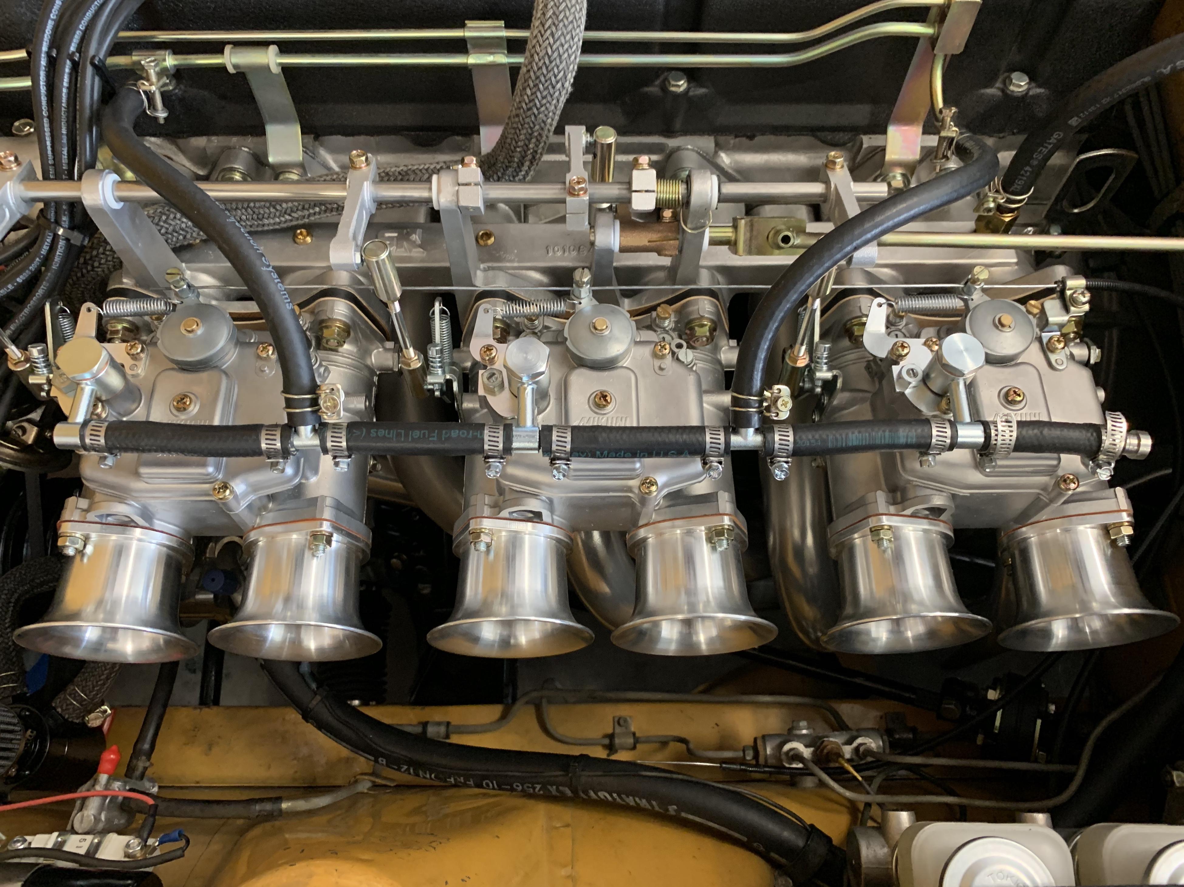

November 6, 20186 yr Author comment_561091 Starter circuit is done and working. I used the stock su cables. I think next is more zinc’d parts and rebuilding the horns Link to comment https://www.classiczcars.com/forums/topic/58568-duffys-171-series-1-240z-build/?&page=23#findComment-561091 Share on other sites More sharing options...
November 6, 20186 yr comment_561092 Looks great and I hate to nit pick but those tractor hose clamps scare me. Too many of mine ate through the fuel lines on my setup... Link to comment https://www.classiczcars.com/forums/topic/58568-duffys-171-series-1-240z-build/?&page=23#findComment-561092 Share on other sites More sharing options...
November 6, 20186 yr Author comment_561093 On 11/6/2018 at 11:51 PM, wheee! said: Looks great and I hate to nit pick but those tractor hose clamps scare me. Too many of mine ate through the fuel lines on my setup... I have stock style wire ones. I am waiting on a L fuel fitting from Japan. Then I swill swap them all out. Link to comment https://www.classiczcars.com/forums/topic/58568-duffys-171-series-1-240z-build/?&page=23#findComment-561093 Share on other sites More sharing options...
