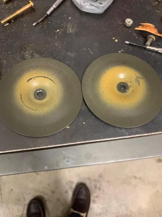

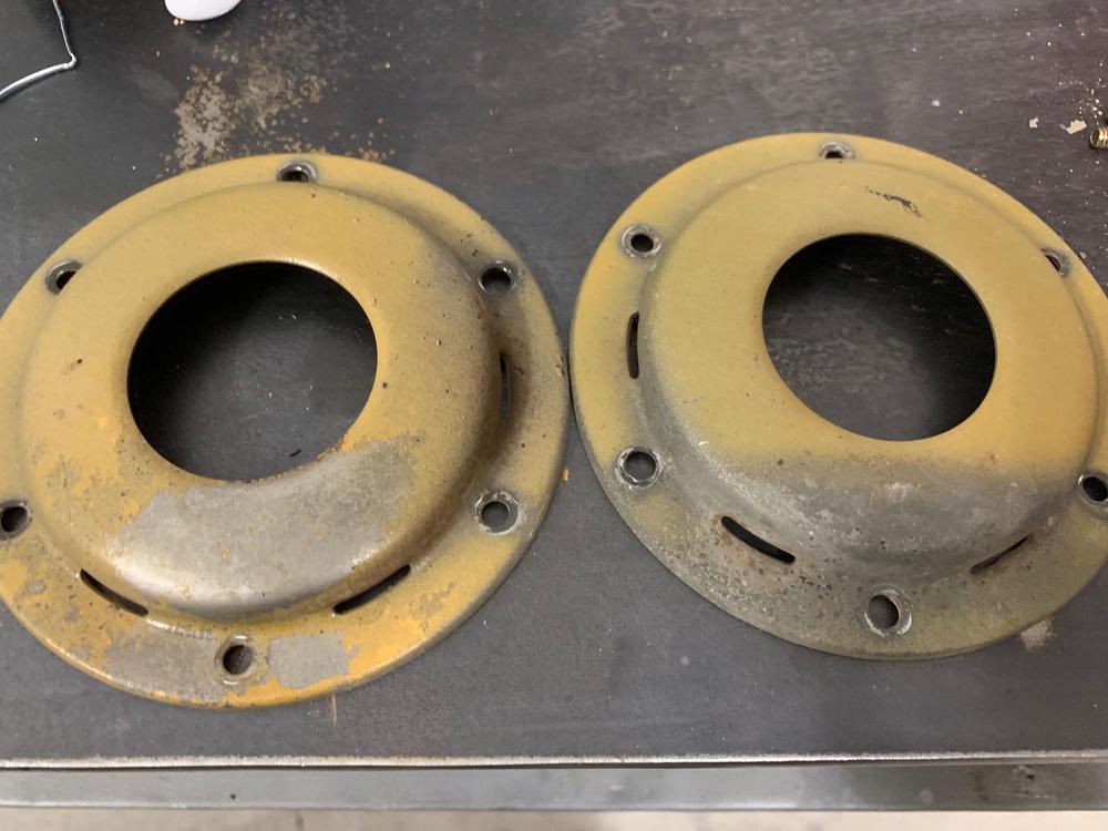

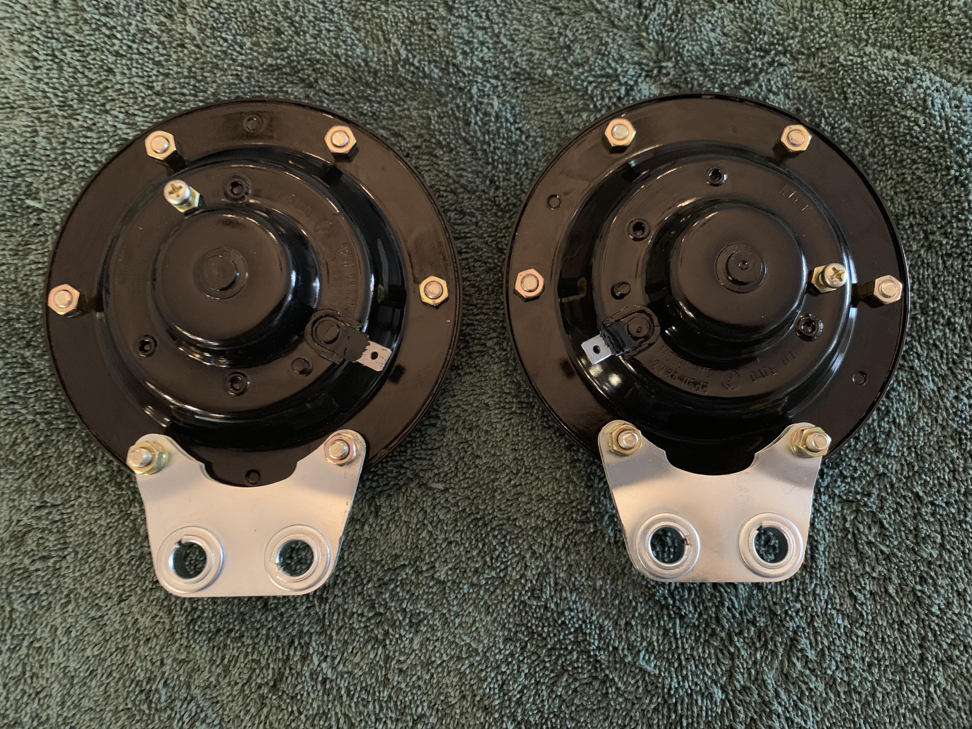

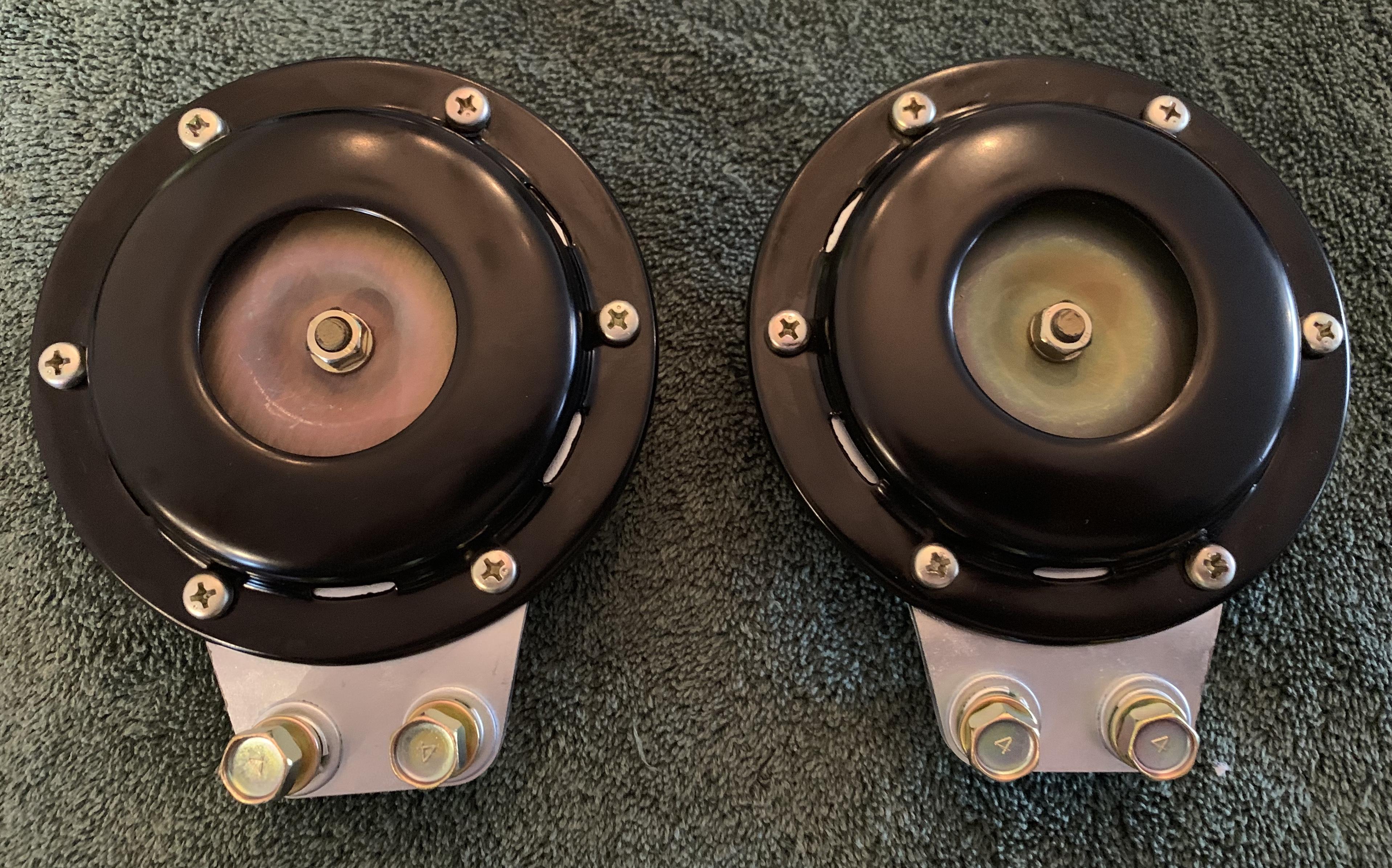

December 10, 20186 yr Author comment_563455 So I believe the horns came with green zinc on them. Or maybe part had no coating? I decided on powder coating the fronts in black, the backside of them has some deep pitting and I would rather not zinc them. Plus I think gold zinc in the front will look goofy. Then inner parts you see gold zinc. Then back with all the electronics will just need to be media blasted and a nice 2 part paint. I can't figure out a good way to take it apart. Link to comment https://www.classiczcars.com/forums/topic/58568-duffys-171-series-1-240z-build/?&page=25#findComment-563455 Share on other sites More sharing options...

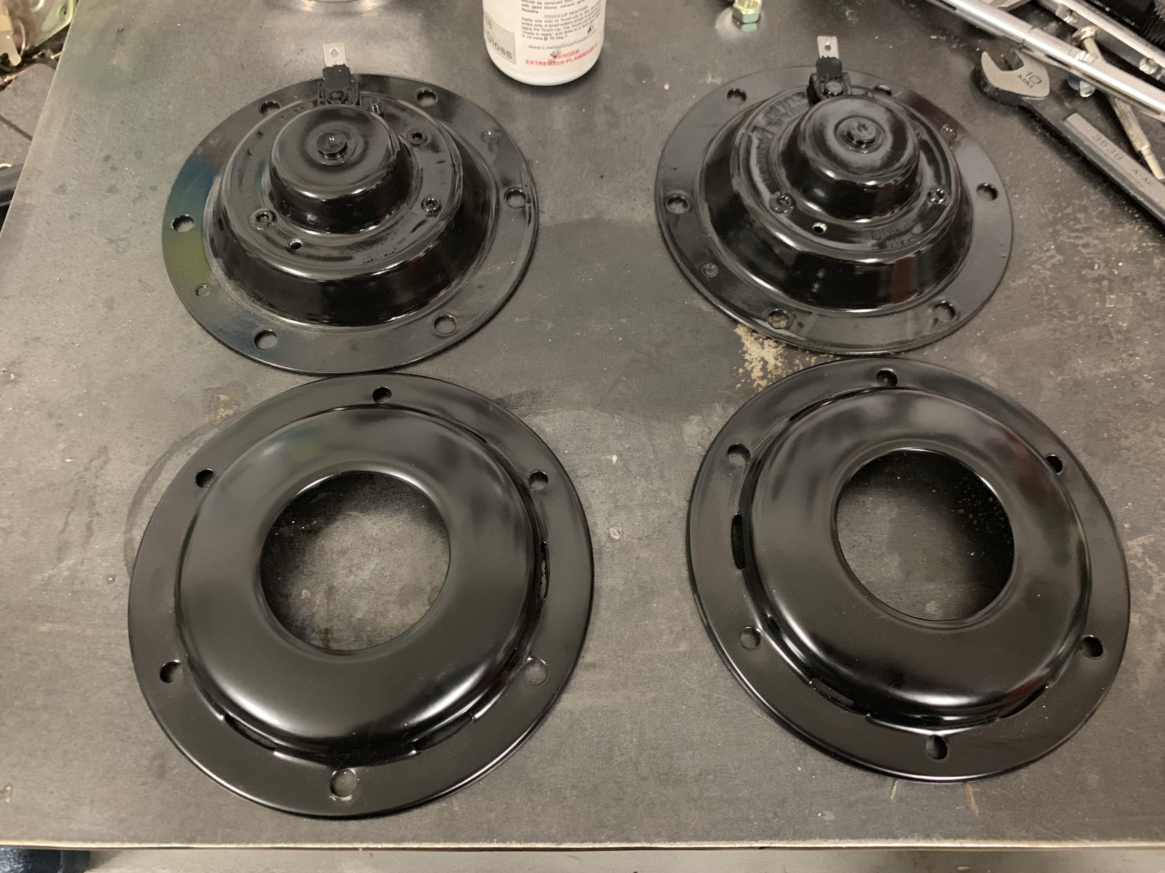

December 12, 20186 yr Author comment_563606 I spent an hour taping off the horns to protect the electronics. I then media blasted them. Then took them to a auto paint shop. The rears are single stage 2 part black paint. The grills are powder coated bk06. Just like the rest of my z. Edited December 12, 20186 yr by duffymahoney Link to comment https://www.classiczcars.com/forums/topic/58568-duffys-171-series-1-240z-build/?&page=25#findComment-563606 Share on other sites More sharing options...
December 12, 20186 yr comment_563618 @duffymahoney, what are you using for the paper gaskets between the 2 parts of the horn? Link to comment https://www.classiczcars.com/forums/topic/58568-duffys-171-series-1-240z-build/?&page=25#findComment-563618 Share on other sites More sharing options...
December 12, 20186 yr Author comment_563619 4 minutes ago, grannyknot said: @duffymahoney, what are you using for the paper gaskets between the 2 parts of the horn? Good question. Either laser cut paper or gasket maker. I honestly don’t know yet. Link to comment https://www.classiczcars.com/forums/topic/58568-duffys-171-series-1-240z-build/?&page=25#findComment-563619 Share on other sites More sharing options...

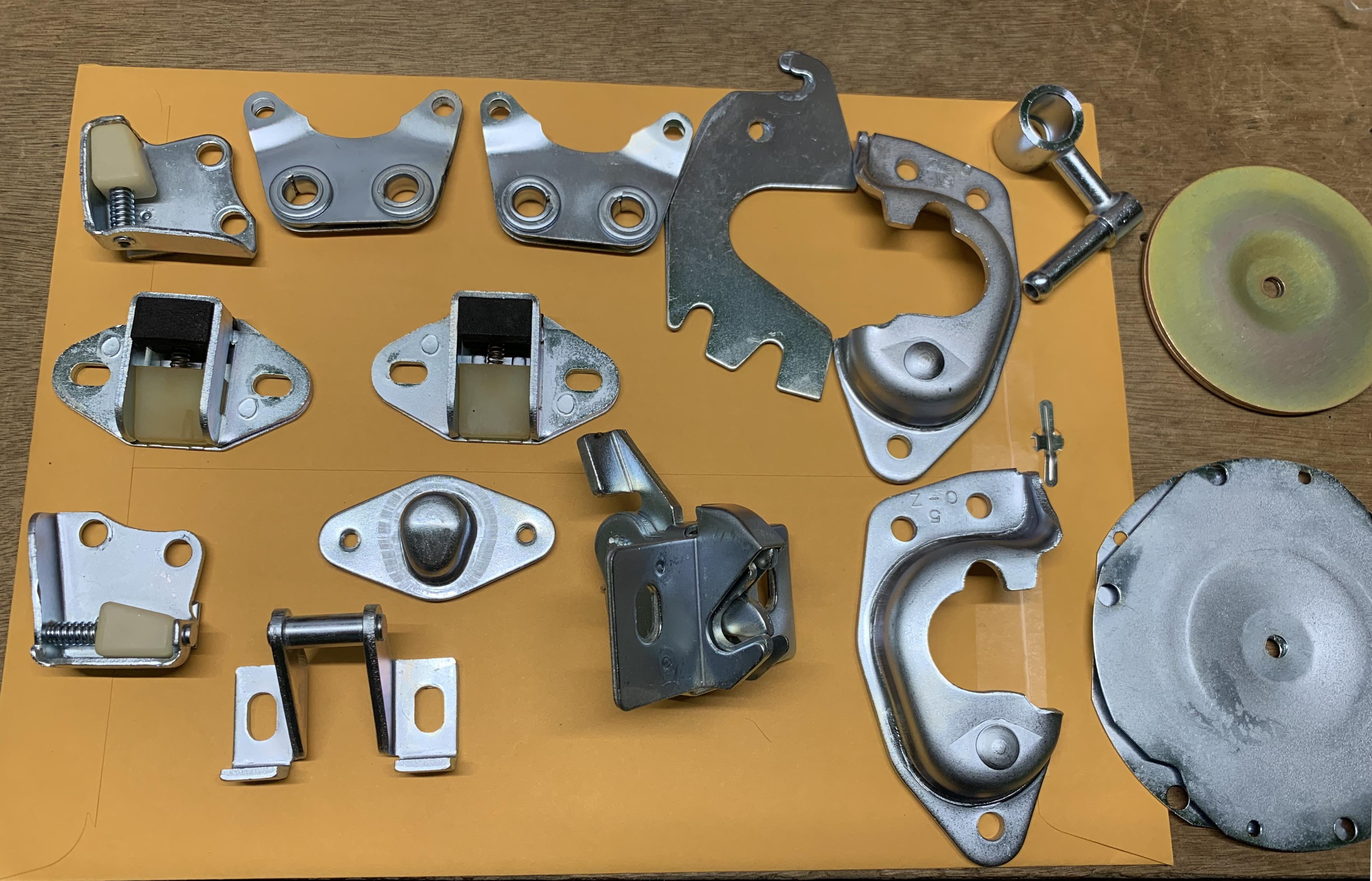

December 28, 20186 yr Author comment_564700 Door, hatch and horn parts are back from zinc. Also tons of nuts and screws. Zinc day is always the best. Link to comment https://www.classiczcars.com/forums/topic/58568-duffys-171-series-1-240z-build/?&page=25#findComment-564700 Share on other sites More sharing options...

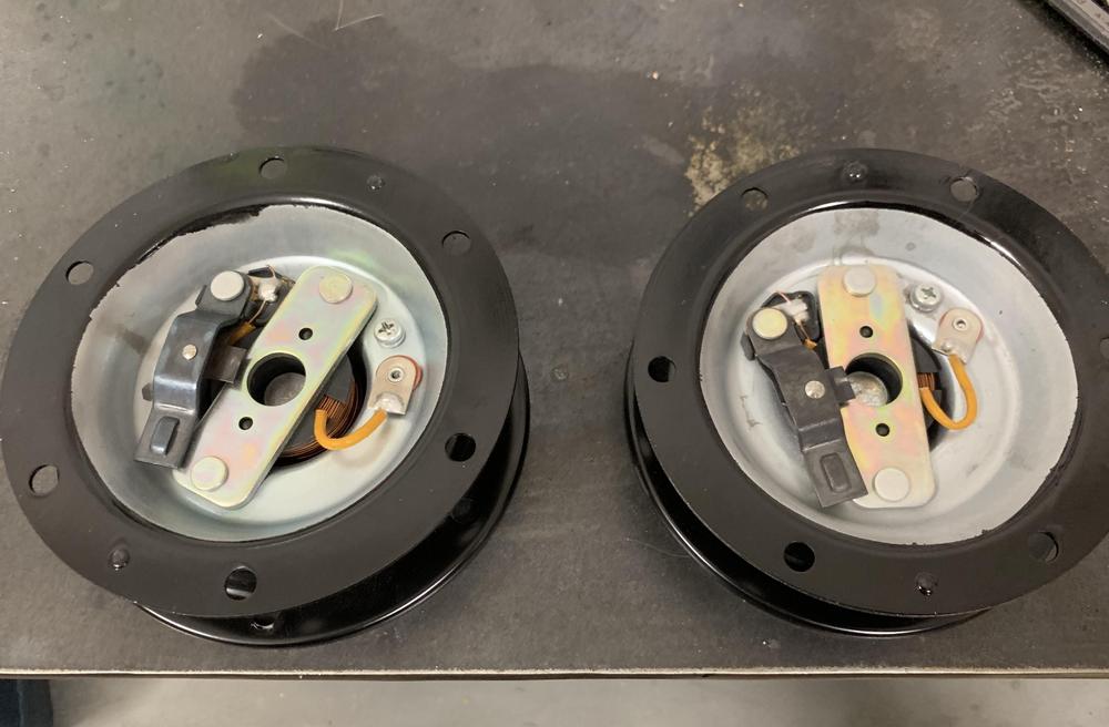

January 12, 20196 yr Author comment_565819 Horns are rebuilt. I used gasket maker instead of the paper seal. Now time to remove all the original tape from the front wiring harness and redo it. Link to comment https://www.classiczcars.com/forums/topic/58568-duffys-171-series-1-240z-build/?&page=25#findComment-565819 Share on other sites More sharing options...

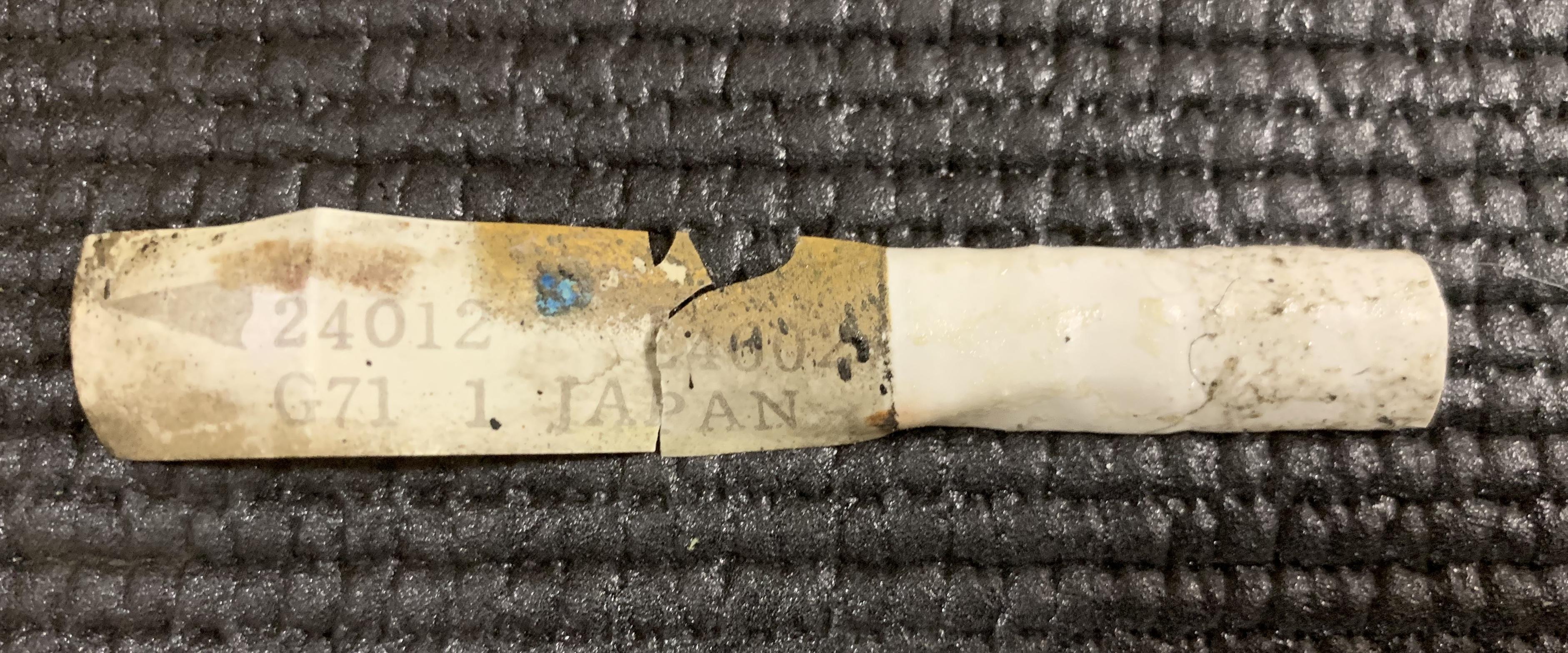

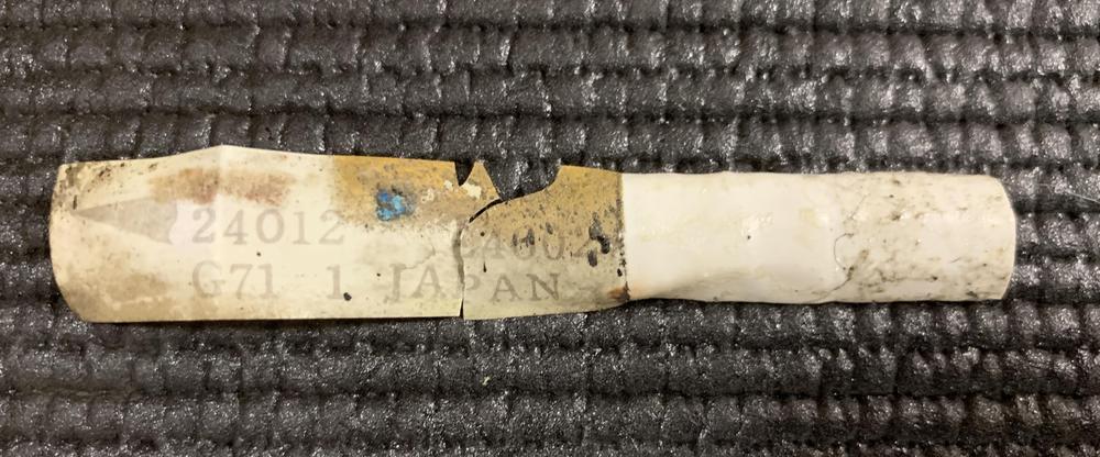

January 13, 20196 yr Author comment_565839 Original wiring harness sticker. This was up by the horns. Pretty neat to find after so many years. Link to comment https://www.classiczcars.com/forums/topic/58568-duffys-171-series-1-240z-build/?&page=25#findComment-565839 Share on other sites More sharing options...
January 13, 20196 yr comment_565841 7 minutes ago, duffymahoney said: Original wiring harness sticker. This was up by the horns. Pretty neat to find after so many years. Nix240 has reproduced all these tags on his car during his restoration Link to comment https://www.classiczcars.com/forums/topic/58568-duffys-171-series-1-240z-build/?&page=25#findComment-565841 Share on other sites More sharing options...
January 13, 20196 yr Author comment_565844 8 minutes ago, Patcon said: Nix240 has reproduced all these tags on his car during his restoration I will have to find the thread. I’m not restoring mine. But just making it nicer. Someday I might acid bath it and paint it right. Who knows. Link to comment https://www.classiczcars.com/forums/topic/58568-duffys-171-series-1-240z-build/?&page=25#findComment-565844 Share on other sites More sharing options...
January 13, 20196 yr comment_565848 45 minutes ago, duffymahoney said: I will have to find the thread. I’m not restoring mine. But just making it nicer. Someday I might acid bath it and paint it right. Who knows. I don't believe he documented it here. He may have over on HybridZ Link to comment https://www.classiczcars.com/forums/topic/58568-duffys-171-series-1-240z-build/?&page=25#findComment-565848 Share on other sites More sharing options...
