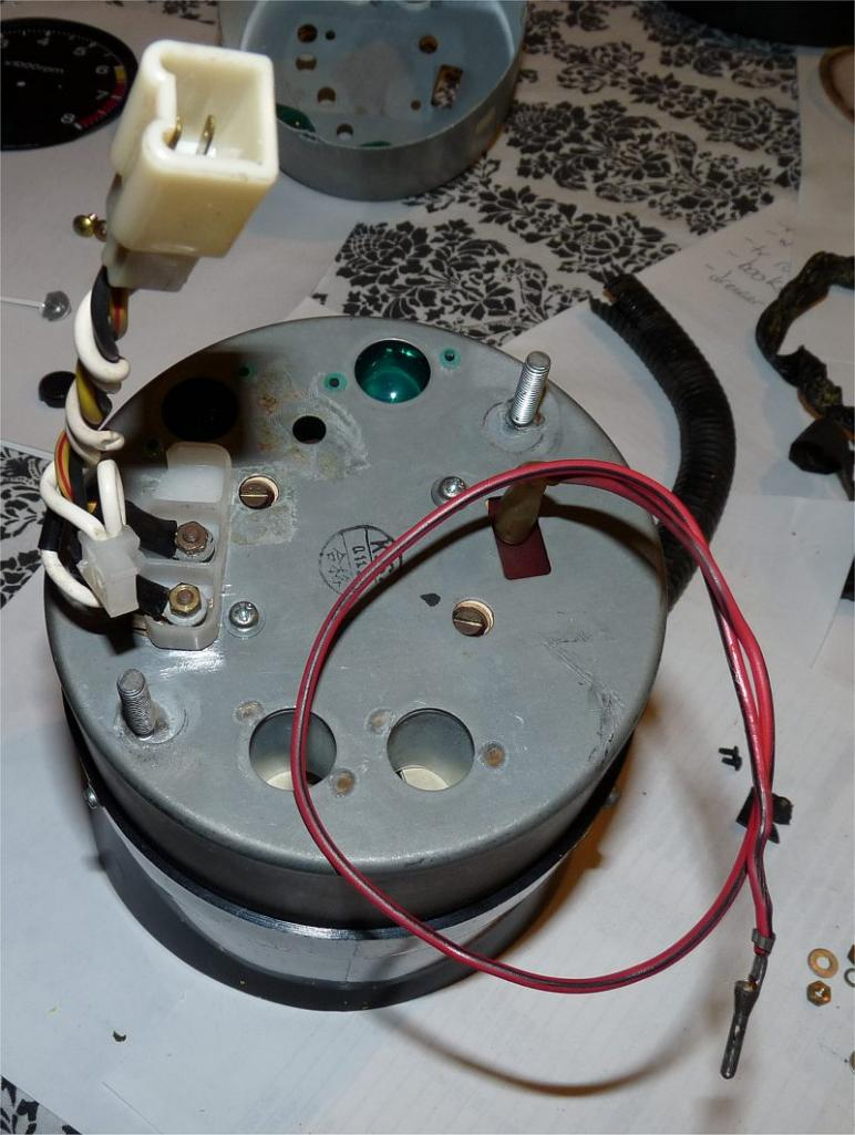

September 3, 20195 yr Author comment_583213 280z tach guts are in a series 1 tach housing. Hopefully the negative trigger and my coil on plug works with the tach with a 2.2 ohm resistor Link to comment https://www.classiczcars.com/forums/topic/58568-duffys-171-series-1-240z-build/?&page=39#findComment-583213 Share on other sites More sharing options...

September 5, 20195 yr comment_583310 Don't forget to run the 280z sense contact to the coil negative. See the red wire here: Link to comment https://www.classiczcars.com/forums/topic/58568-duffys-171-series-1-240z-build/?&page=39#findComment-583310 Share on other sites More sharing options...
