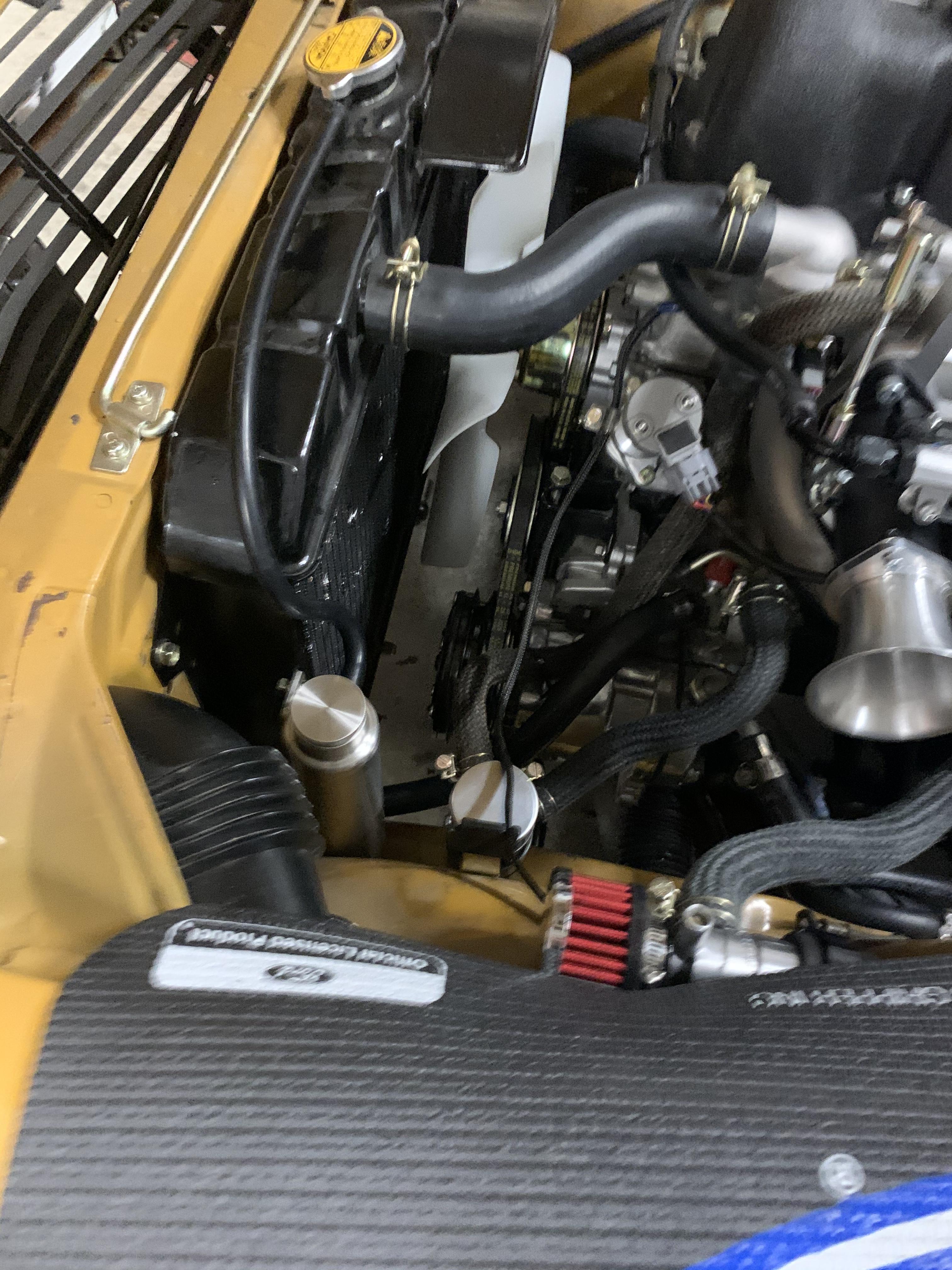

Well it runs, but terrible.  I have a massive vac leak, either from my balance bar not sealing or maybe a throttle body wasn't bolted down correctly.  Even with throttle plates in the full closed position it runs happily at 900 rpms. So it's getting a ton of air from somewhere.

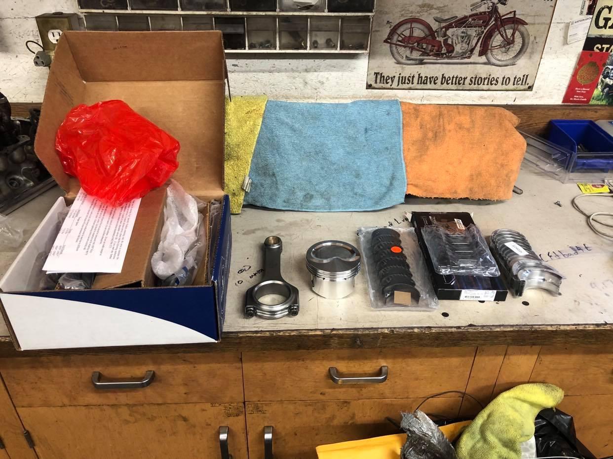

So what is in the Rebello 3.2 kit?
What do you have to provide?
What head will you pair with it?

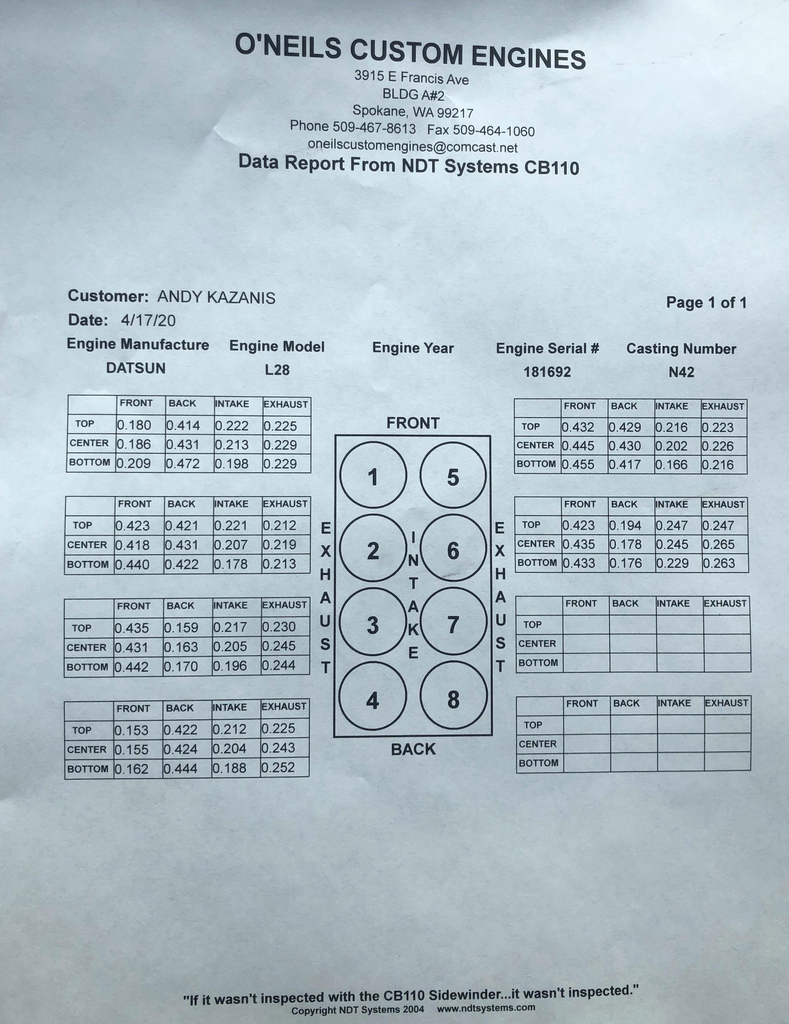

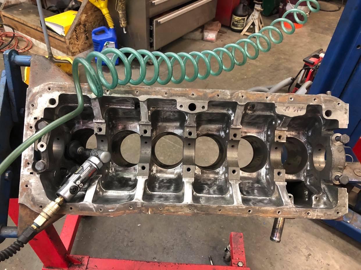

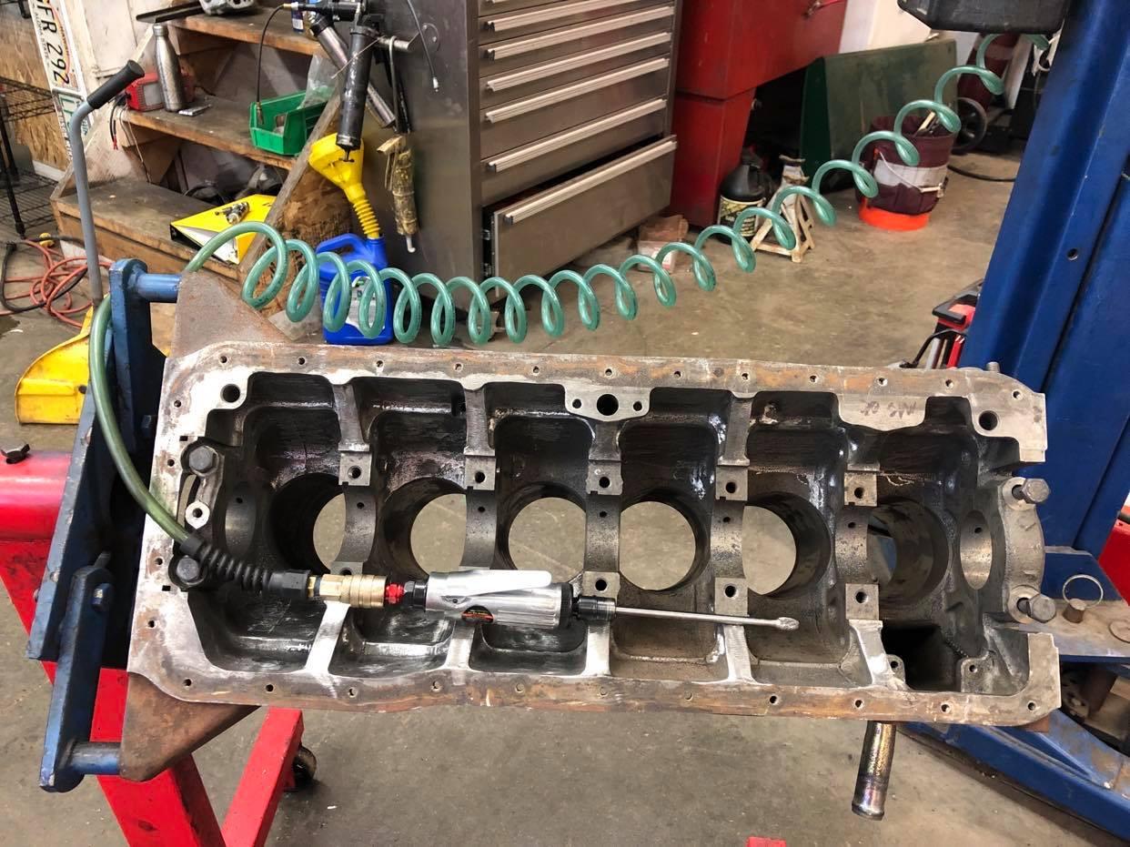

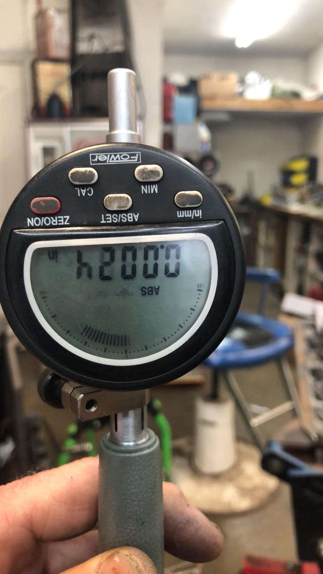

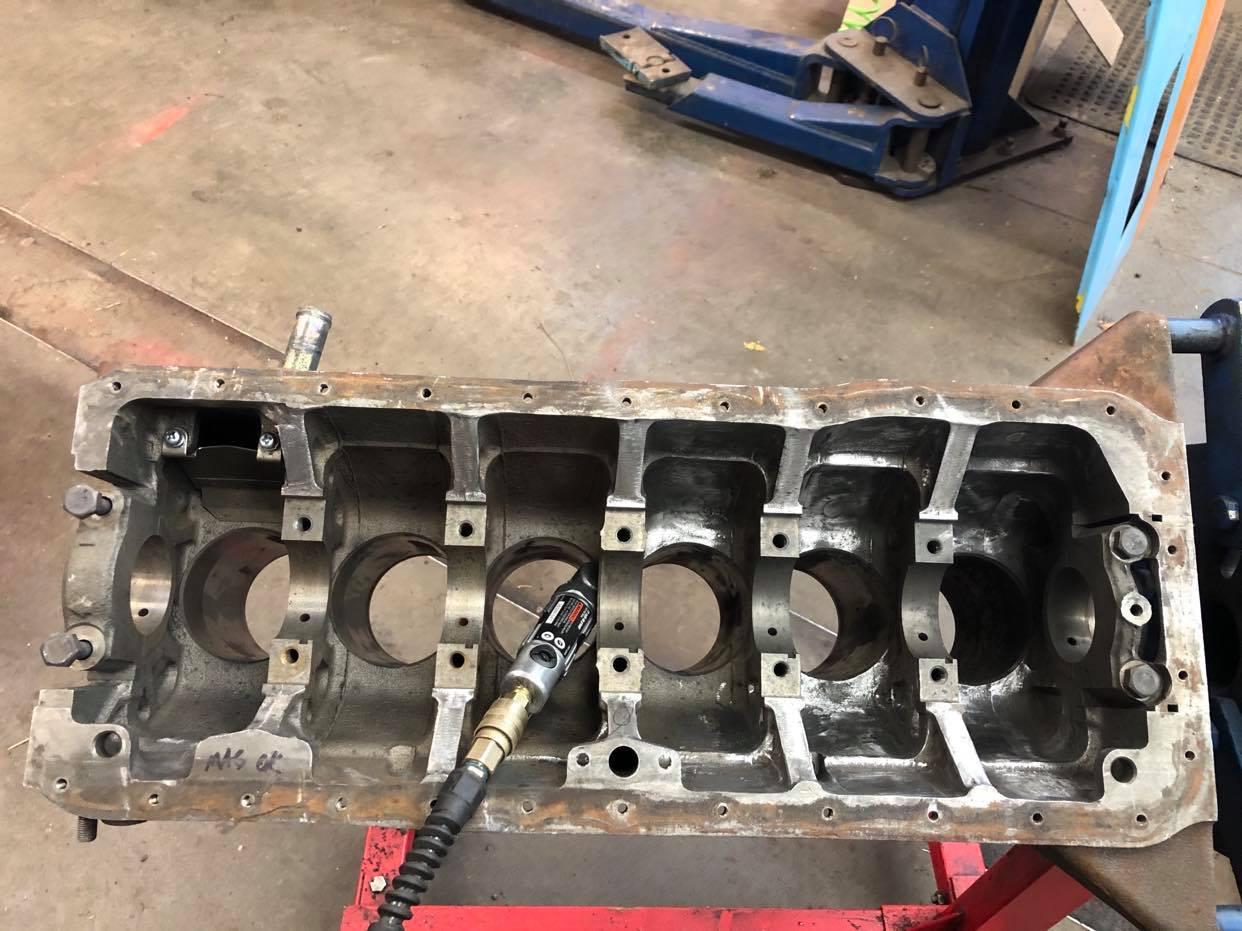

It requires you have a diesel crank to offset grind and a block that will go to at least 89mm - I believe.
Thats the way mine is anyway . You can pair is with any head with any compression - that’s a matter of preference . I think he can make a 3.0 out of any L28 block and crank . To get the extra .2 required a longer stroke .

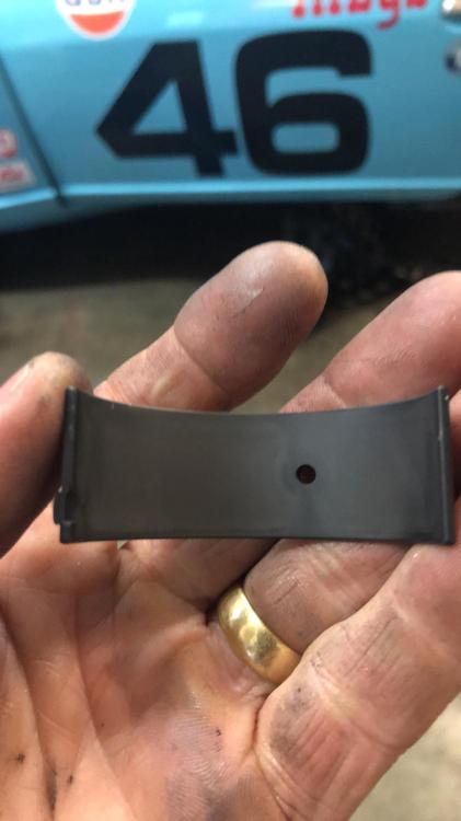

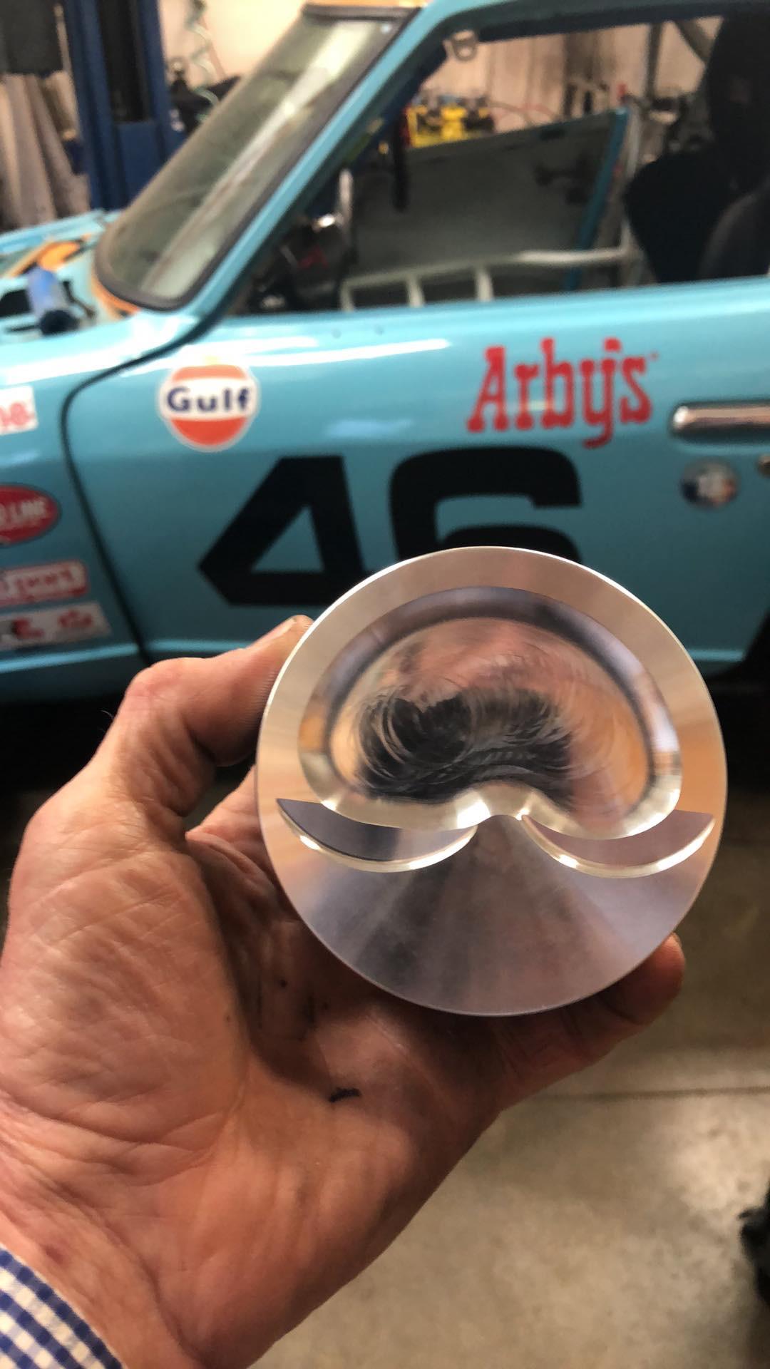

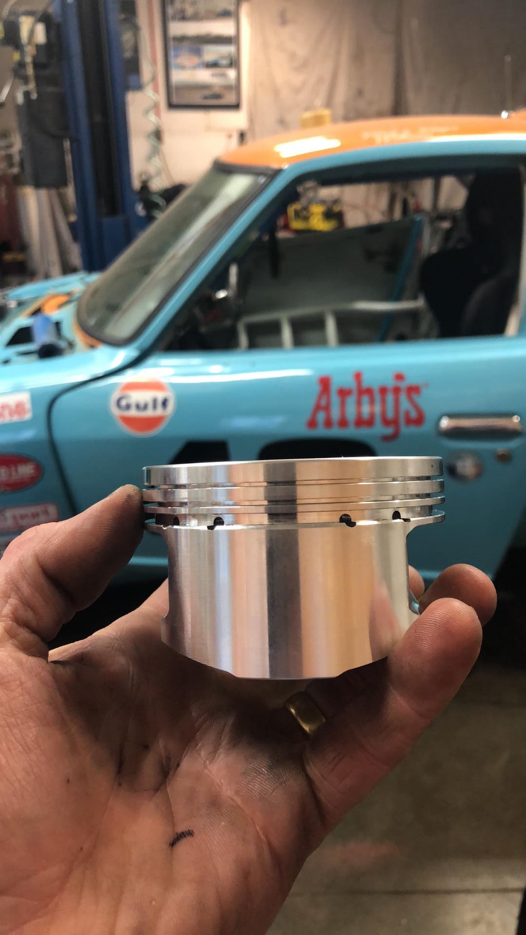

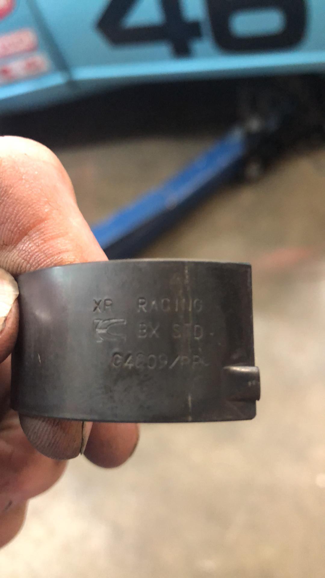

I sent my diesel crankshaft and a N42 block and $$$ and I got back all the ingredients to put one together . Rebello preps  the block and crank - custom pistons and all bearings .
