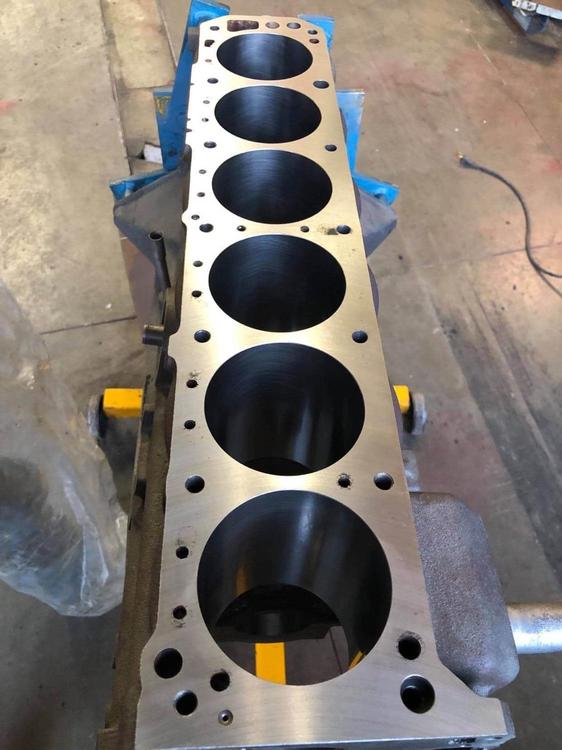

3.2L engine parts arrived from Rebello today!
JE Pistons, Eagle rods and king race bearings. Rod bearing clearances are spot on. Marine Crank did a fanstatic machining job on my extra long stroke LD crank.
