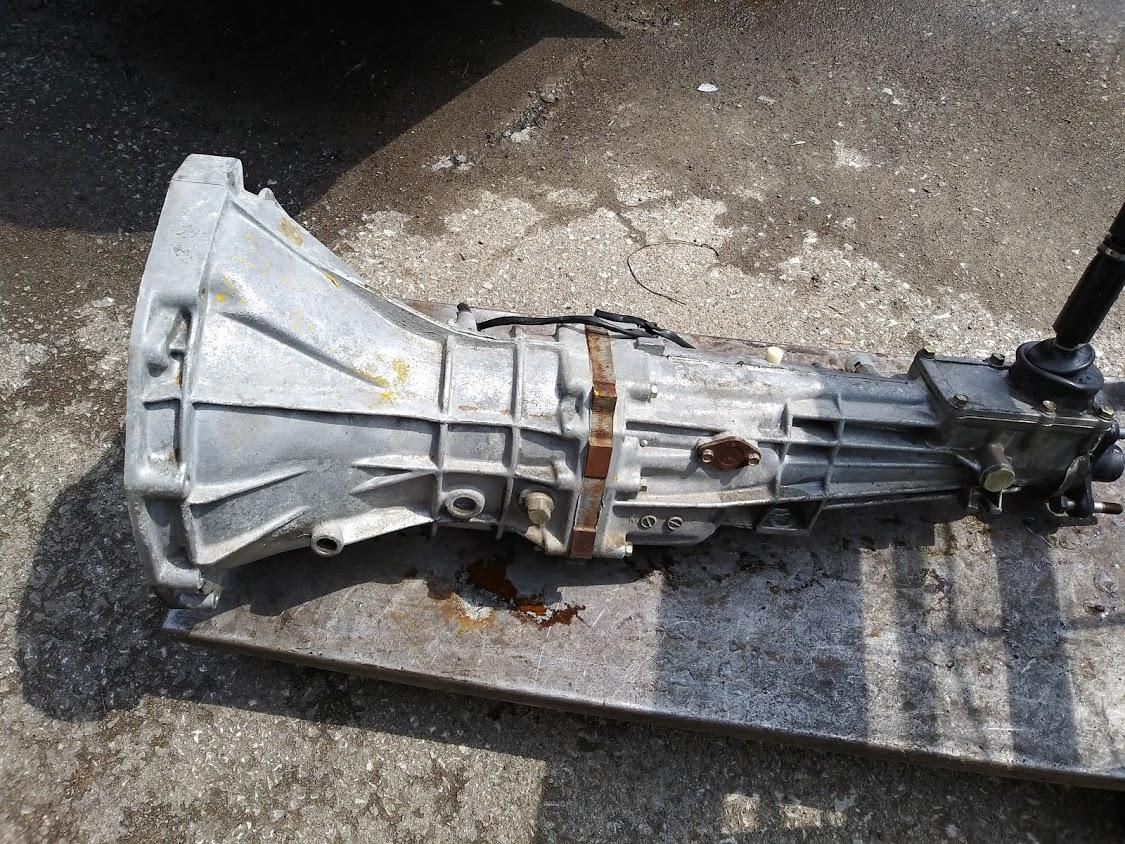

I screwed something up in the trans rebuild, it becomes tight with the front cover on, plus I guess I love spending money, so I decided on the KA swap for my 240z.  This is a longer tail shaft on the trans, so it should fit in my series 1 better (no cutting), plus the 1st is better gear ratio and 2nd is slightly better.  I found a 1989 240sx trans, with 576 miles on it.  It's been in storage inside since 12/01/89!  Zinc is still in tact.  Paid too much for it, but hopefully it's good.  The shop tested all the gears and syncros.
Digging up this older post. I have a series 1 to, still stock 4 speed. Do you have to cut the trans tunnel at all with the SX gearbox? I don't want to cut it and the idea of a 90§ bent shifter isn't appealing to me. So a SX 5spd swap might be the solution...
Zero cutting with the sx swap.

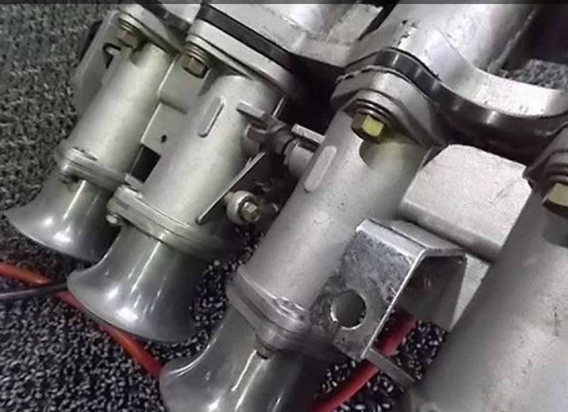

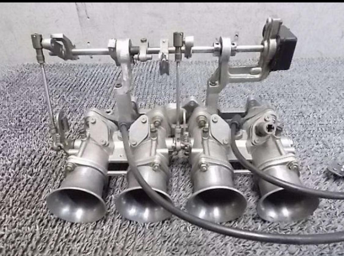

Well I’m probably a idiot. But I decided to swap my Jenvey throttles bodies out for something a little more vintage/ classic.
These are late 70s early 80s SK throttle bodies. They are 47mm that taper to 45. I picked them up off yahoo japan. They have a nice vac balance port on them. I bought two sets off a single seller.
Now time to fabricate a single piece fuel rail and find a tps sensor that works. They should match my SK intake nicely. The old SK stuff is so nicely cast. I’m excited!

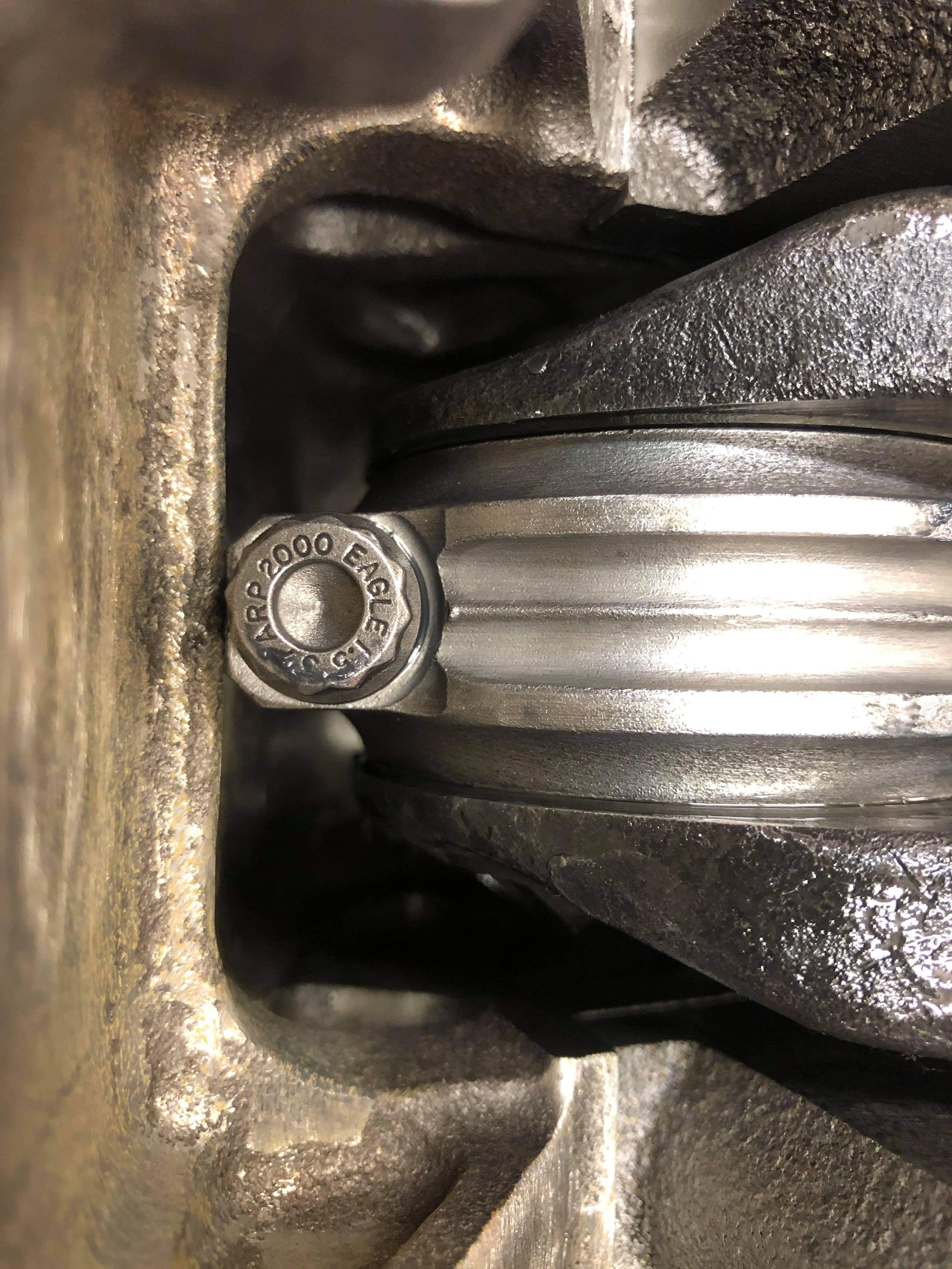

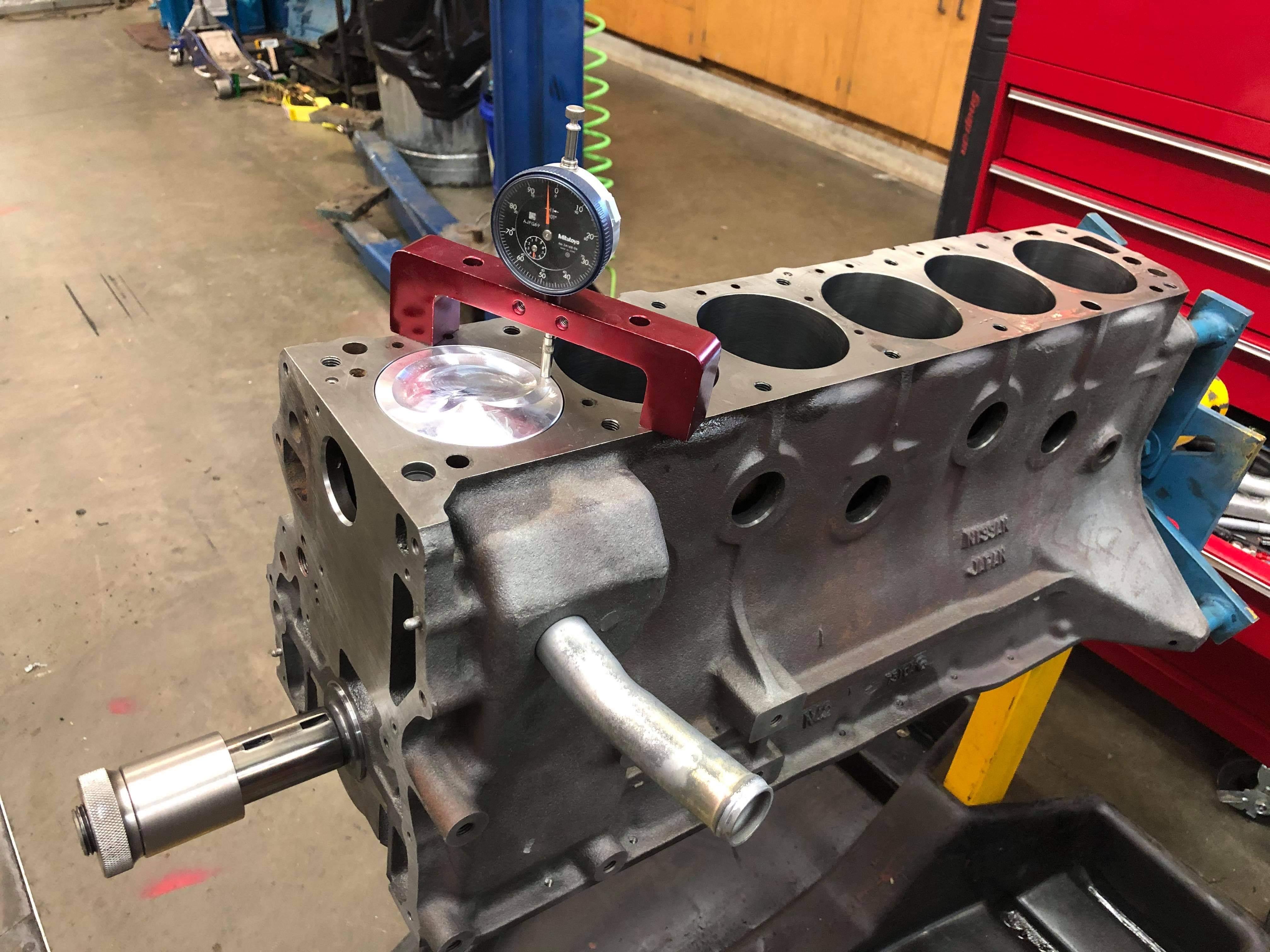

My 3.1ish stroker build ran into a small issue. The block will need to be clearanced a little more. The extra long stroked LD crank (84.6) is to blame.
The engine can be rotated, and it just barely touches about one time out of three. That’s just the .002” of bearing clearance rocking one way or another.
Deck height is within .002” of each other.

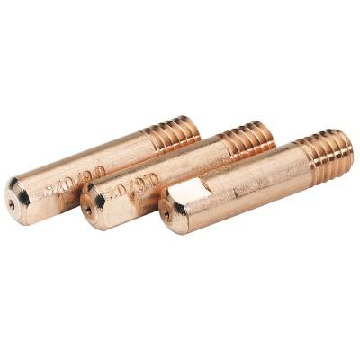

I had a similar problem getting a vacuum signal I could use on a Porsche I own. All those throttle plates opening at once creates a heck of an atmospheric drop. I ended up using a mig tip to mitigate the vacuum drop. It wasn't heavenly, but it made it more tuneable.
For reference, this is what a MIG welding tip looks like. It's simply an obstruction with a small hole in to modulate changes in vacuum, and anything could be used (aluminum rod with a drilled hole, a carb jet, a drilled plastic BB, etc). In a way, it introduces a 'lag' or slowdown of changes in vacuum, so you get a sort of averaging effect. Much better than having the MAP sensor report every peak and valley in the signal, and having the FI trying to keep up with that.
