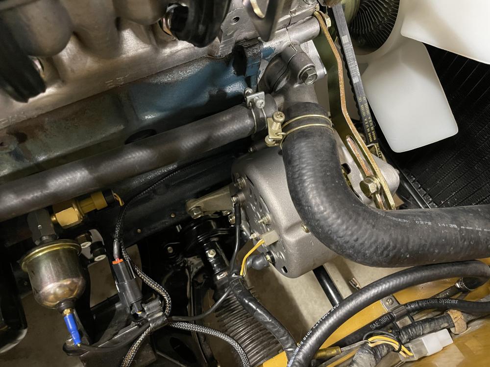

The block color was scanned and then matched, from pictures it looks a little light, but hopefully in person its perfect.  It's hard to judge block color, mine darkened with time/ age, but the parts with none of that the blue is pretty light.
Your's looks great! I'd give anything to go back to the 1st rattle can color I used, Ford blue. I ended up going to Pontiac blue and it's too pale. It has darkened some with time though so it's not as "baby boy blue".

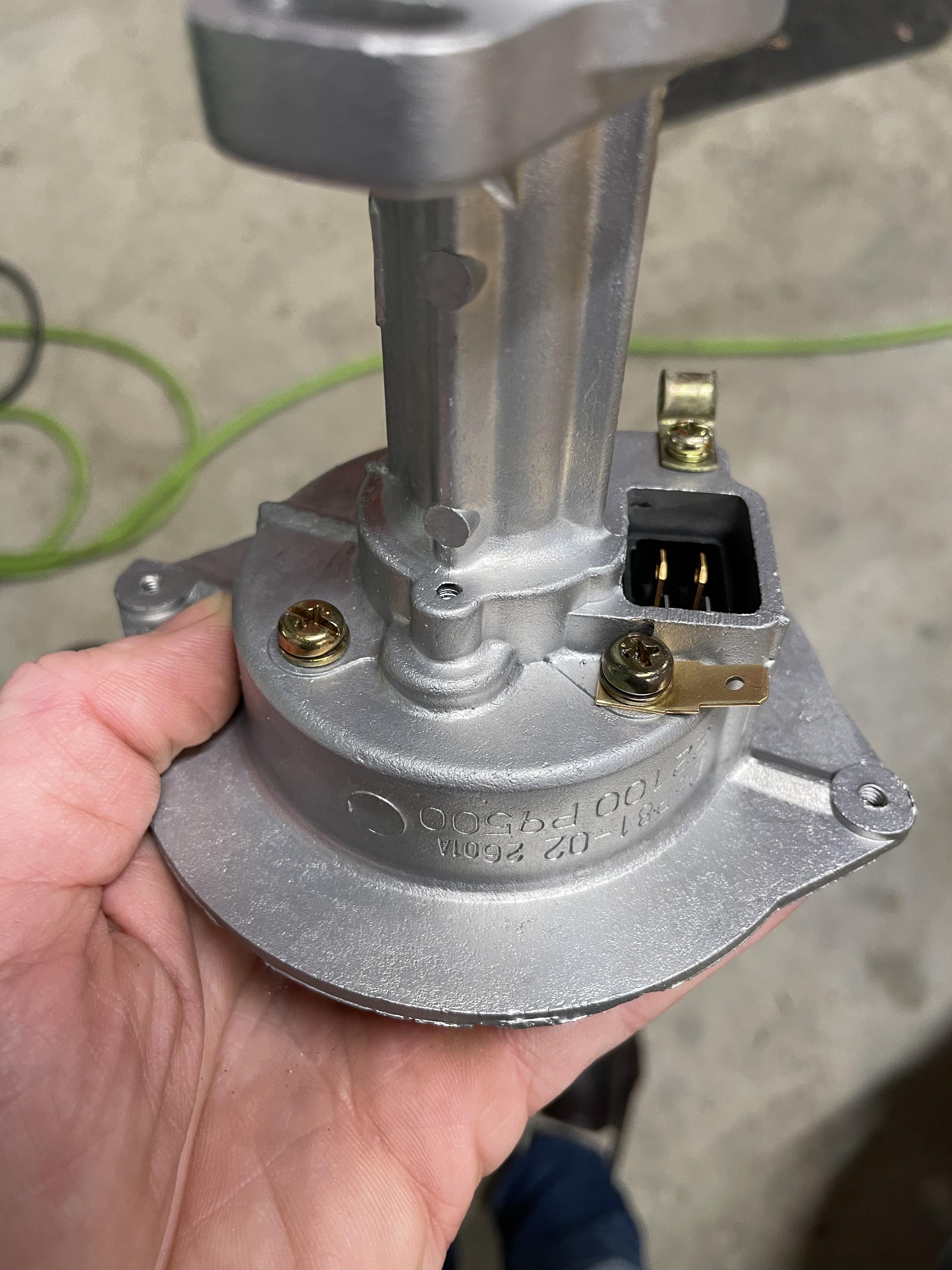

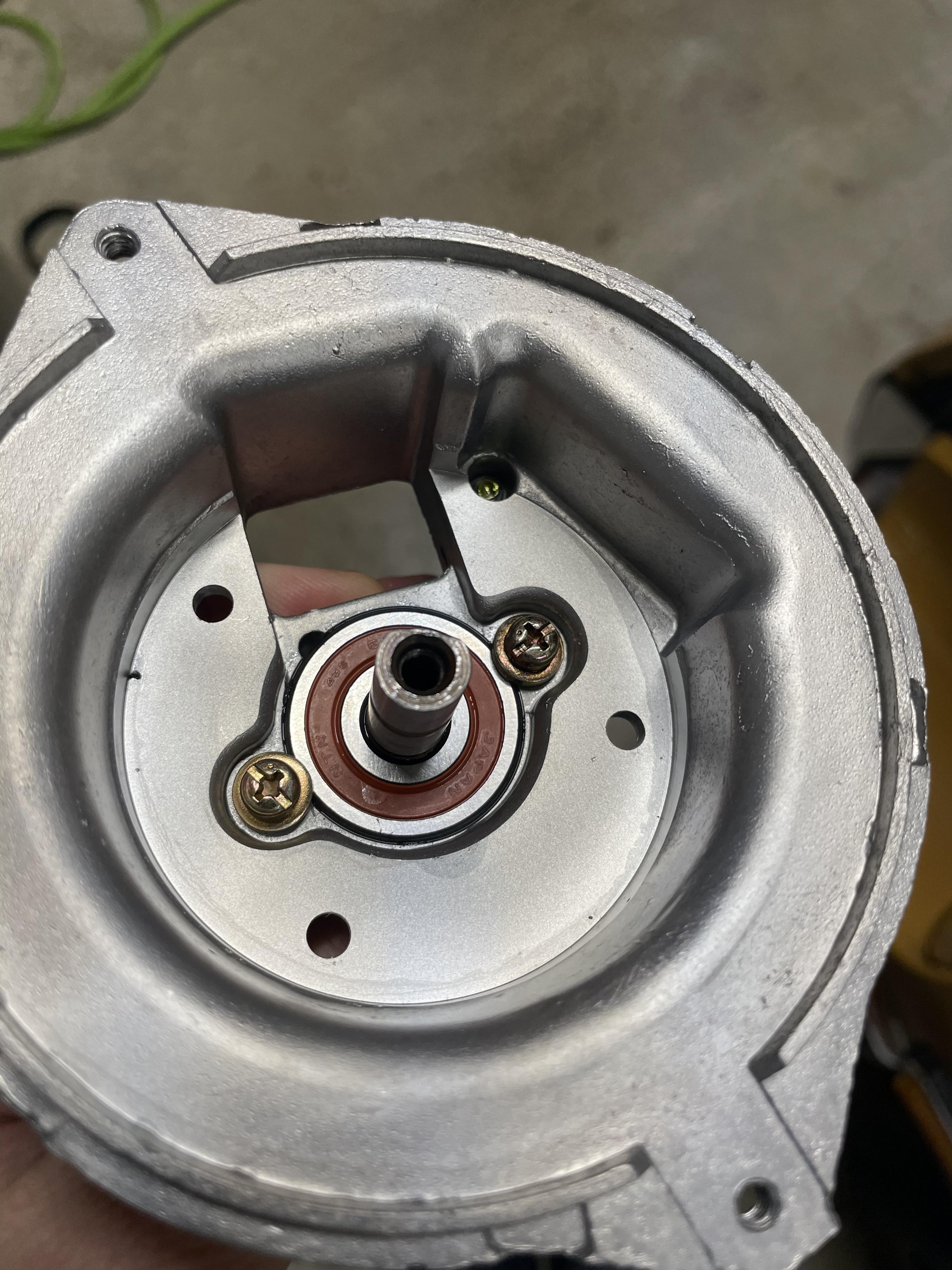

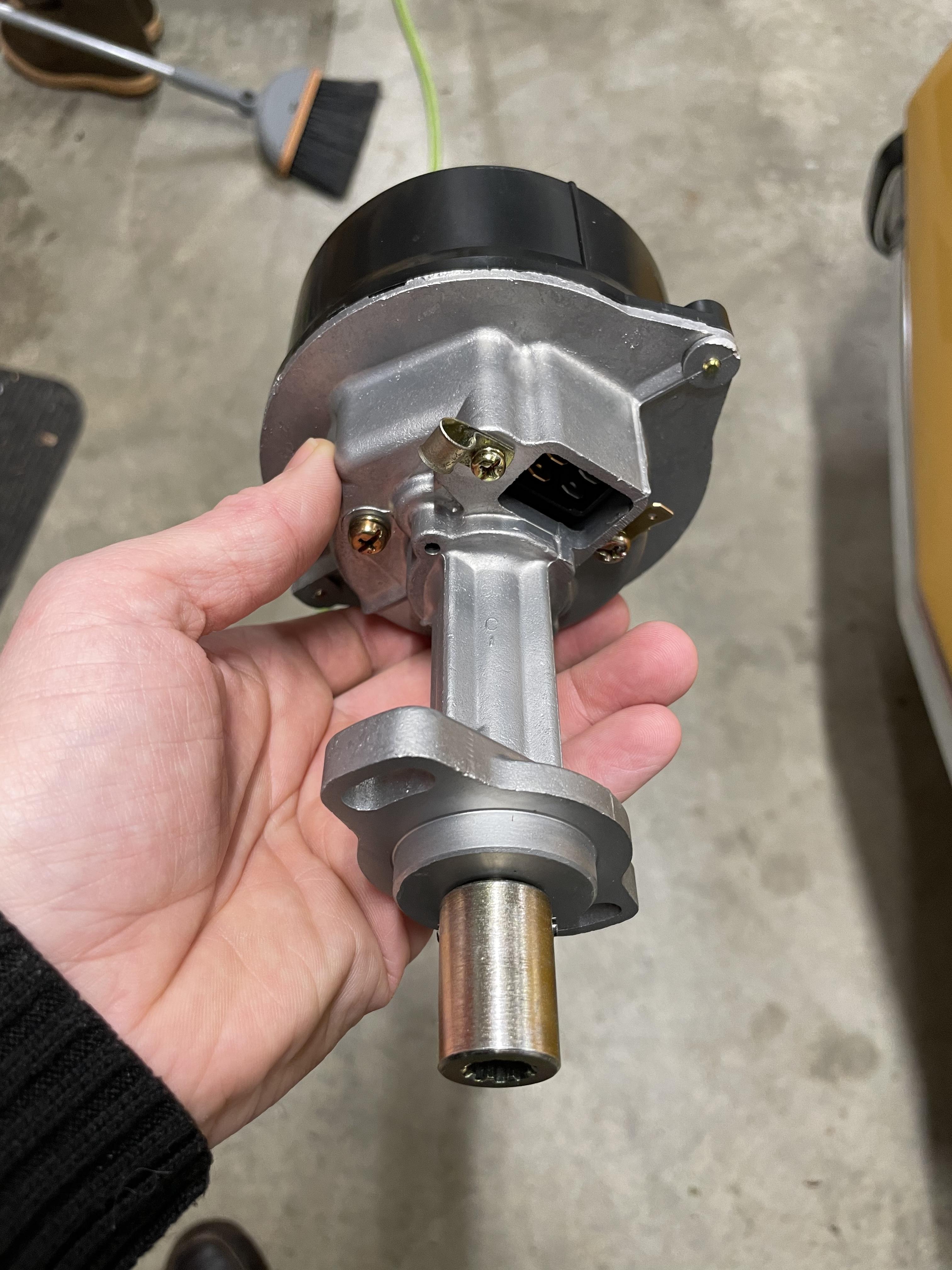

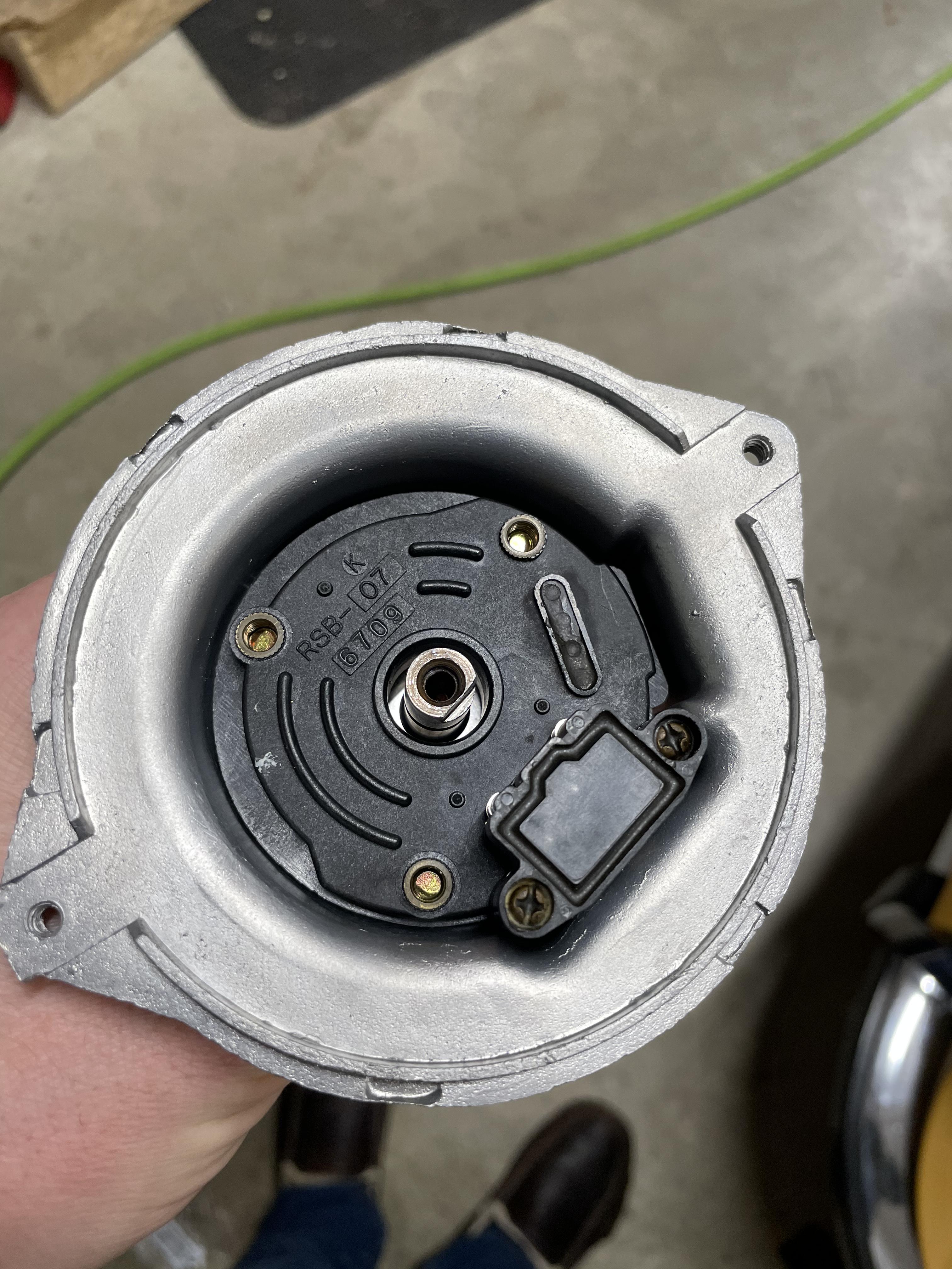

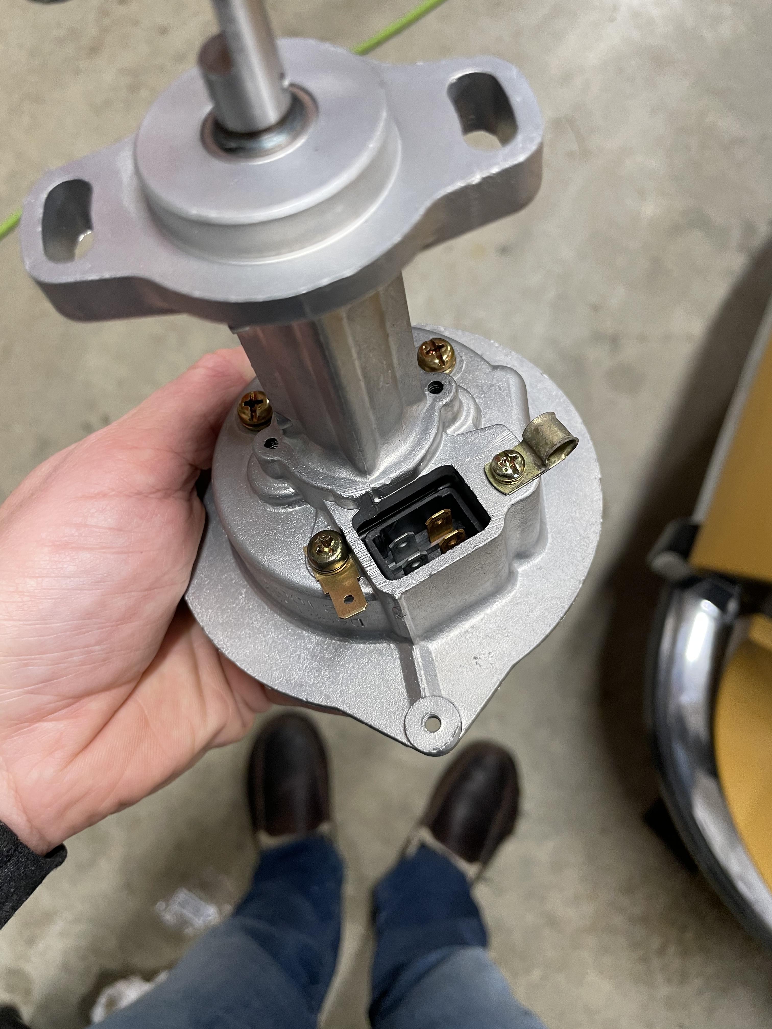

I rebuilt this 82-83 turbo distributor today. New bearing, all new zinc and a new z31 cas.
only issue so far is the Cas disk I have might be bent.
also

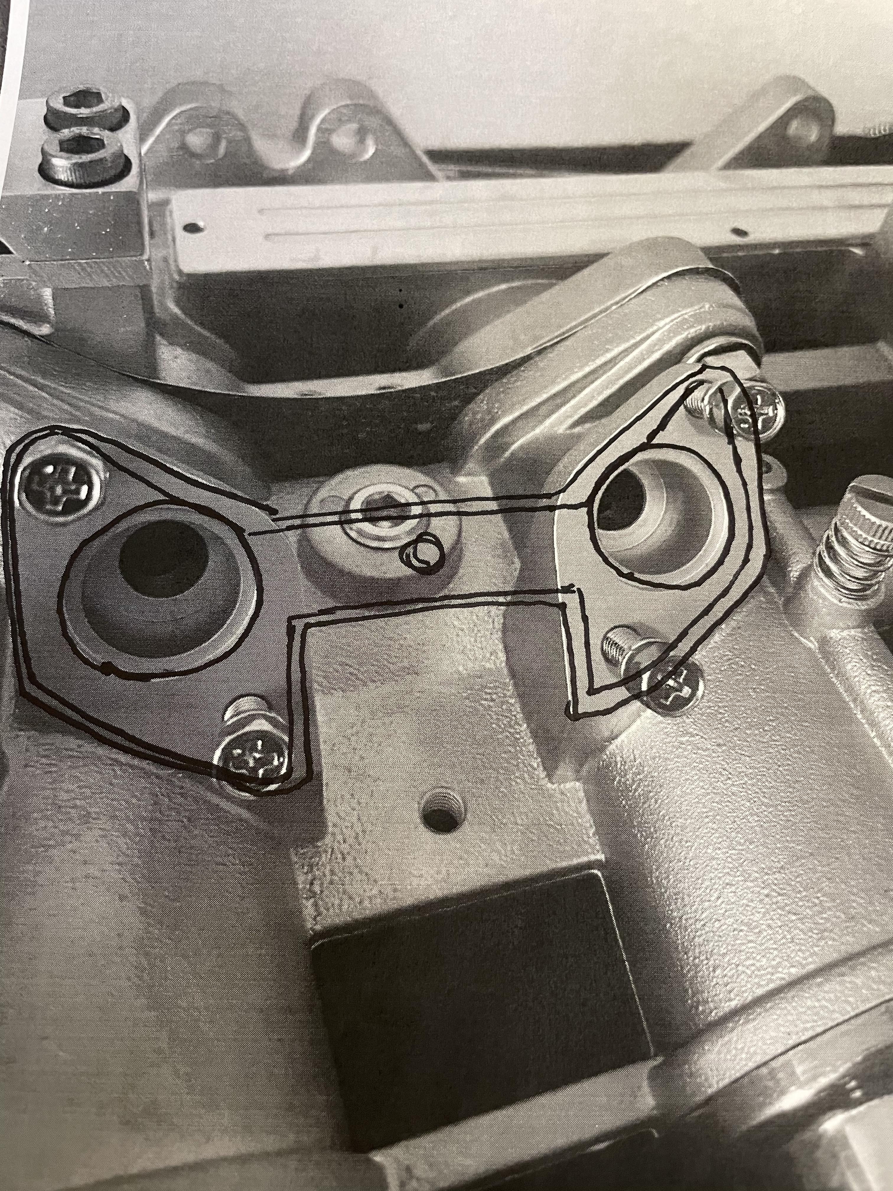

Cas turbo upgrade method #2. This is for a 82-83 turbo distributor.
Instead of using long nuts and bolts. I thought this would be a cleaner install.
Drilled out the base to allow m5 jis screws. Then threaded and tapped the maxima cas
