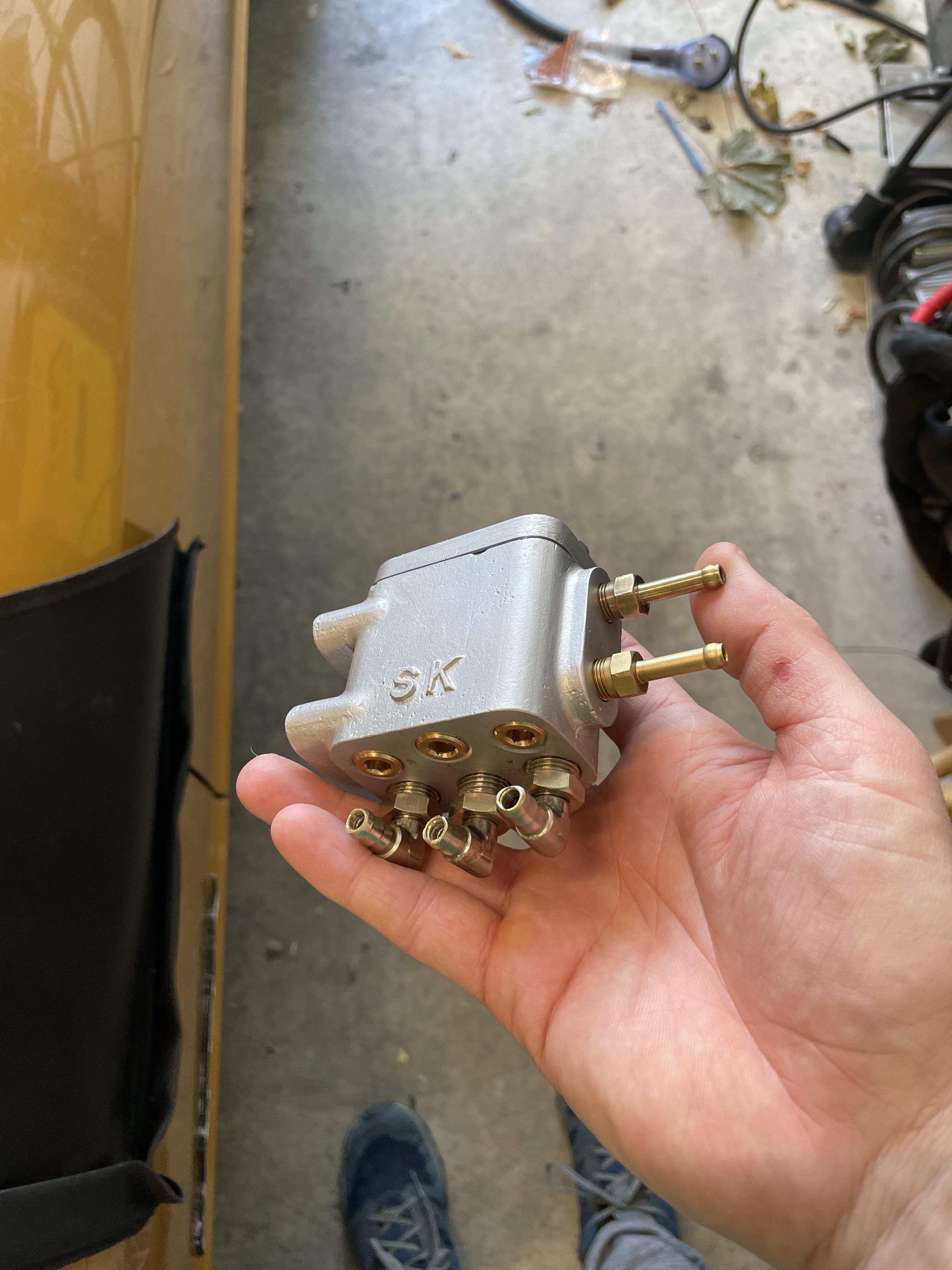

I love making/ designing parts! I think it’s my favorite part of this strange hobby.

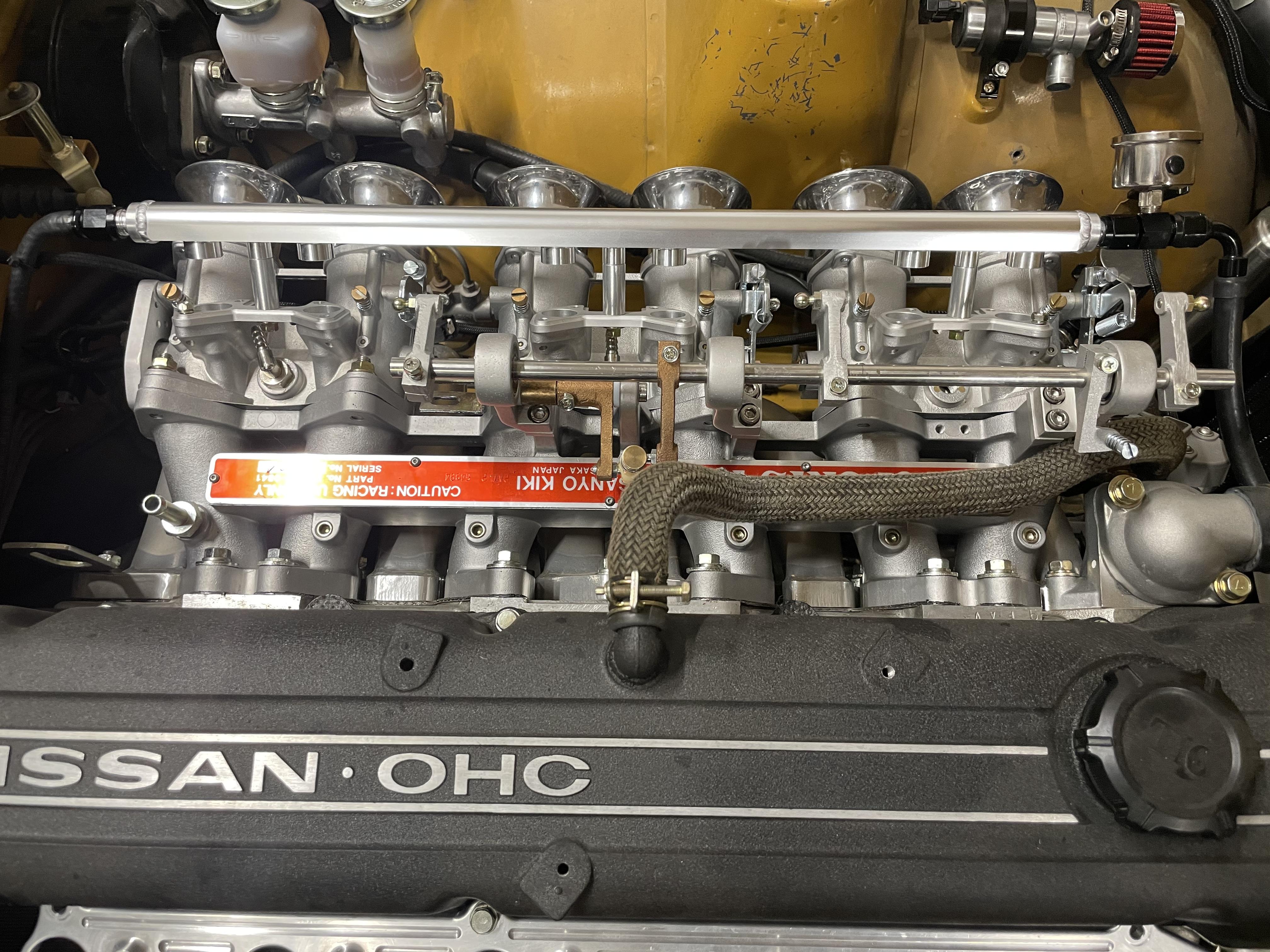

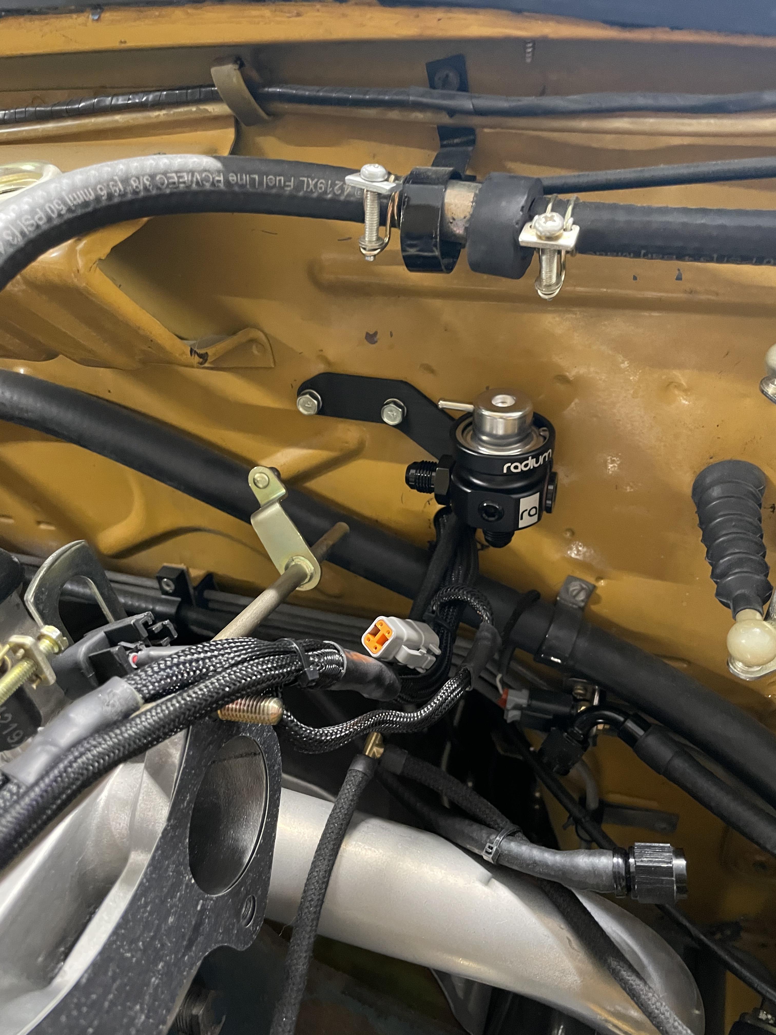

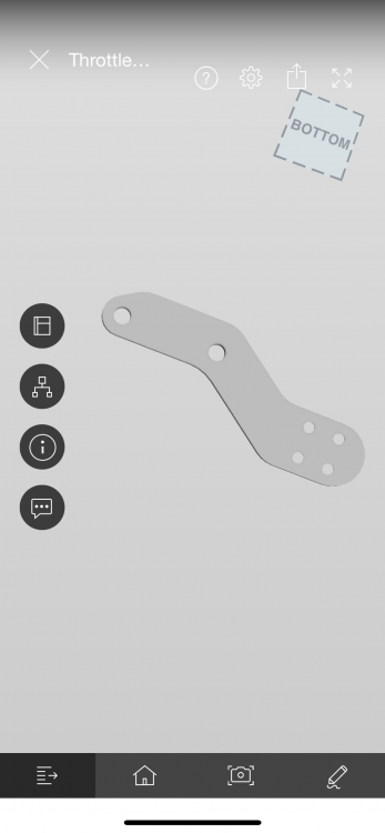

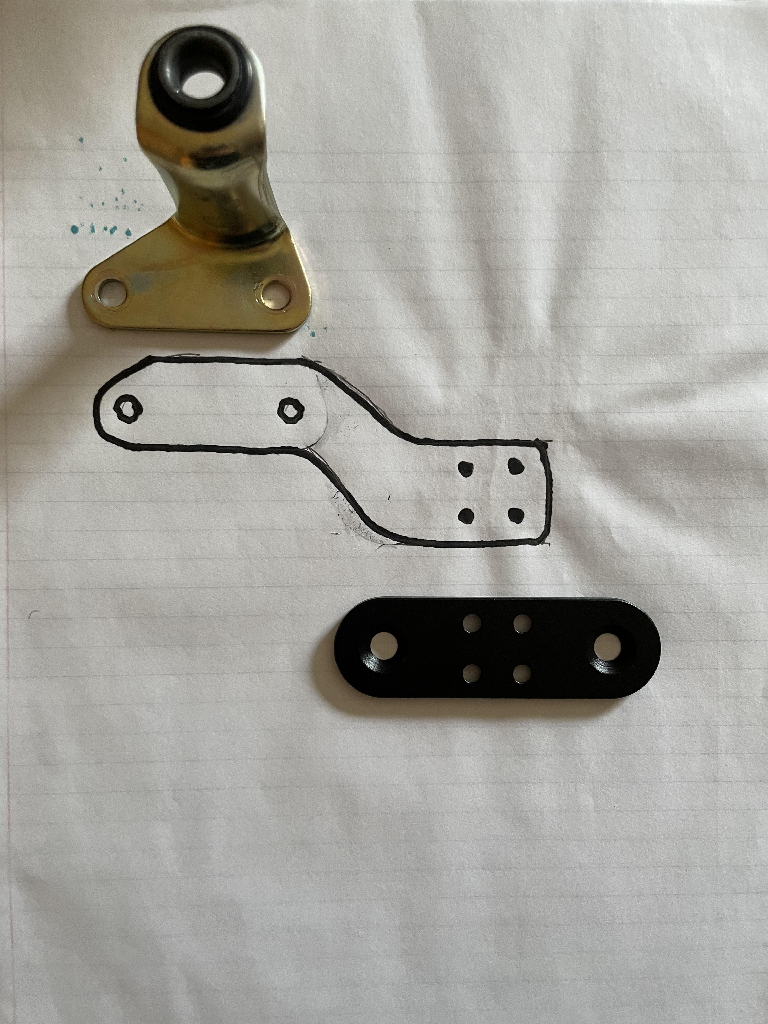

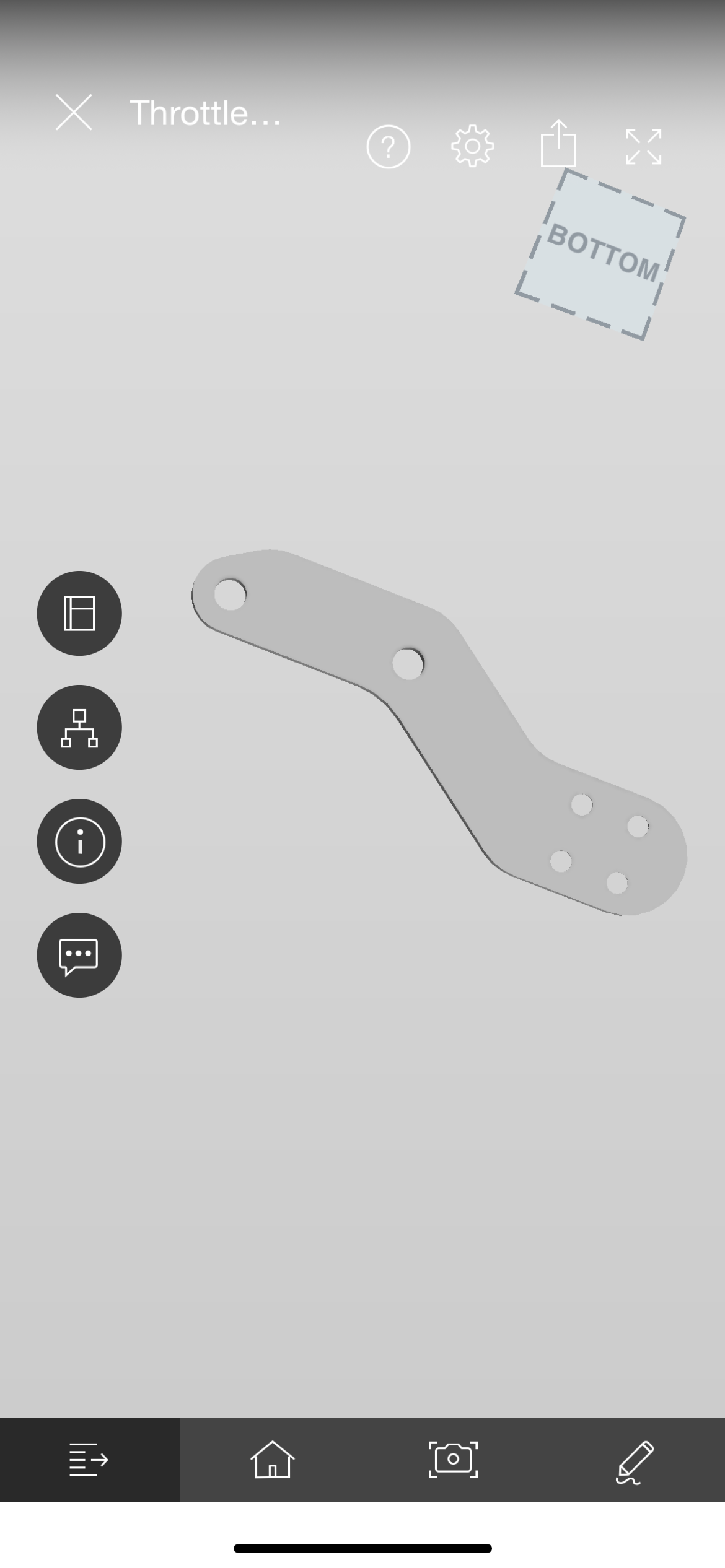

This is a zero hole in my car EFI FPR mount. Next I will have it cnc cut. This is just 3D printed. Draw, design, test and make. So much fun.

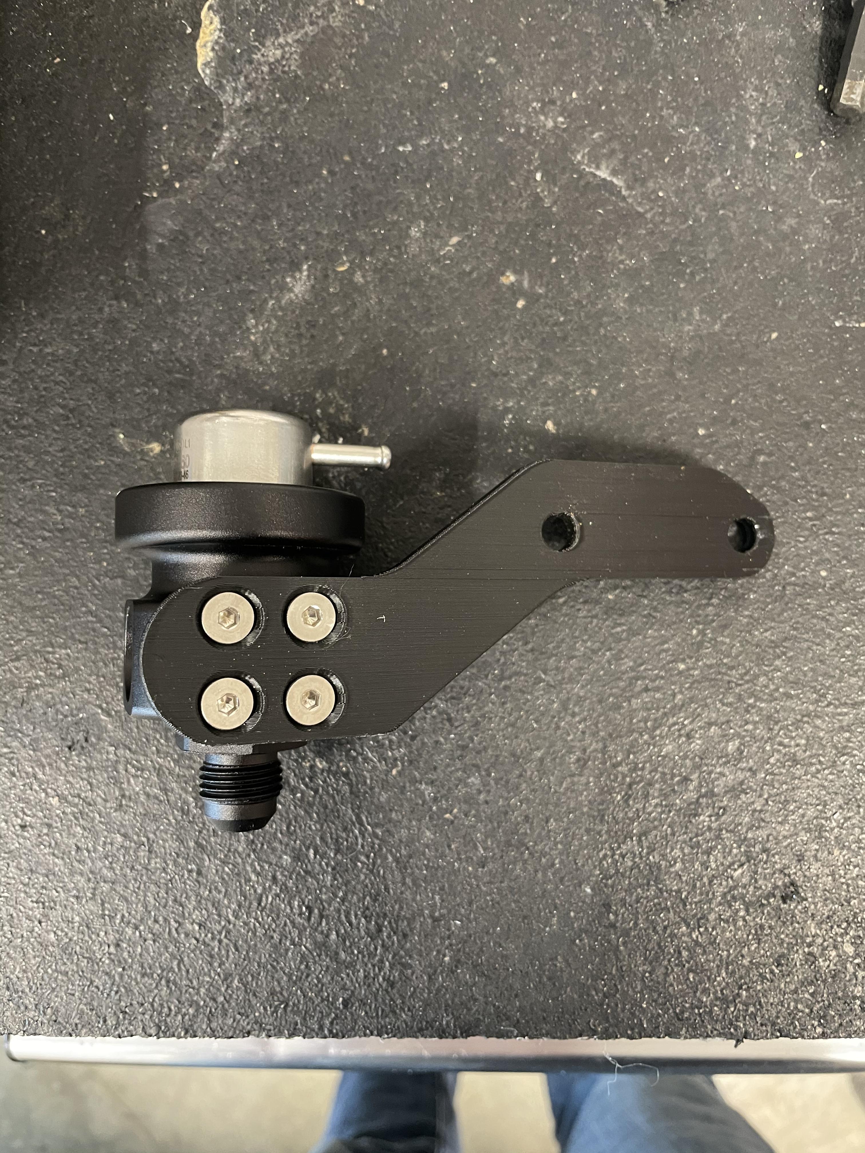

I really like how simple this radium fuel pressure regulator is. Uses a Bosch top. Very well thought out.
Art and function done well . I still admire your skills . It’s hard to watch without being envious of your meticulousness . Fortunately I have a friend with a mill that can make me precision , because I’m more the ‘get er done’ guy .

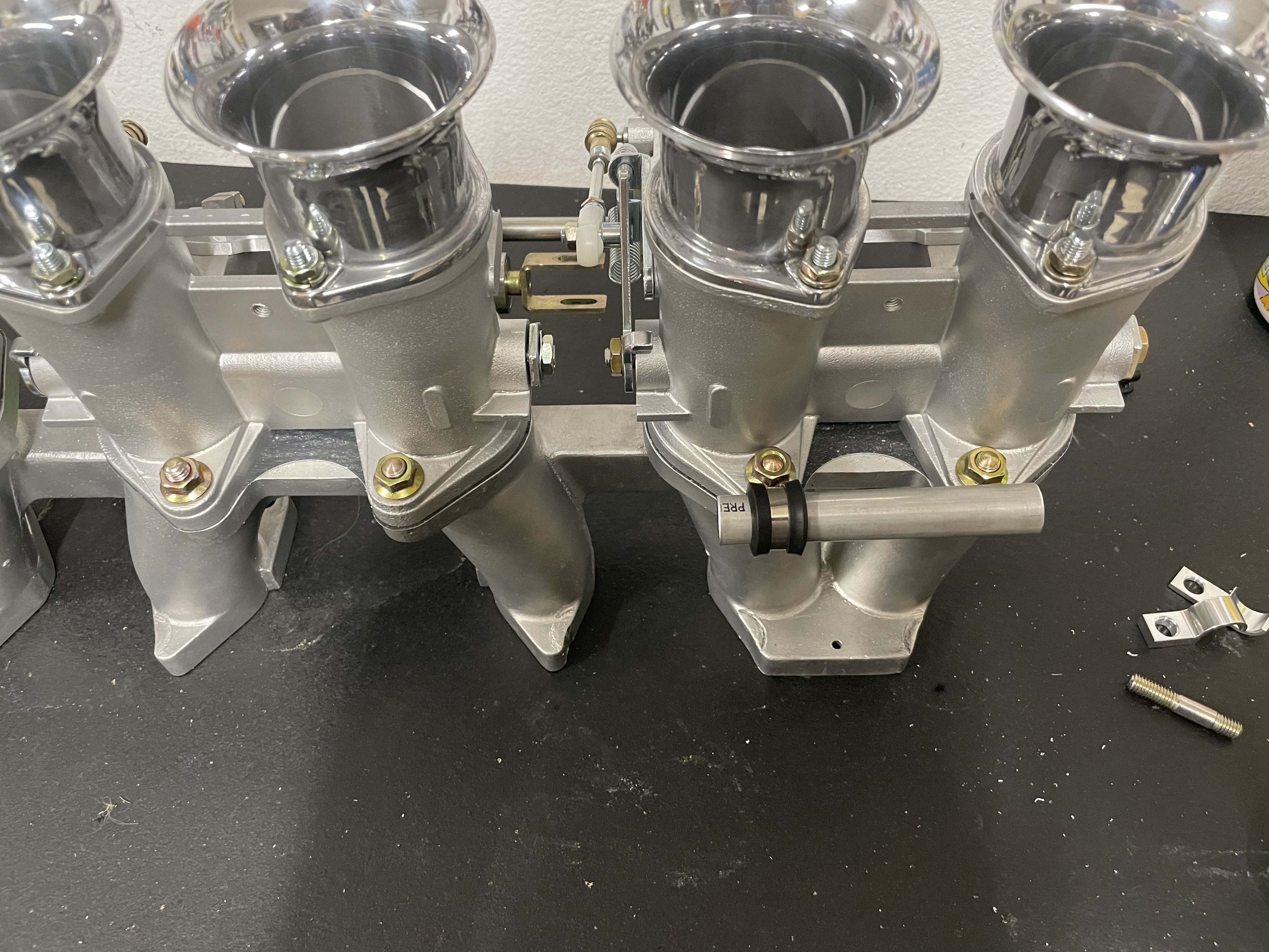

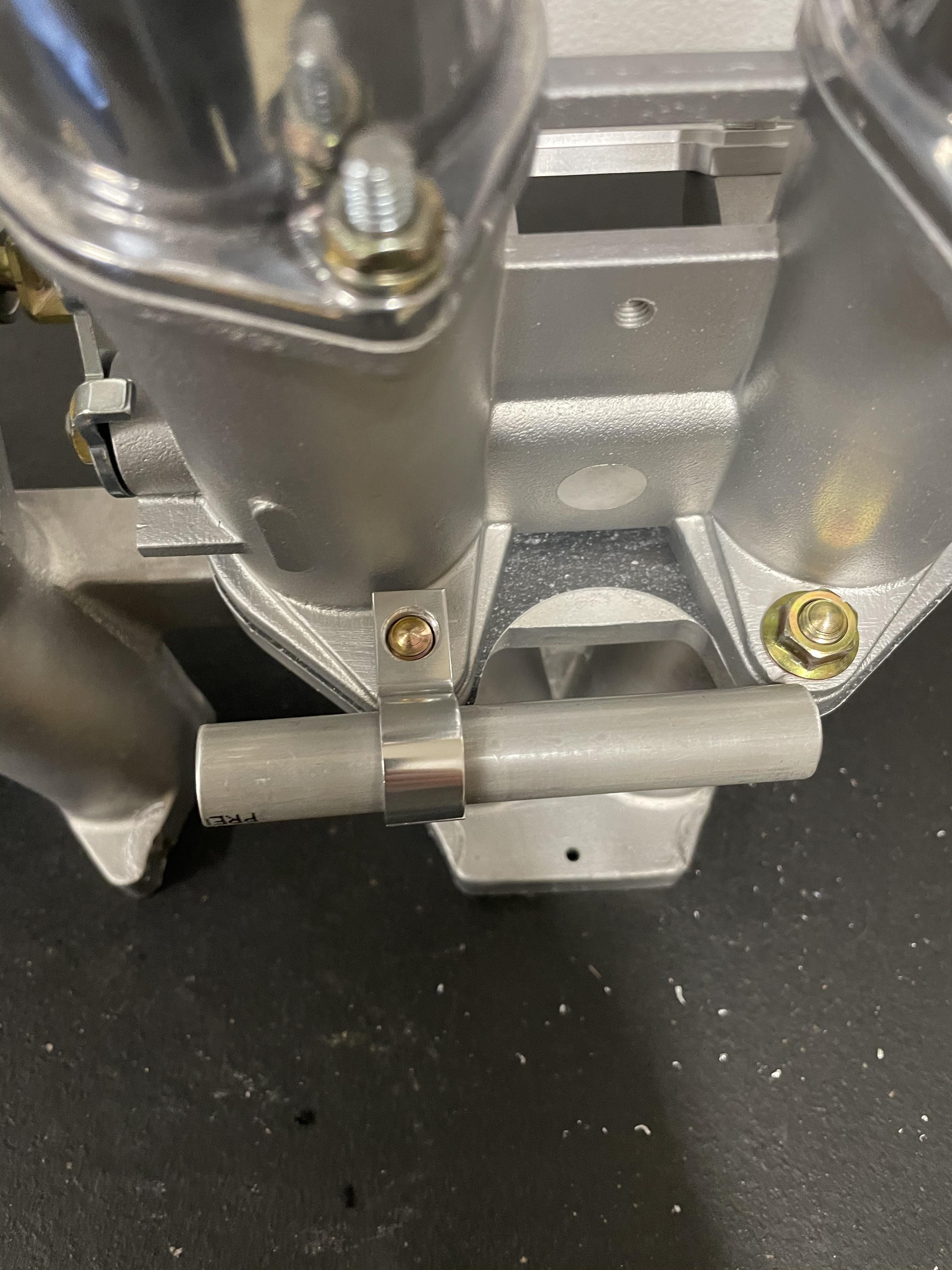

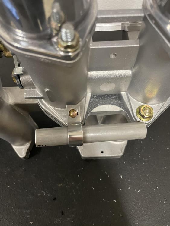

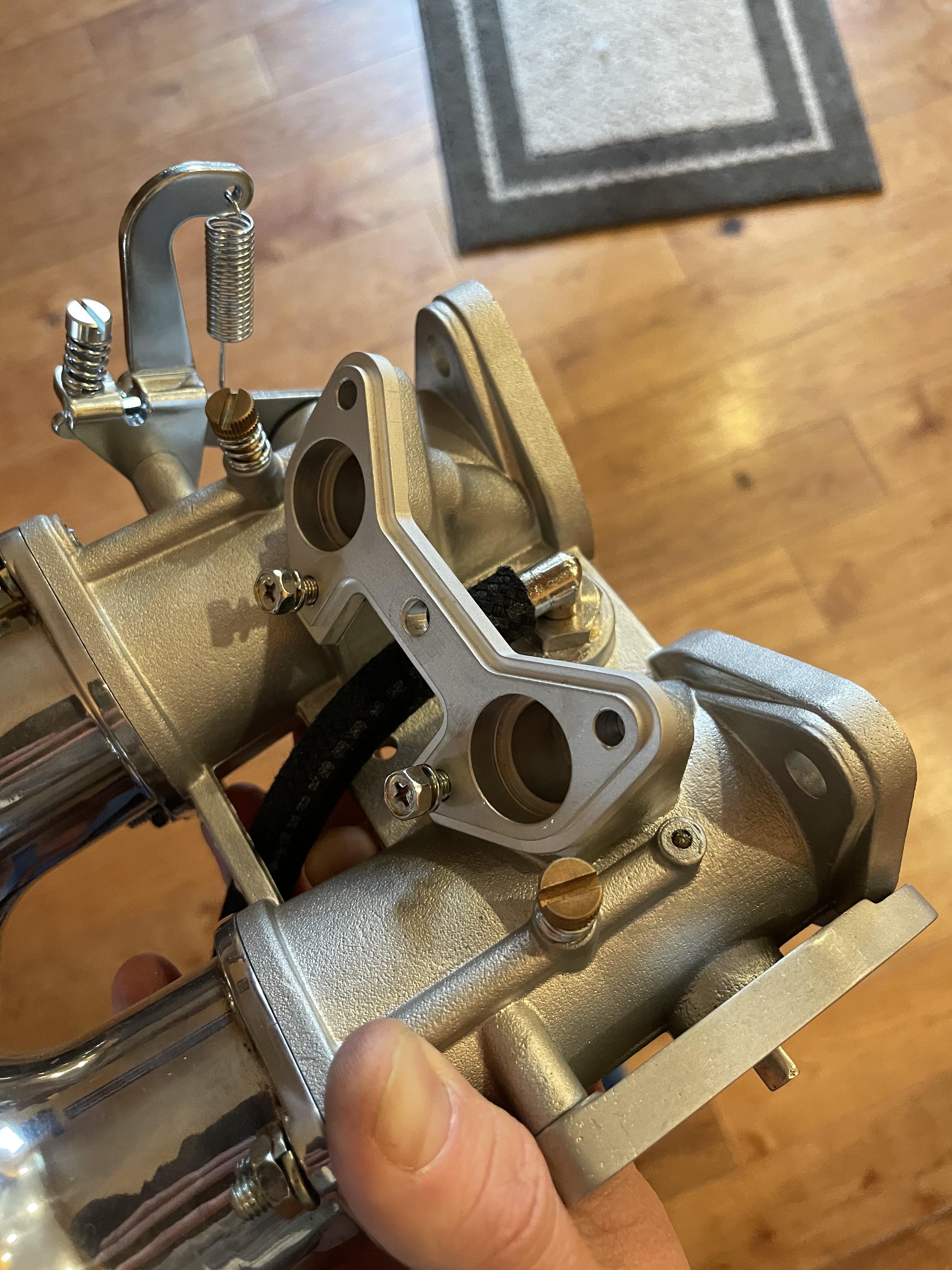

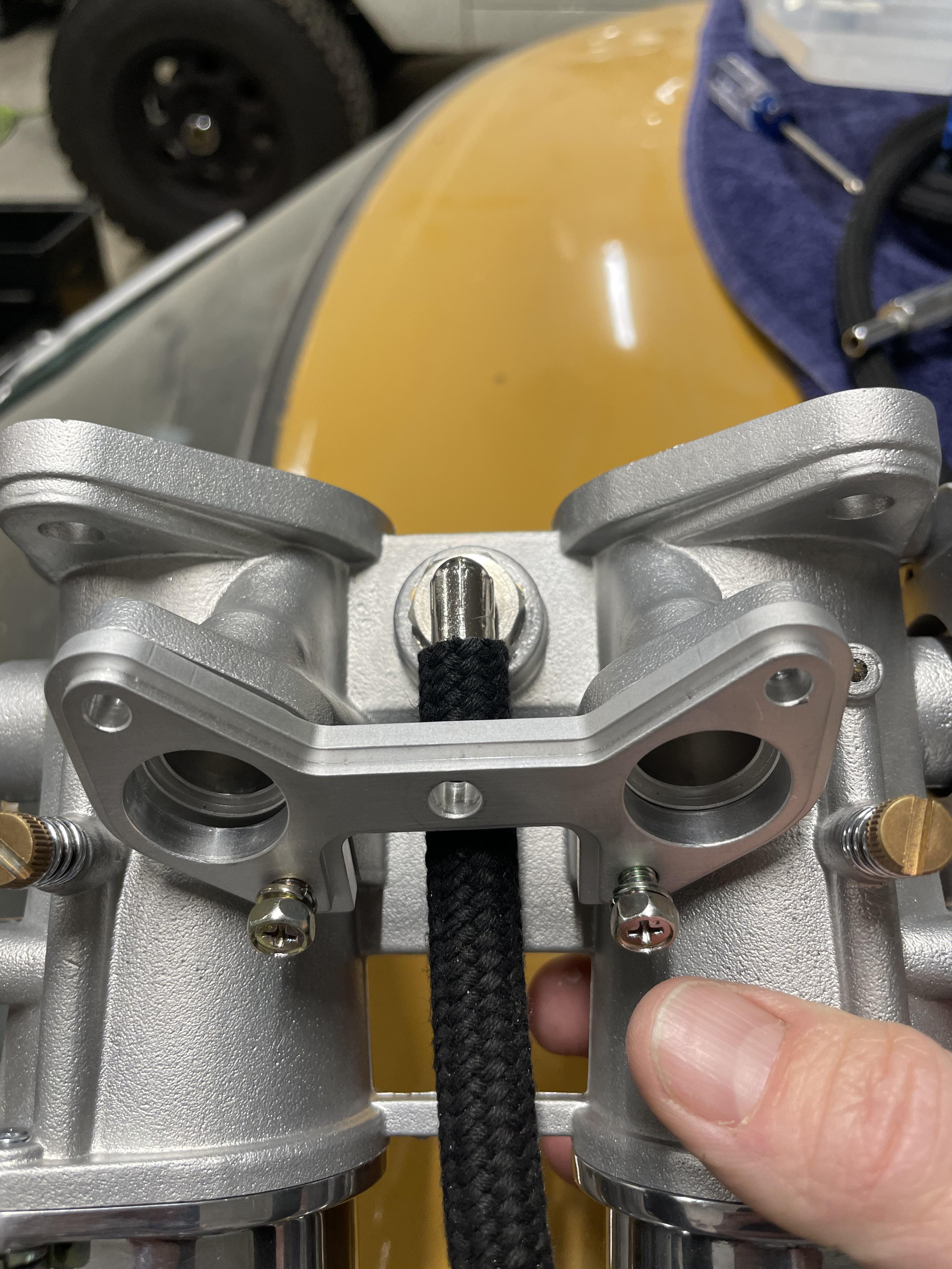

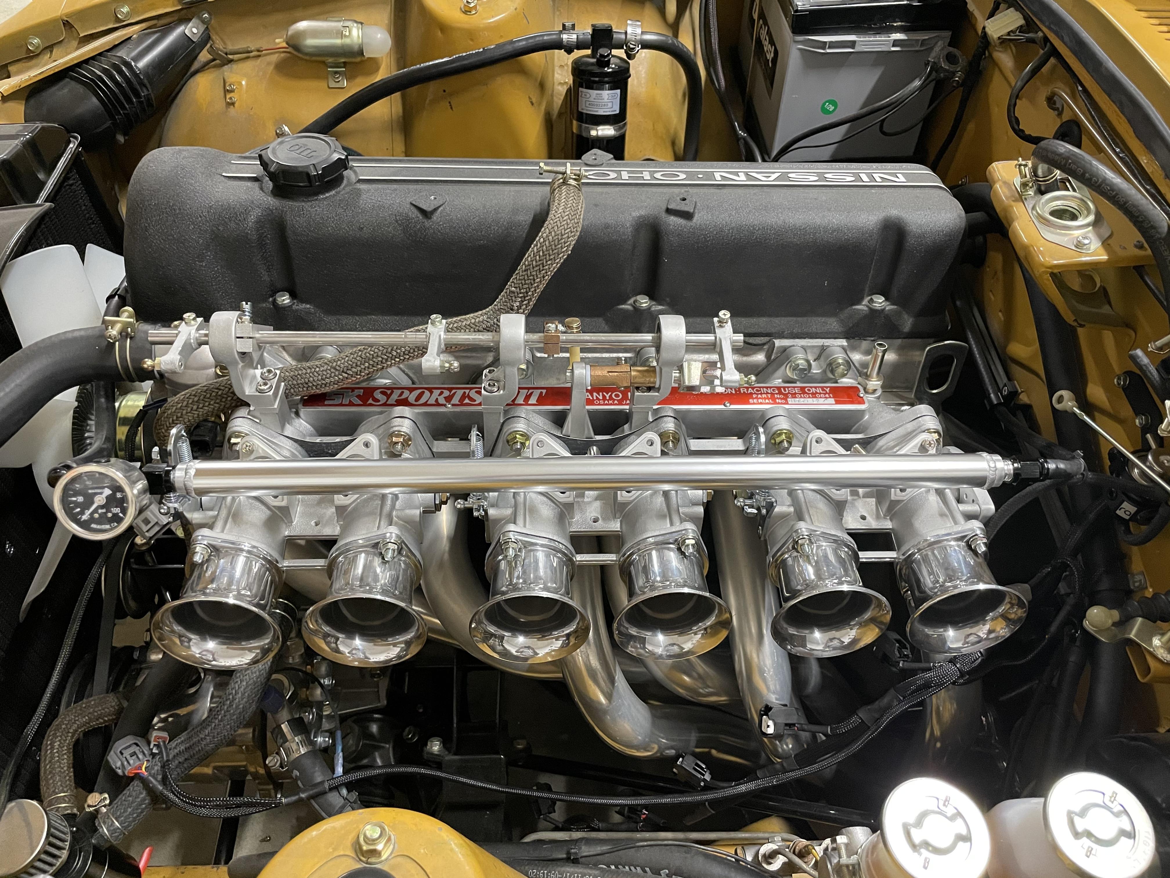

Next hurdle is a hidden vacuum log for my ITB. My SK one is proving too hard to hide.

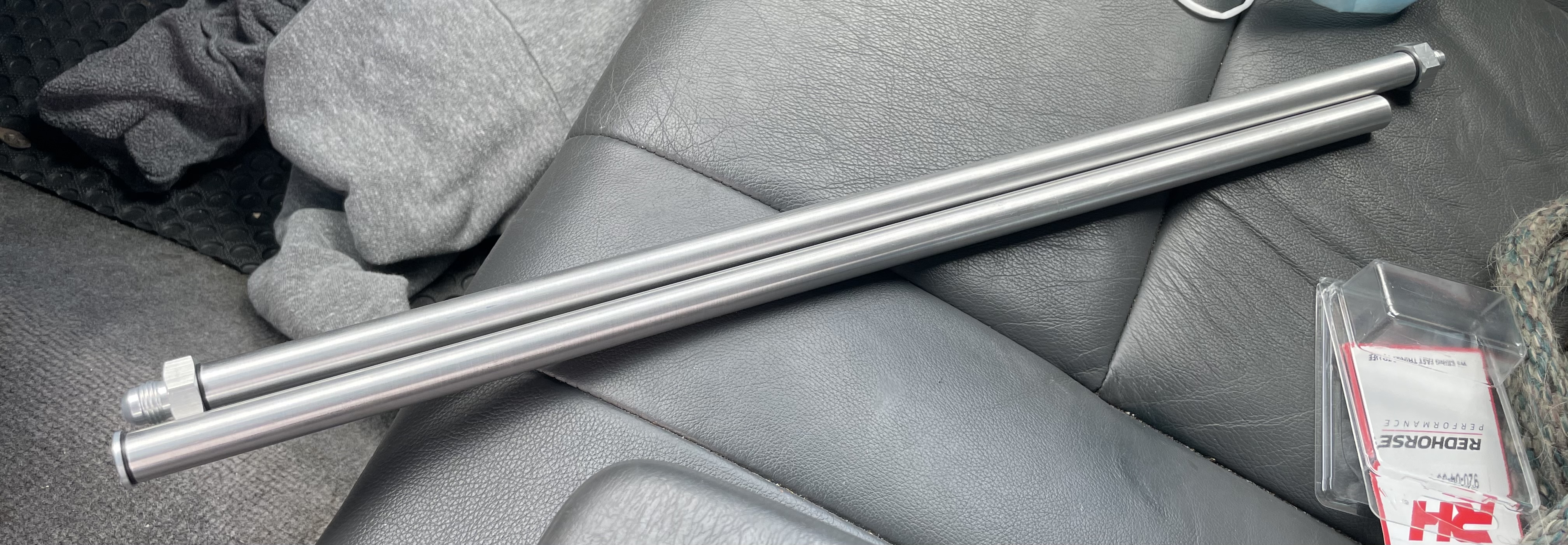

My plans for a billet clamp won’t work with the stock hardware. But a simple cushion clamp should do the trick. Next is welding 3x 1/4 hose barbs onto my 5/8 OD aluminum pipe. It’s been threaded to -6 orb on each end. With the plan to use iac at some point.
