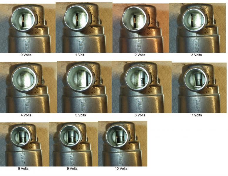

Well I am a liar. My wiring was wrong. Iac wasn’t even working. But it lets by 20% air or so with 0 volts. So this is cold start with 20% air going by. On my haltech  You can set voltage at a percentage of 0-12v. So roughly set the lowest voltage it can go to 33%. Should work, but to be determined.  I need to run a new DPO wire

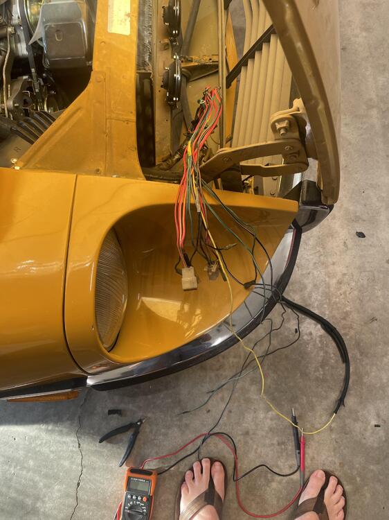

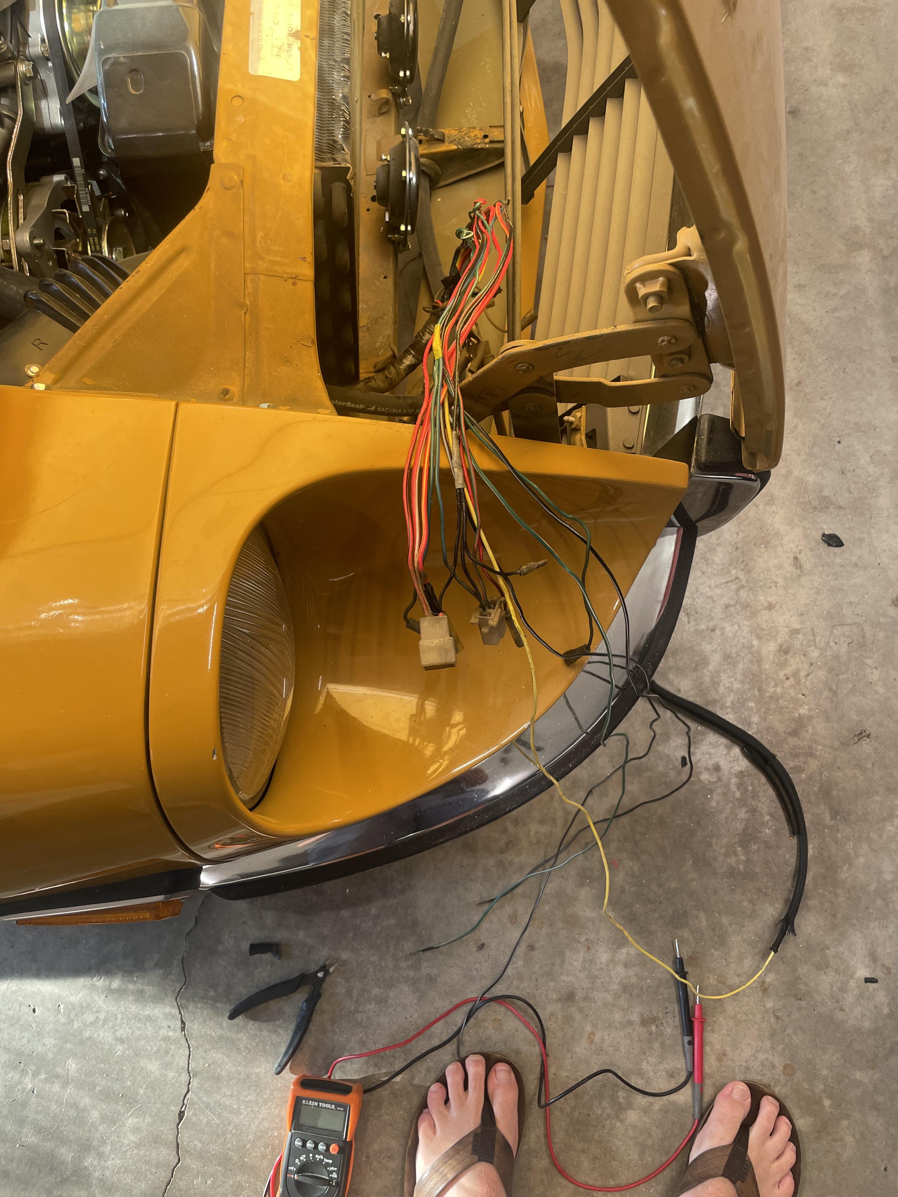

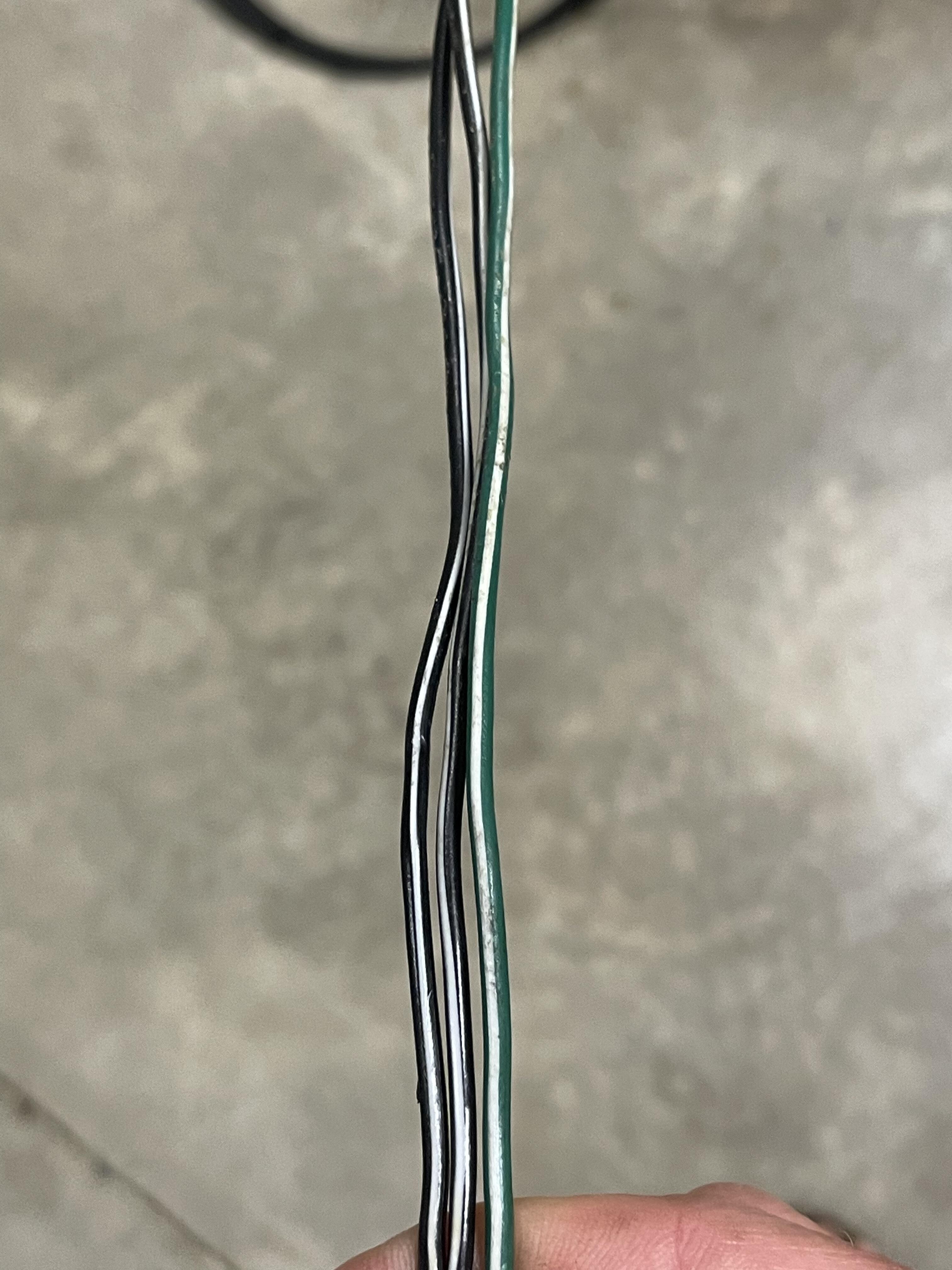

Both black/white and the green white wires show up in wiring diagrams. See attached for the highlighted path.
One black/white goes from the ignition switch to the ballast resistor.
The green/white lands on the other side of the ballast resistor and goes to the tachometer.
The other black/white comes out of the tachometer and goes to the coil positive.
If you think you have a short in the circuit, unplug the 4 wire connector from the back of the tachometer and lift one of the wires off the ballast resistor. You have isolated the wires from one another and can measure resistance to ground at each.
Ignition Circuit.pdf
Now that you have isolated the wire, disconnect the connectors between the dash harness and engine harness that have a black/white wire and re-test.
If you have taken the dash out of the car during the build, I would wonder if maybe pinched a wire or the wire harness in the dash harness.
Also look for previous owner modifications like a relay for a thermostat-controlled fan.
Both the other green and white and other black and white are not shorted.
I have never taken the dash out.
I will have to try and find the engine wiring harnesses connector.
