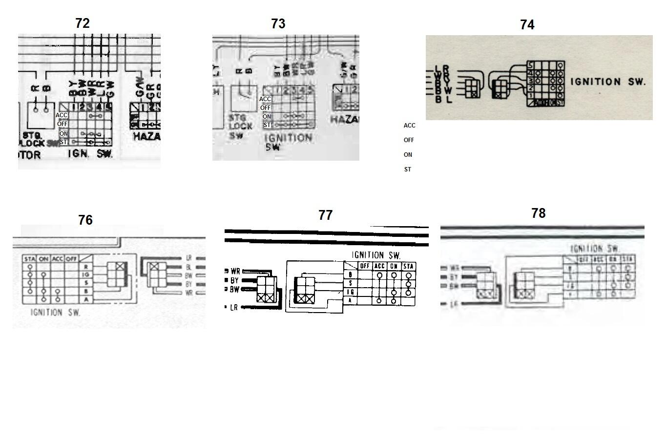

There was some discussion about such things a while ago, but I can't find the discussion. I remember that it happened because I created and posted this pic culled from the various wiring diagrams over the years:
The wiring diagrams seem to indicate that starting in 73, that B/W wire is hot in both ON and START, but in 72 it is not? And I don't have reliable wiring diagrams for 70 or 71, so I can't tell if 72 is just an anomaly. It always seemed like a documentation error to me.
Have you confirmed how it really works?

I remember seeing the post of the ignition switch wiring diagrams through the years. It's easy enough to verify on my 73. I just have to lift the solenoid wire off and have the turn signals on. If I have turn signals blinking while starting, then it has power while cranking.
The 70 FSM indicates it is not powered during start. The wiring diagram in the 71 supplement shows the same, and the 71 Body and Chassis Part 2 PDF matches.

So the BW is hot on that switch in start. Either D8700-E4629 is not faithful to the original design or the wiring diagram is wrong. Either way, I took the video Private until I can confirm so I don't muddy the waters with it.
