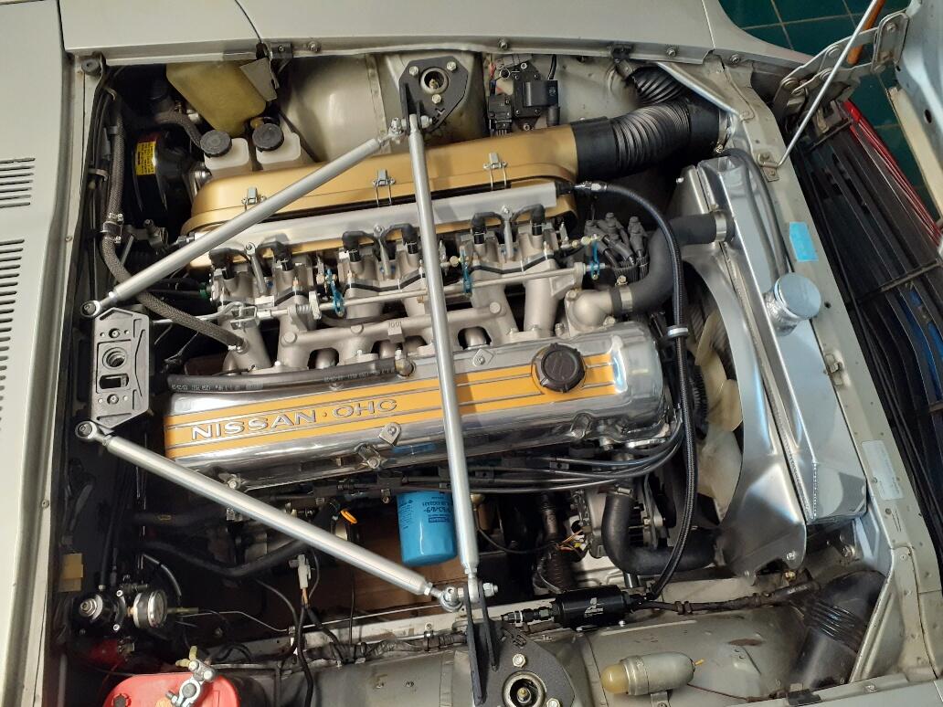

Running a air box for two reason, dirt and mainly heat. What you don't see in this pic is the 4" intake tube is now mounted to back side of the front grill. screen filter in the tube at the radiator brace and a 4" inlet turbo waterproof nylon screen at the front end of the tube (grill)
ITB horns are beautiful with chrome screens on the ends and  look awesome when the box is off but under hood temps can vastly exceed coolant engine temps. My intake air sensor  (mounted at the front end of the box) reads constantly half of the coolant temp. 160 coolant temp, 80 air intake. It's not forced air but the air draw at speed from a 4" tube at the grill is cool and abundant.

Gorgeous engine bay! I can't cover my stacks, seeing them is part of my love for ITB.  On my list to do are the custom stack filters (like singer) and then a belly pan that directs fresh air to the horns.
50 is low here (maybe three days out of the year), went EFI to eliminate the choke and the warm up process.
