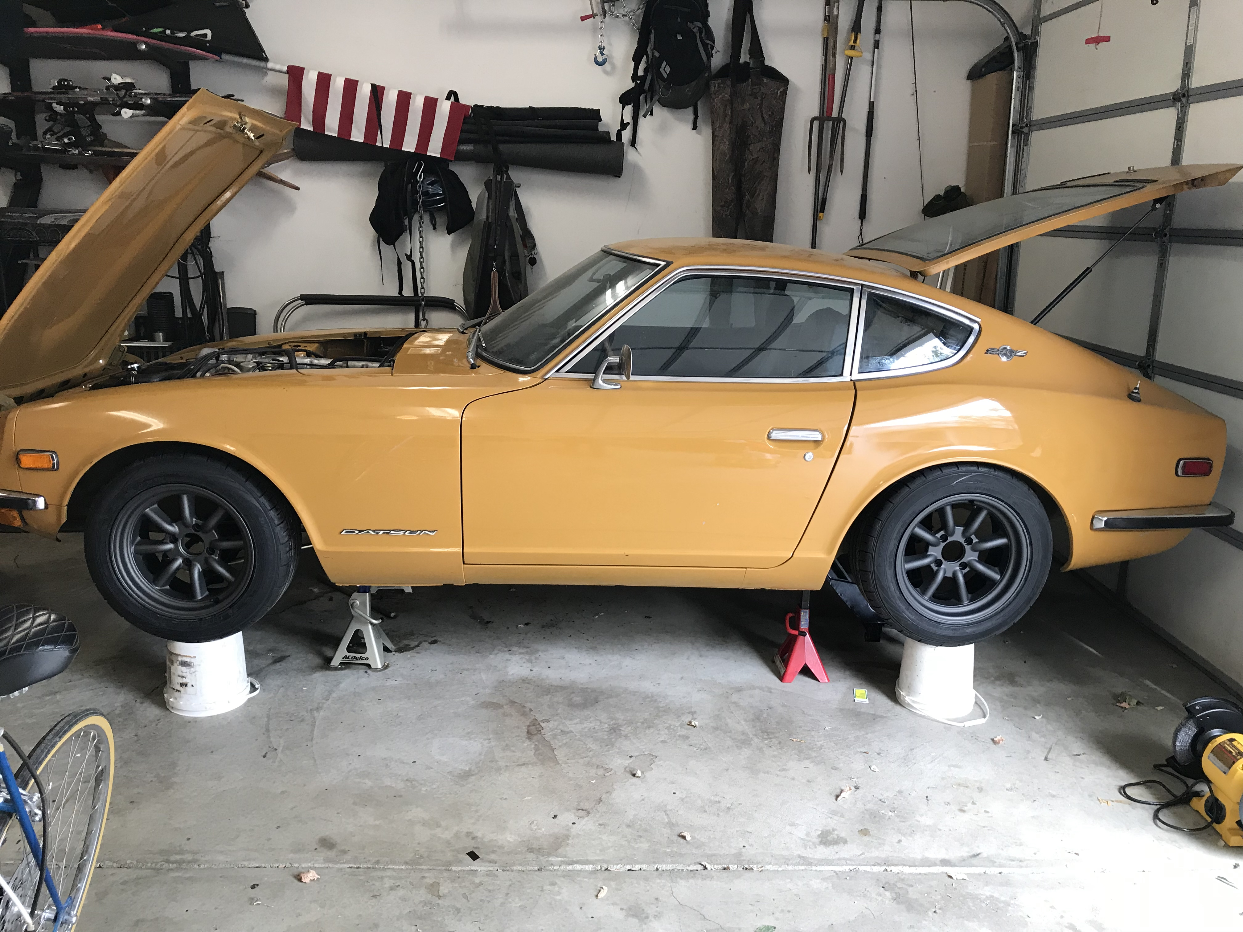

October 10, 20177 yr Author comment_532093 I got my 205/55 R15s mounted. They look a little goofy right now (too much side wall), but I bet when they are actually on they will look better. Link to comment https://www.classiczcars.com/forums/topic/58568-duffys-171-series-1-240z-build/?&page=8#findComment-532093 Share on other sites More sharing options...

October 10, 20177 yr comment_532101 ....I'm old school I guess..195/70/14 4 lug. I like the tall rubber filling the wheel well. Put new factory spec springs in and ride height is like it was " back then".Sent from my SM-T800 using Classic Zcar Club mobile Link to comment https://www.classiczcars.com/forums/topic/58568-duffys-171-series-1-240z-build/?&page=8#findComment-532101 Share on other sites More sharing options...
October 10, 20177 yr comment_532103 17 minutes ago, grannyknot said: DAMN that's fine looking car! Thanks! The even more amazing thing is that it's 47+ year old paint, bumpers, rubber, etc. She is spoiled and is typically kept in hibernation. Link to comment https://www.classiczcars.com/forums/topic/58568-duffys-171-series-1-240z-build/?&page=8#findComment-532103 Share on other sites More sharing options...
October 10, 20177 yr Popular Post comment_532107 4 hours ago, duffymahoney said: They look a little goofy right now (too much side wall), These are old classic cars and look better with some sidewall versus really low profile tires. Just my opinion... Link to comment https://www.classiczcars.com/forums/topic/58568-duffys-171-series-1-240z-build/?&page=8#findComment-532107 Share on other sites More sharing options...

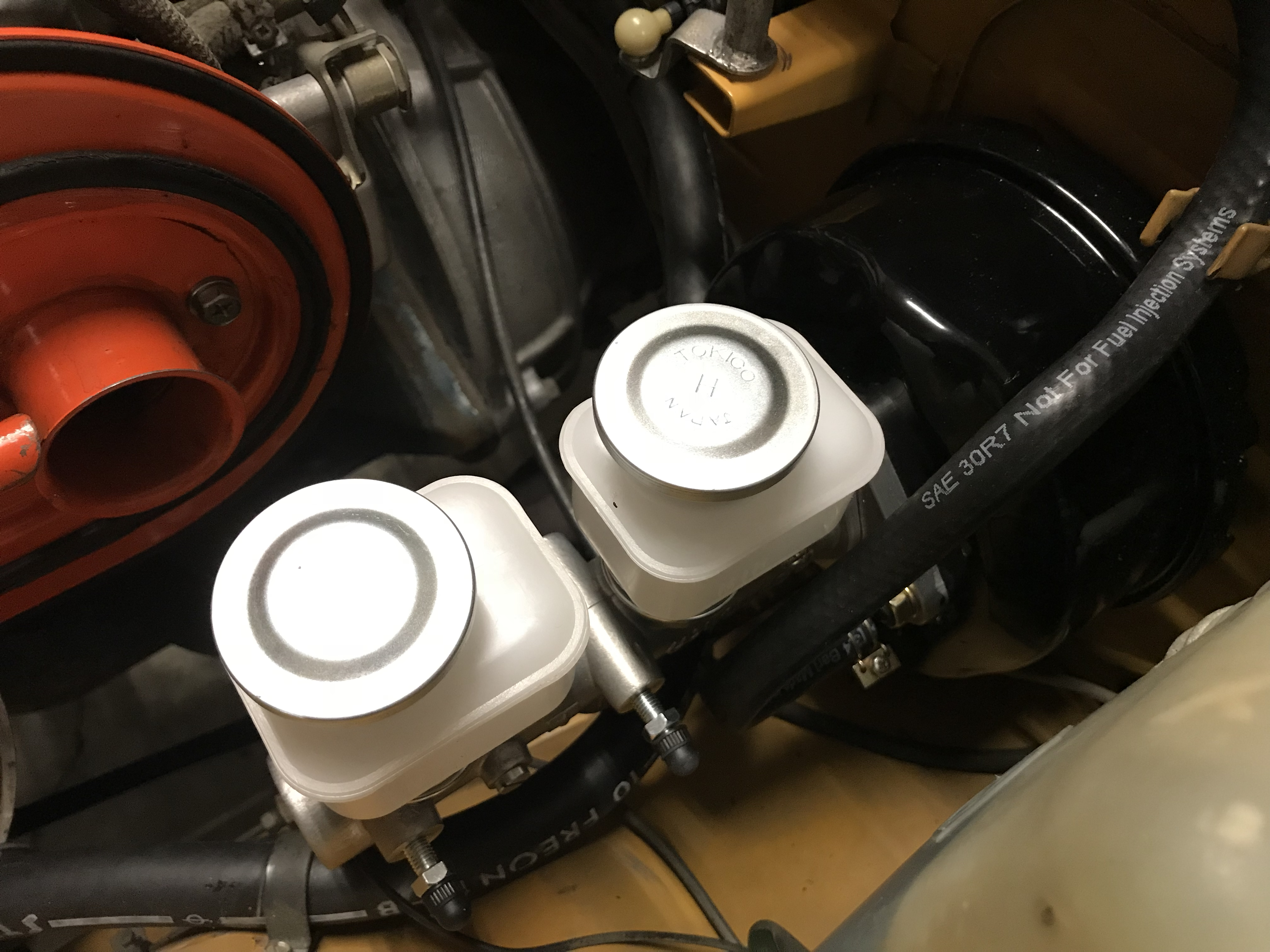

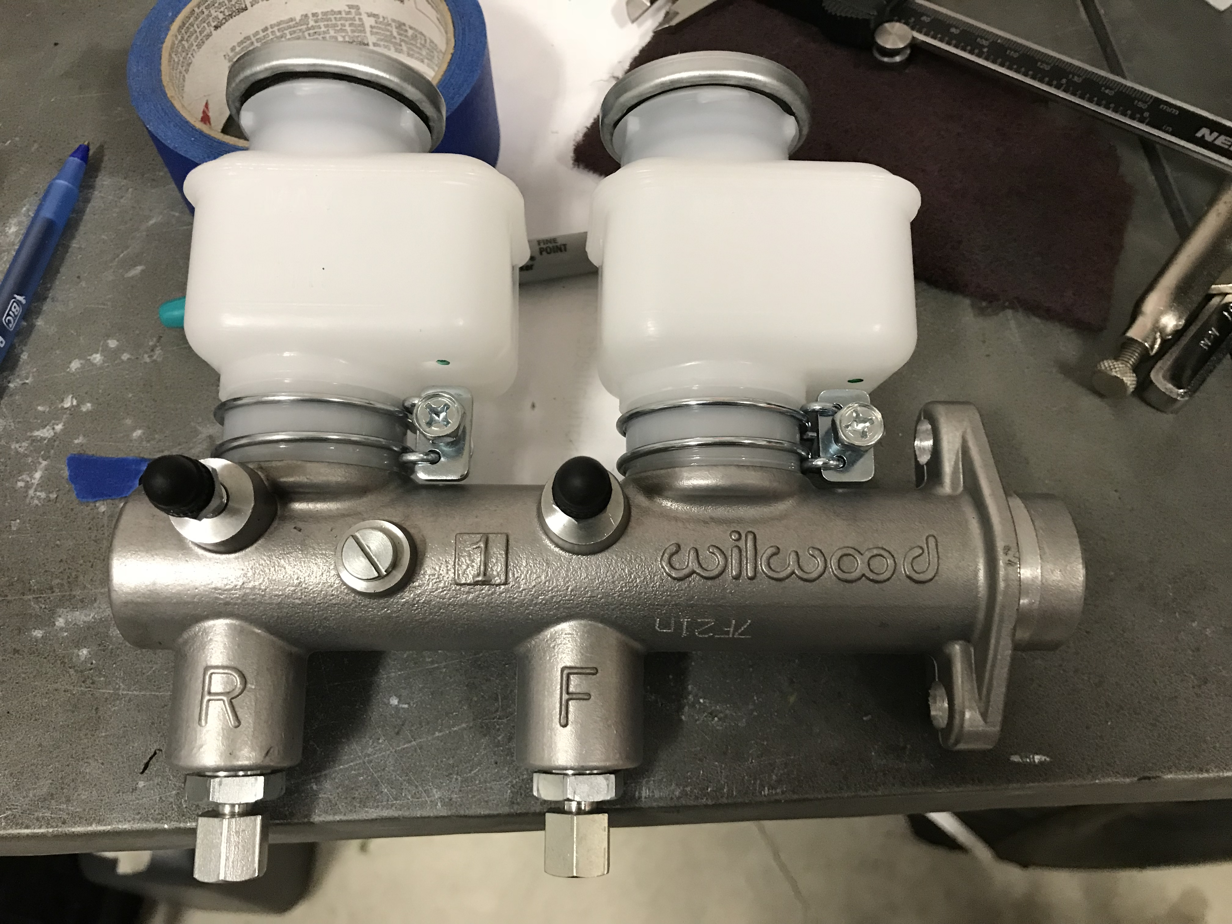

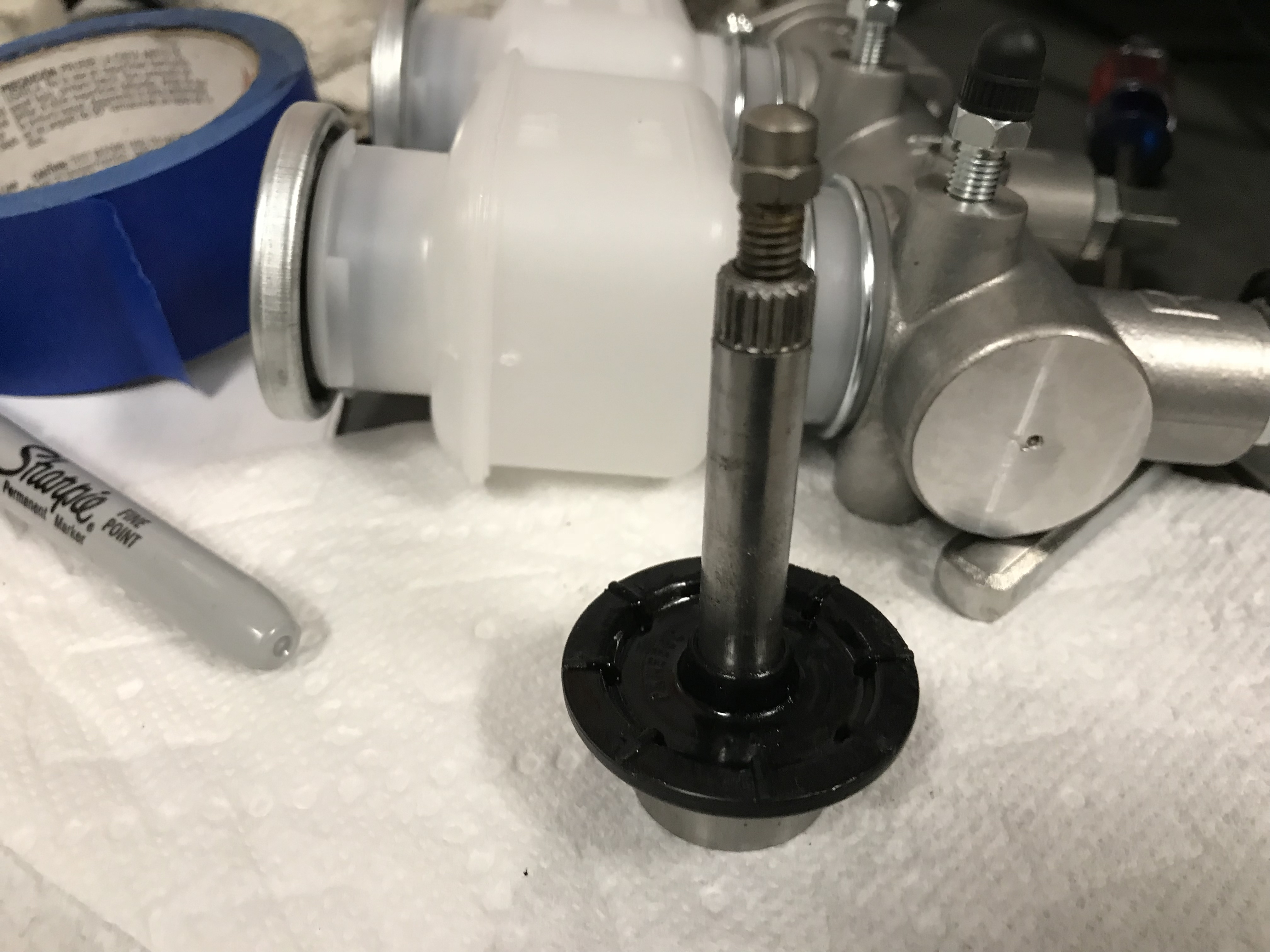

October 11, 20177 yr Author comment_532114 Well the wilwood 1" MC fits and the stock air cleaner can barely I mean barely can come on and off. You have to move the the bleeders to the other sides. I also set the pushrod around 8mm longer then stock, I ended up measuring the depth of stock and going off of that, this is because the wilwood is deeper. Now I just need to bend new lines and it should be ready. I got the unit off of california datsun, came setup for the z with fittings and drilled out. Link to comment https://www.classiczcars.com/forums/topic/58568-duffys-171-series-1-240z-build/?&page=8#findComment-532114 Share on other sites More sharing options...

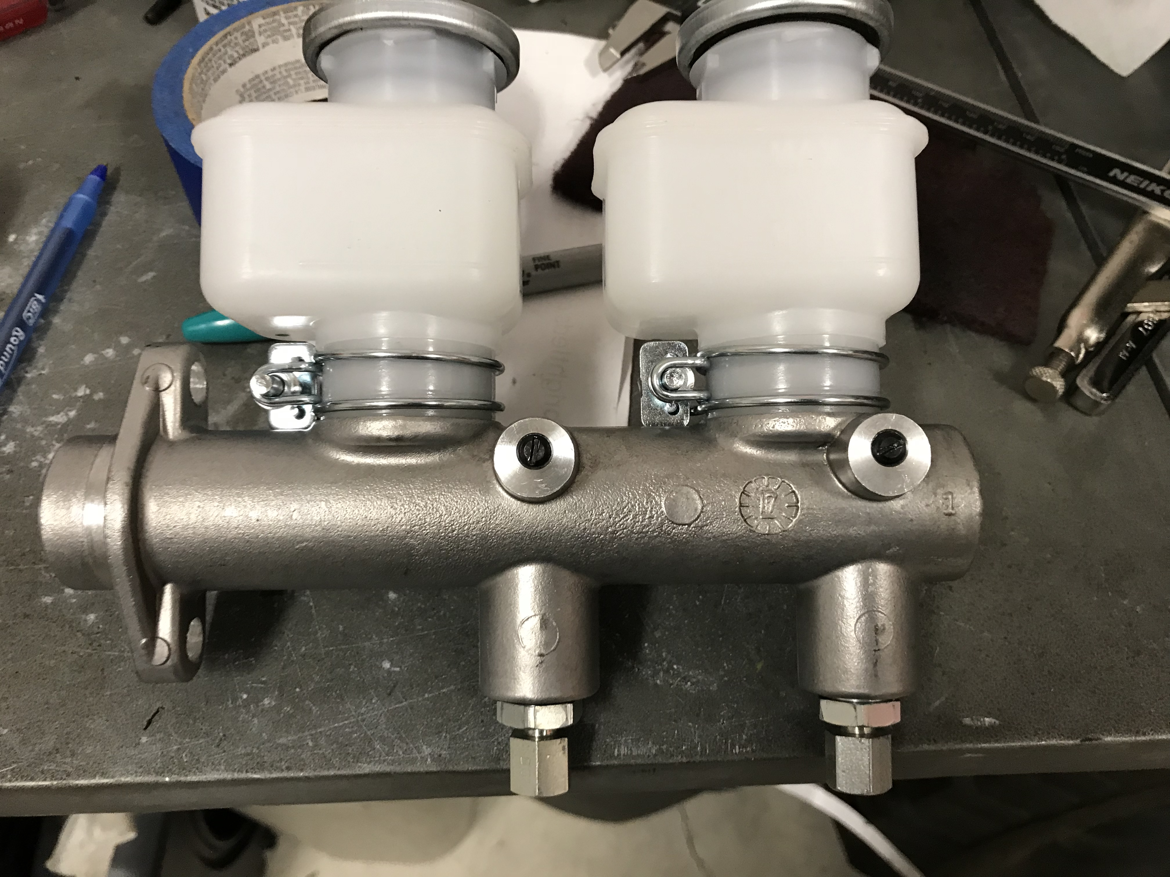

October 16, 20177 yr Author comment_532529 Since I have a series 1 the brake lines are reversed on the wilwood MC. So I had to buy lines and bend them. What a pain, they don't look great, but I was about to throw them in the garbage when I finally figured it out. I also removed some over spray and also cleaned up some wiring around the coil. Also got my fake wats star wars rogue squadron hub cap centers! Dorky, but I love them. Broke off the exhaust studs, tried welding to them, but my welds just break. I think my two options are either remove the manifold or drill and tap, if I can get them drilled out easily. Link to comment https://www.classiczcars.com/forums/topic/58568-duffys-171-series-1-240z-build/?&page=8#findComment-532529 Share on other sites More sharing options...
