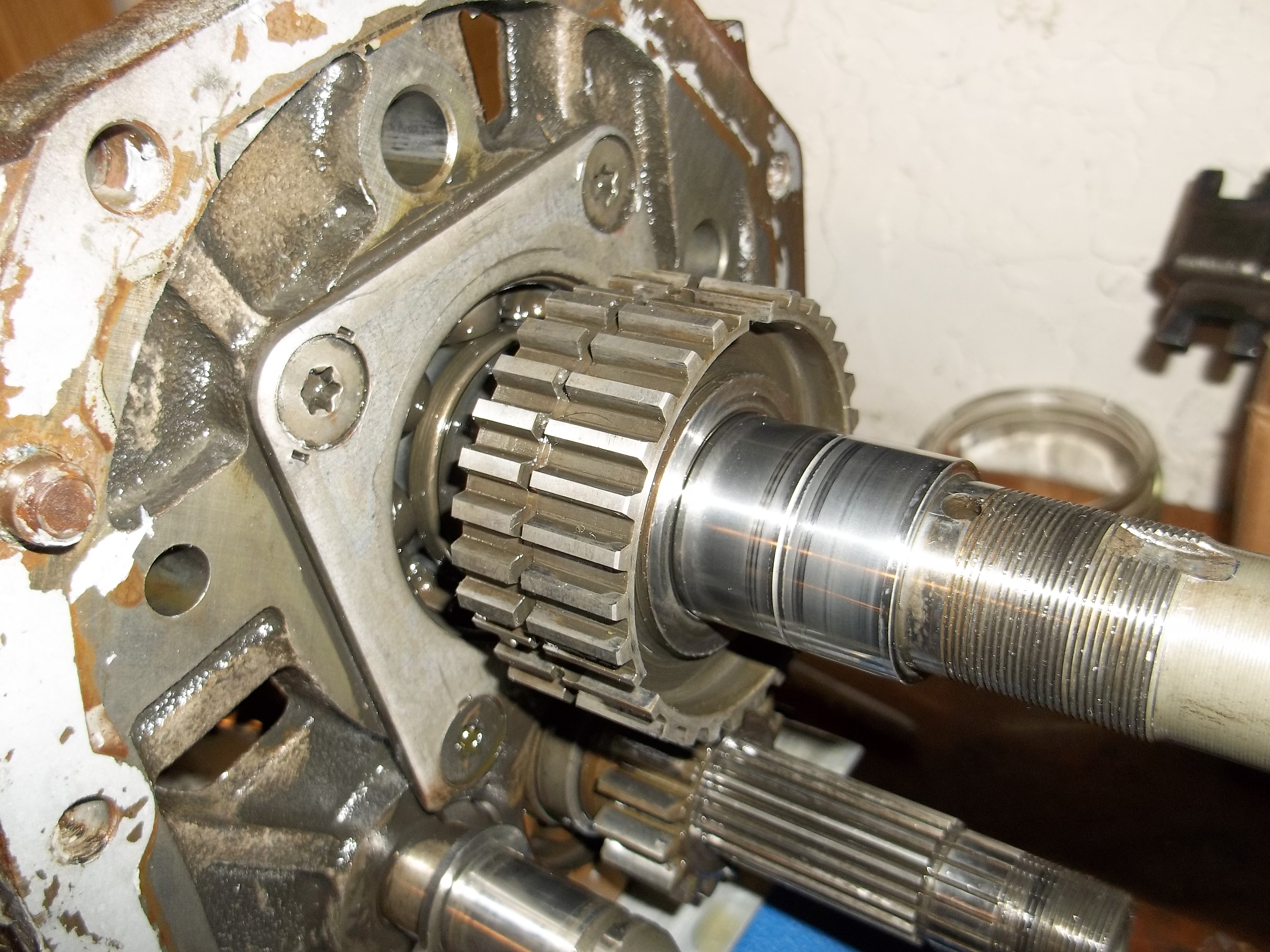

decided to start a clean thread. easy stuff remove bell housing and rear tail shaft housing removed shift forks, detent balls and springs snap rings and speedo drive gear and ball that retains it. reverse idler gear. rear counter shaft nut/gear OD gear, needle bearings balk ring. what is giving me problems is the OD sync hub, OD gear bushing. the bushing is not going anywhere. the manual says use a "suitable plate" behind the retainer and pres
