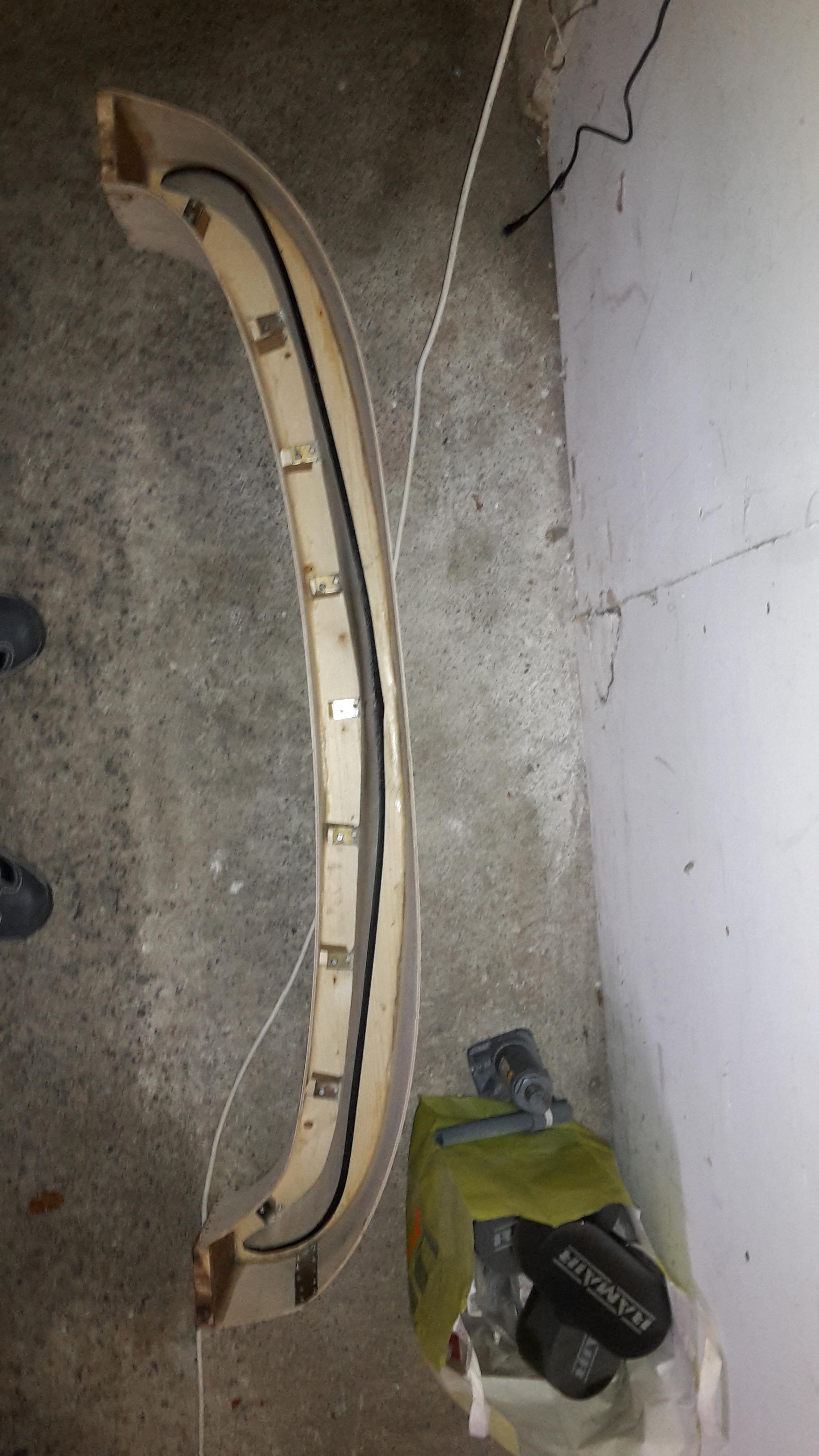

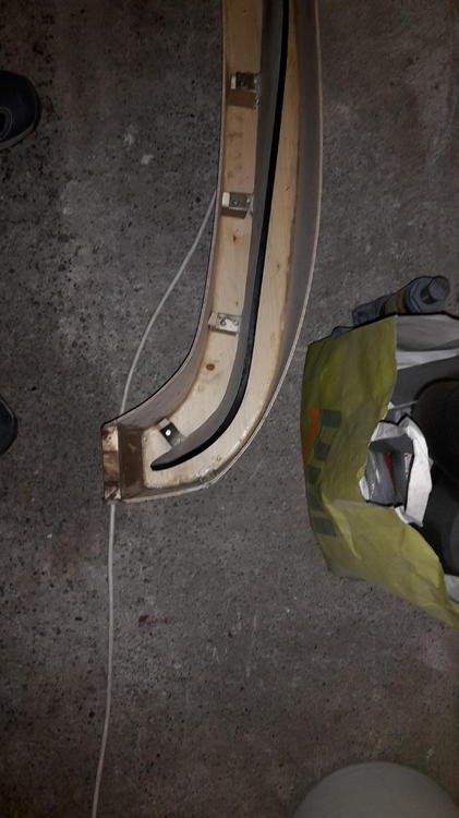

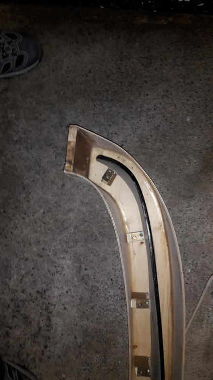

Next Step is done
Box with Prototype in it. fixed to the bottom of the box
Now I have to decide what kind of Polyurethane I will use. Im still for a Shore A 75 (hard/soft like Car tires)
I guess I will try it with that and if its not good, I can still do a second until I have the desired hardness.
For the Form(mold) I thought to use as well the Shore A 75 but Im asking myself if harder like shore A 90 could be better for the mold to reuse it more often
I know, the A75 should be good against UV light(sun) for about 10 years. then I can use the mold again.

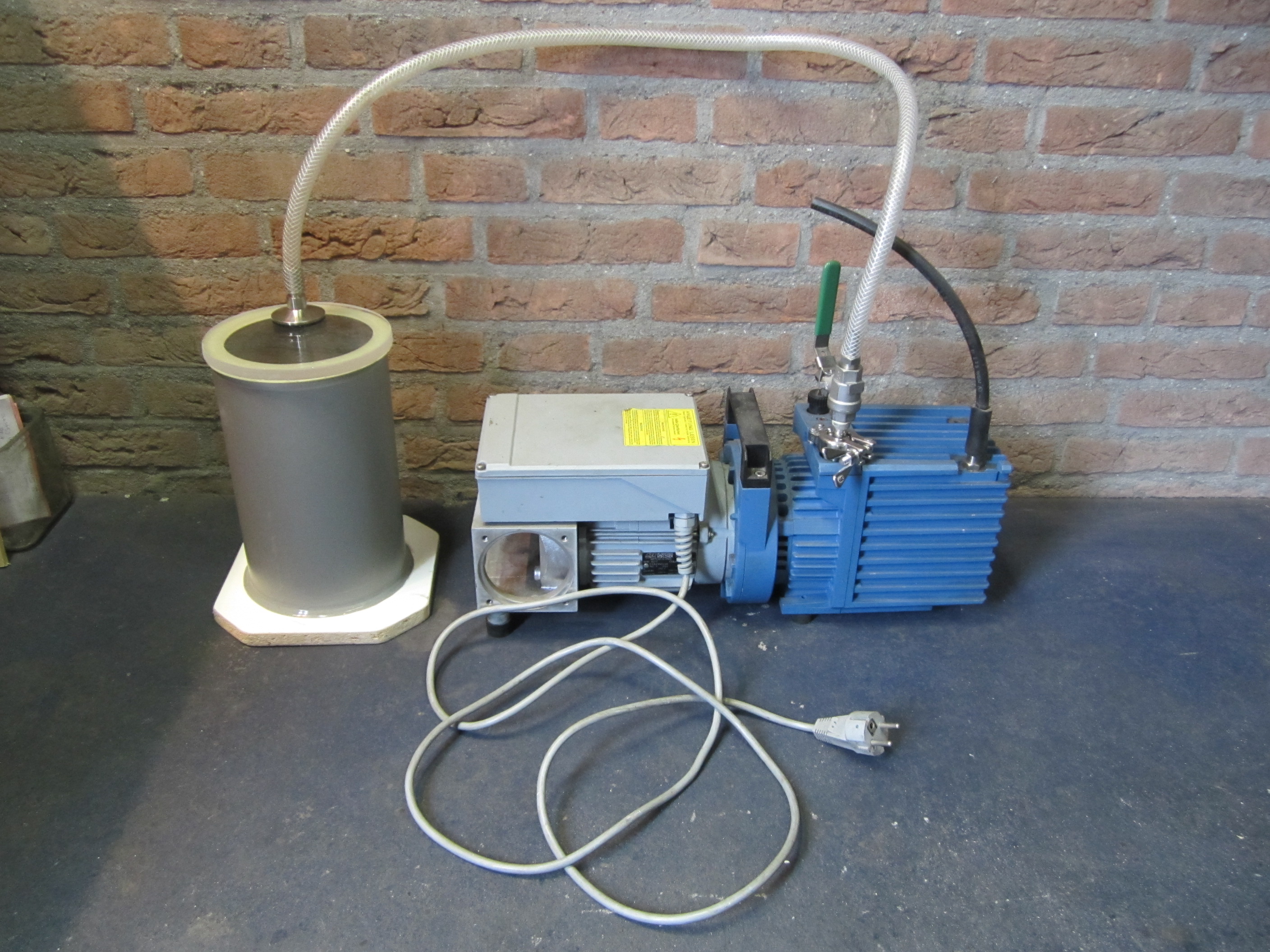

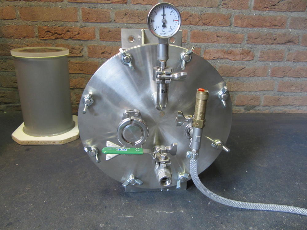

You will want a vacuum pump that will get close to absolute vacuum. 200mBarA will not be enough to get all the air out of 75 shore PU.
The container for the resin needs to be 4 times larger than the resin you are using otherwise it will boil over. 1 Litre resin = 4 litre container and a vacuum container to suit.

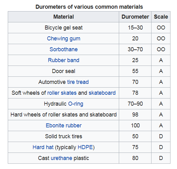

I've worked with polyurethanes of the A scale hardness, 80 to 95A range.  They're pretty soft.  Found a good chart in the Wikipedia link.  Of course, making some small samples would give a good feel for the final product, and would be good practice to iron out process difficulties.  It's not uncommon for molds to be destroyed because of poor release.
https://en.wikipedia.org/wiki/Shore_durometer#Durometer_scales

Hello Captain
Thanks for your inputs. Im braking my brain with what if then else questions...
I guess I will learn as you said. Yes, soft mold (shore A30) means easy to take it out, but needs always a box to use it.
Over Shore A50 no box is needed, but it will be harder to get it out. I tend to have it harder to get it out but easier to replicate.

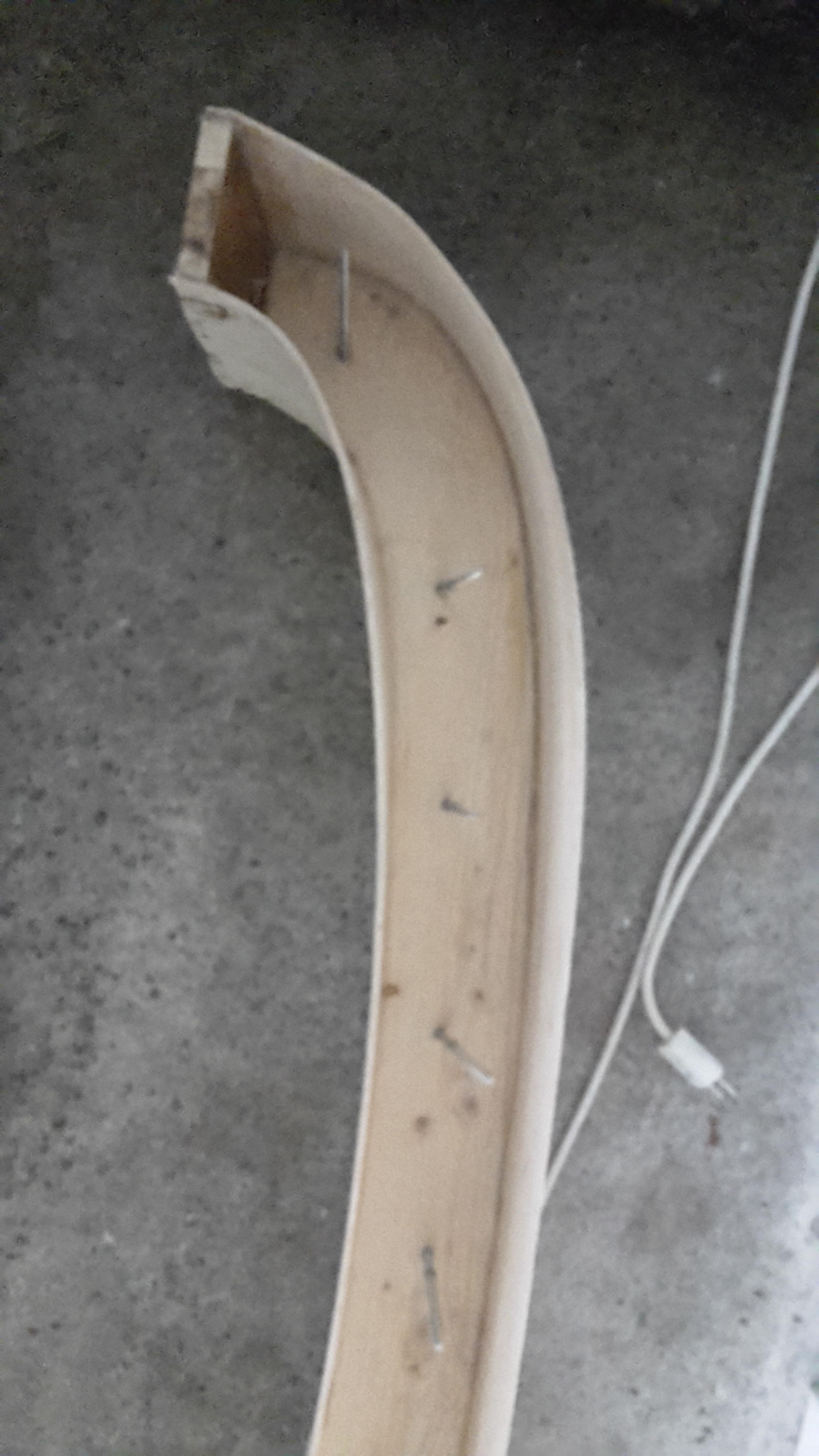

Below the Prototype are studs to the bottom wood and give marks where to open the mold
yes I will poor it at once I don't want a mark somewhere.
and where the studs are, (below every mounting bracket) I will putt pipes in the mold to get the air out  and to be able to "overfill"
(I will poor it the opposite side from the top to the bottom of the lip )
One will be used to pour it in. There I will use a 2cmx5cm pipe to fill it. when every pipe has material it should be fine.
I don't know yet if the center or the side is better, but I think the side.
Those are all the Ideas I have a t the moment and hope more knowledge will be shared. Here or with the guys I will buy the PU from.
The next few Days will give more ideas.
I got the first answer from the guy I buy the PU from and he suggests to use
1. Silicone Shore 28 for easiness but always a box needed to support the mold
2. Silicone shore 50 to 60. Still easier to use, but hard enough to use it without a box.
3. Polyurethane 50 to 60. a bit harder to use, not as precise texturing as Silicone but much cheaper.
The lip itself he thinks 80 would be good.
