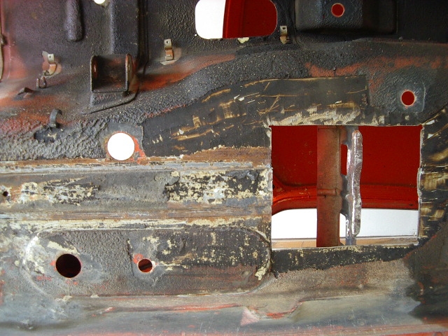

I have floor pans that I bought from Zedd findings, Charley Osborne makes a good product . I replaced the passanger side yesterday . I did the cutting and Scanlon did the pounding and fitting of the pan in prep for welding. I think the pans are first rate. I took pics of the floors before and after I cut out the rusted area but the before dosent show all the damage clearly and the ones with the installed pan havent been develouped , sorry I dont have digital. If you are wondering if the pans are as advertised they are ! They need to be fitted in place and some cutting and forming is necessary . I cut out the old with a sawsall with a metal cutting blade. I recommend not cutting the floor out untill you have the pans in hand. the hardest part was removing the seat supports and saving them for reinstall. I used a spotweld cutter that I bought at the local auto parts store. the floors extend aprox 21/2" up the tranny tunnel and up the rocker side to the seam of the old floor , from the seam of the old floor at the front where it slopes up to about 3" up the back slope that is behind the seats. I bought the rubber pluggs also. I plan to replace only the pass. side and repair the driver's side as there were only a few holes to patch . all went so well on the pass. side I may just do it also. If y ou want some mor info send a e-mail

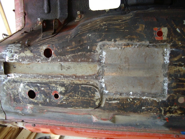

The rust I had looked almost like yours. I didn't know for sure until I removed all of the tar paper and cleaned it real good. I ended up only having to replace a 10" square under the seat support. I bought a couple of 12" x 12" x 18 guage pieces of sheet metal then just formed and cut. Here is the before picture.
