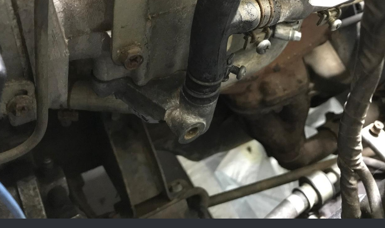

Posted October 18, 20177 yr comment_532700 Hopefully this is the right board for this thread, my apologies if not(also, forgive me for making my first post a "help me" post!) I have a 1977 Z I have been working on getting running, I'm at the point where my focus is on the engine. Unfortunately, I've hit a wall because of an issue with a constantly high idle. Sometimes the engine will start at around 2000-2200rpm and slowly climb until it settles at around 2500-2600, other times its immediately at 2600rpm. The AFM and throttle body move smoothly, and nothing is clogged/sticking inside of either. Throttle response is pretty sharp for what its worth, even at this extreme idle. I have a few thoughts as to what it could be, but I feel like I need some fresh eyes on the problem before proceeding. I have removed and blocked off the BCDD(it was the smaller, later model one) and this, if anything, made the car idle HIGHER. There is a three way rubber hose going to the BCDD housing (picture: https://i.imgur.com/12SzCHs.jpg) that I didn't remove, would removing this make a difference? A bizarre issue I've noted is that, sometimes, if I tap on the ECU, the engine will idle down to around 1000RPM, but it will also run SUPER rich. I believe the car is running rich even while idling high, but it becomes very noticeable after tapping the ECU. Could an ECU fault cause the car to idle high? I haven't had the opportunity to check my cars fuel pressure, could a bad pressure regulator cause a high idle? One of the biggest issues I'm currently facing is that the engine is from a 280ZX(F54 Block, P79 Head). Unfortunately, I have no knowledge of if this engine ever idled correctly while in the car, and it appears as if the PO just threw the engine into the car without swapping any of the accessories from the original engine, as there are multiple sensors and such with nothing on the wiring harness to connect to them. It's made it difficult for me (at least psychologically) to reference the 280Z service manual due to differences between the two engines. I also believe that, due to the nature of this engine swap, a few vacuum lines may have been reattached in creative places. I've been having trouble finding a vacuum diagram for the engine to confirm this, however. To my (inexperienced) eye, many of the vacuum lines check out visually, and I can't hear a vacuum leak, but are there any lines in particular that could cause an idle like this that I should check more in-depth? For what its worth, if I disconnect/plug this line (picture: https://i.imgur.com/r1ow9Hi.jpg), the car will idle at about 1000rpm. However, I feel like this is probably more indicative of removing a huge source of vacuum from the engine, rather than it being evidence of the problem coming from this area. I'm really unsure of where to turn next in terms of repairing this idle, so any help is greatly appreciated! Thank you! Link to comment https://www.classiczcars.com/forums/topic/58760-1977-280z-with-81-83-engine-persistent-2000-2500rpm-high-idle/ Share on other sites More sharing options...

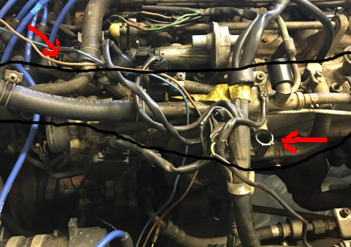

October 19, 20177 yr comment_532713 You can check for the stuck throttle blade by pulling up on the pedal with your foot or manipulating it by hand under the hood. There are two return springs, one on the TB itself and the other attached to the linkage. On the ZX engines I think that the linkage spring is very visible, right on top. I snipped ypur picture and drew an arrow to the spring and linkage, Make sure it's free and working right. Also arrowed the ZX idle adjustment screw. It works by letting a small amount of air past the throttle blade. If you figure out the excess air problem you'll still have the goofy ECU problem. That could be a loose connection or a bad ECU. Is it a ZX ECU or the original Z ECU? They're different. Should be next to your left foot, behind a panel. With a sticker on it that ID's it. Take a picture of the sticker. It's probably the Z ECU and they are known for failing like yours is, with the tapping it rich/lean problem. Link to comment https://www.classiczcars.com/forums/topic/58760-1977-280z-with-81-83-engine-persistent-2000-2500rpm-high-idle/#findComment-532713 Share on other sites More sharing options...

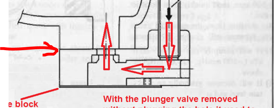

October 19, 20177 yr comment_532716 I suspect you didn't block off the BCDD correctly. As siteunseen alluded to above, it's not as simple as removing it and slapping a flat plate in it's place. I've not looked into the details, but I suspect the later ones under the manifold are pretty much the same concept as the earlier ones on the bottom of the throttle body. Do you have any pics of what you did there? Link to comment https://www.classiczcars.com/forums/topic/58760-1977-280z-with-81-83-engine-persistent-2000-2500rpm-high-idle/#findComment-532716 Share on other sites More sharing options...
October 19, 20177 yr comment_532720 The FSM picture looks pretty clean. It's probably where the hoses were connected. But you do also need a good solid seal on whatever blockoff plate you attach also. Link to comment https://www.classiczcars.com/forums/topic/58760-1977-280z-with-81-83-engine-persistent-2000-2500rpm-high-idle/#findComment-532720 Share on other sites More sharing options...
October 19, 20177 yr comment_532721 It's not that simple. You can't just remove the guts and slap on a simple plate. When you remove the guts, you remove the valve that seals one side to the other. I whipped this up to hopefully illustrate the issue: Link to comment https://www.classiczcars.com/forums/topic/58760-1977-280z-with-81-83-engine-persistent-2000-2500rpm-high-idle/#findComment-532721 Share on other sites More sharing options...

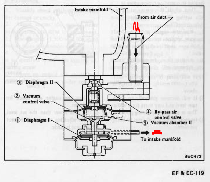

October 19, 20177 yr comment_532722 I thought that the plate would go directly on to the manifold with all of the hose connections removed. But I think I see what you're showing now. Those hose connection is still there. Nissan shows an interface. I wonder if that piece can be removed and plated there. Link to comment https://www.classiczcars.com/forums/topic/58760-1977-280z-with-81-83-engine-persistent-2000-2500rpm-high-idle/#findComment-532722 Share on other sites More sharing options...

October 19, 20177 yr Author comment_532724 1 hour ago, Zed Head said: You can check for the stuck throttle blade by pulling up on the pedal with your foot or manipulating it by hand under the hood. There are two return springs, one on the TB itself and the other attached to the linkage. On the ZX engines I think that the linkage spring is very visible, right on top. I snipped ypur picture and drew an arrow to the spring and linkage, Make sure it's free and working right. Also arrowed the ZX idle adjustment screw. It works by letting a small amount of air past the throttle blade. If you figure out the excess air problem you'll still have the goofy ECU problem. That could be a loose connection or a bad ECU. Is it a ZX ECU or the original Z ECU? They're different. Should be next to your left foot, behind a panel. With a sticker on it that ID's it. Take a picture of the sticker. It's probably the Z ECU and they are known for failing like yours is, with the tapping it rich/lean problem. Return springs & linkages are free and going back into position the way they should. I'm fairly certain it's the original Z ECU, here is a photo of it so you can confirm: https://i.imgur.com/S9QH4wL.jpg 1 hour ago, Captain Obvious said: I suspect you didn't block off the BCDD correctly. As siteunseen alluded to above, it's not as simple as removing it and slapping a flat plate in it's place. I've not looked into the details, but I suspect the later ones under the manifold are pretty much the same concept as the earlier ones on the bottom of the throttle body. Do you have any pics of what you did there? I believe you're onto something. I did a simple block-off. From what I can tell, there's a piece that bolts onto the manifold(this is what that three-way hose is connecting to), and then the BCDD attaches to it. I took some photos of it, but they're not the greatest(please excuse this awful sealer work, this was an attempt to deal with a broken screw):https://i.imgur.com/6JtdOUY.jpghttps://i.imgur.com/JLtHK4z.jpghttps://i.imgur.com/4JrlKiy.jpg Worst of all, I managed to discover a hole in this plate I had no idea was there! https://i.imgur.com/Y67nTkt.jpg I must've had this covered from sealer and it failed after running the car some, I can't believe I would've missed this on reinstallation. Zed Head also mentioned this, but could you just remove the piece connecting to the manifold and make a block-off plate for that, or would it be more in-depth? Thank you all for the responses! Edited October 19, 20177 yr by interestingusername Link to comment https://www.classiczcars.com/forums/topic/58760-1977-280z-with-81-83-engine-persistent-2000-2500rpm-high-idle/#findComment-532724 Share on other sites More sharing options...
