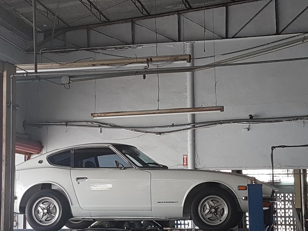

I can give a pic this weekend. I just got the tires mounted this week so this is all I have for now:
0xp9ZeL.jpg?1
