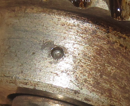

November 2, 20177 yr comment_533968 It looks like the shaft might be off a tooth. It should rotated clockwise a few degrees. Are the cam gear and damper showing TDC? 29 degrees total advance is fine. The staple looks like a wire from a wire wheel.ChuckSent from my Moto G Play using Classic Zcar Club mobile Link to comment https://www.classiczcars.com/forums/topic/58858-cant-get-timing-to-less-than-25-degrees/?&page=2#findComment-533968 Share on other sites More sharing options...
November 2, 20177 yr Author comment_533972 14 minutes ago, cbuczesk said: It looks like the shaft might be off a tooth. It should rotated clockwise a few degrees. Are the cam gear and damper showing TDC? 29 degrees total advance is fine. The staple looks like a wire from a wire wheel. Chuck Sent from my Moto G Play using Classic Zcar Club mobile Cam sprocket notch is lined up with groove in the pic. I guess I could pull the oil pump to verify and re-clock. Howard Link to comment https://www.classiczcars.com/forums/topic/58858-cant-get-timing-to-less-than-25-degrees/?&page=2#findComment-533972 Share on other sites More sharing options...
November 2, 20177 yr comment_533973 I think it's off a tooth. But as long as you know it and can set the timing then why bother? My race car is off a tooth but the timing is where I want it and I'm tired of making oily messes to remove the oil pump. My OCD is losing this battle...for now. ChuckSent from my Moto G Play using Classic Zcar Club mobile Link to comment https://www.classiczcars.com/forums/topic/58858-cant-get-timing-to-less-than-25-degrees/?&page=2#findComment-533973 Share on other sites More sharing options...

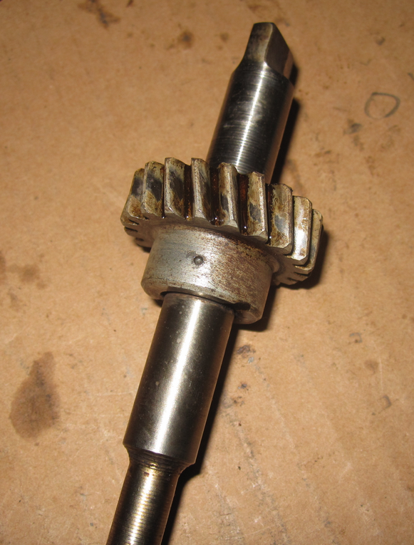

November 4, 20177 yr comment_534135 Hope your fingers don't get tired or cramped... I didn't post it earlier but the gear on the oil pump is apparently a press-fit. They've been known to slip. There are stories about the gear slipping upward, causing the distributor drive slot to lose contact with the drive tang, or just spinning a bit and screwing up the ignition timing. Something to consider if it changes again. http://forums.hybridz.org/topic/115353-l28et-issues-oil-pump-shaft-gear-spun/ Link to comment https://www.classiczcars.com/forums/topic/58858-cant-get-timing-to-less-than-25-degrees/?&page=2#findComment-534135 Share on other sites More sharing options...
November 4, 20177 yr comment_534139 All of the oils pump/distributor shafts that I've seen have the gear secured with a roll pin.ChuckSent from my Moto G Play using Classic Zcar Club mobile Link to comment https://www.classiczcars.com/forums/topic/58858-cant-get-timing-to-less-than-25-degrees/?&page=2#findComment-534139 Share on other sites More sharing options...
November 4, 20177 yr comment_534141 Just regurgitating stuff I've read, from people who seem to know. Maybe they all pinned theirs before you saw them. Here's another. http://forums.hybridz.org/topic/106792-slop-in-the-distributor-drive/ Link to comment https://www.classiczcars.com/forums/topic/58858-cant-get-timing-to-less-than-25-degrees/?&page=2#findComment-534141 Share on other sites More sharing options...
November 4, 20177 yr comment_534145 That's interesting. Most of my stuff is from 240Zs. Maybe the L28s were pressed on? I'll have to look at my spares. The two that were damaged, the replacement and my spare in the trailer are all pinned.ChuckSent from my Moto G Play using Classic Zcar Club mobile Link to comment https://www.classiczcars.com/forums/topic/58858-cant-get-timing-to-less-than-25-degrees/?&page=2#findComment-534145 Share on other sites More sharing options...
November 4, 20177 yr comment_534146 I'm tempted to go drop the pump on my seemingly all original 76 short block. It's just sitting there wasting space anyway. Link to comment https://www.classiczcars.com/forums/topic/58858-cant-get-timing-to-less-than-25-degrees/?&page=2#findComment-534146 Share on other sites More sharing options...
November 5, 20177 yr comment_534155 The locating dot/divot looks kinda like a pin, but it's just a shallow depression in one side of the gear body. Nothing on the other side. Edited November 5, 20177 yr by Zed Head Link to comment https://www.classiczcars.com/forums/topic/58858-cant-get-timing-to-less-than-25-degrees/?&page=2#findComment-534155 Share on other sites More sharing options...
