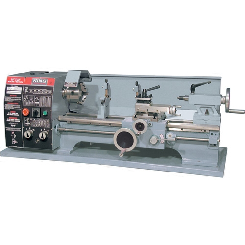

Is that new toy/lathe?
Congratulations, it looks nice and a lot smaller than the old ones.  I can think of some things I'd like to turn out but most likely cheaper at the belt buckle shop. :D
I don't want to go on the cart!
Seriously though...  I'm just a guy with a latte.  :beer:
Those diagonal holes aren't gonna be the easiest thing in the world to do. You'll soon be in the market for a milling machine. Slippery slope I tell ya!!

Drilling that hole through the center isn't going to be a huge amount of fun either. Sounds simple, but probably won't be as simple as it sounds on paper. They use a special cutting edge geometry for brass that isn't as grabby. You'll know what I'm talking about the first time the bit grabs and spins your chuck in the tailstock.  :D
You have a set of collets for the lathe? They lend themselves well to this kind of small, high accuracy work. It's nice to be able to work on one end, cut-off, and then spin the part around to work on the other end with pretty good accuracy using just a collet.
And your idea of making a block to help locate the holes is a good one. I do that kind of stuff all the time. I've got so many little special purposed fixtures around here that I've forgotten what some of the old ones were for!
I'm certainly no machinist, but you know how to reach me if you need a sympathetic ear!  :)
Thanks as always master machinist CO.  I had a quick look and young grasshopper will avoid the problem you mentioned :)https://www.youtube.com/watch?v=pAngKHIZgyA
No collets yet but I foresee them in the future.
