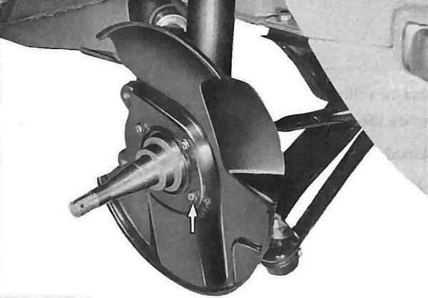

Speaking of brakes, seems I have some original stuff up front.
I know the slotted rotors (the old way!) have been discussed before, but check out these dust backing plates!! Don't remember seeing these before.
Look Ma, I'z got air flow cooling race parts on ma Datsun!
Tres cool find. You Albertans sure can dig up old dinosaurs!
I looked in FSM and now it finally pops out:
