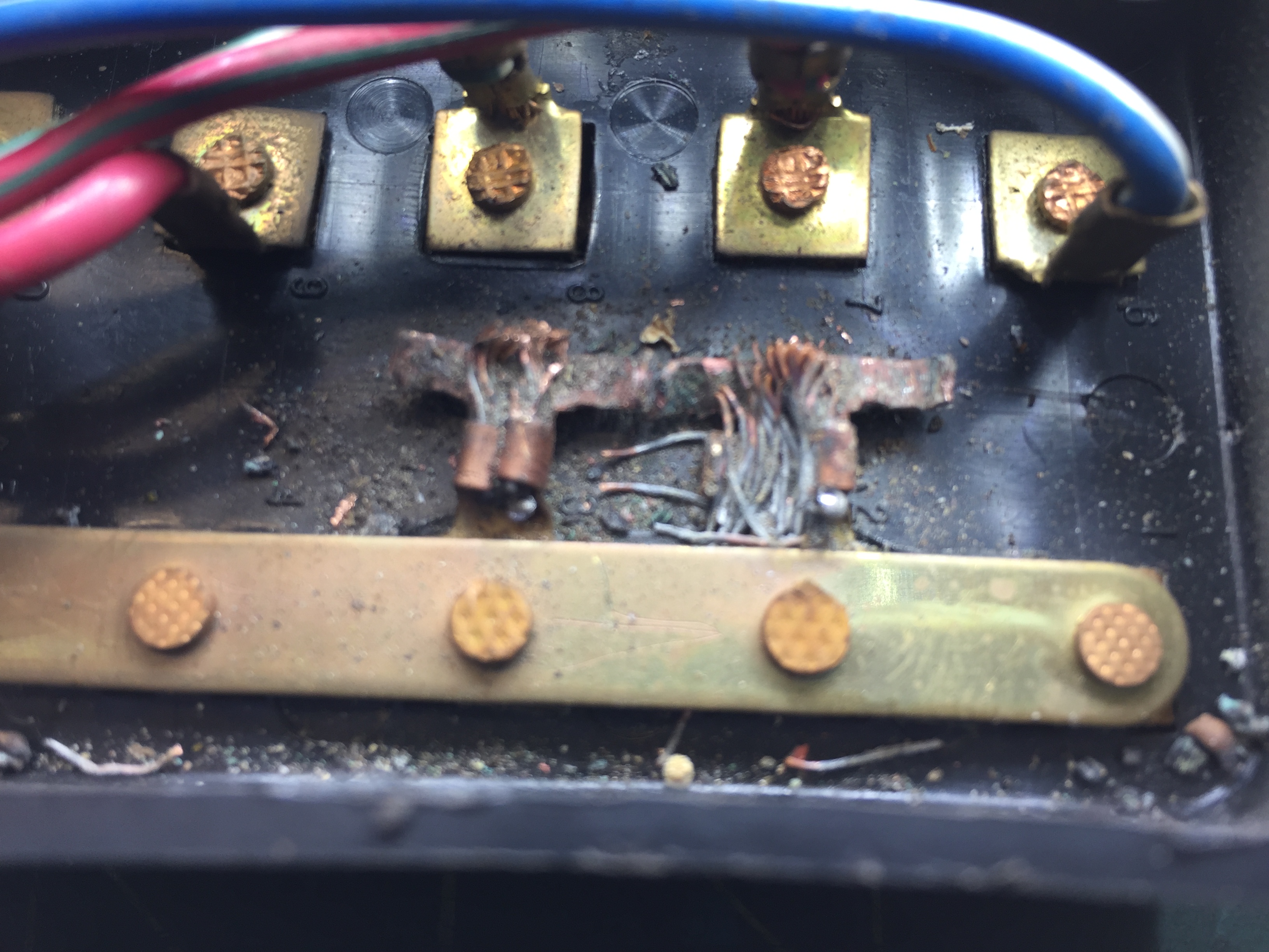

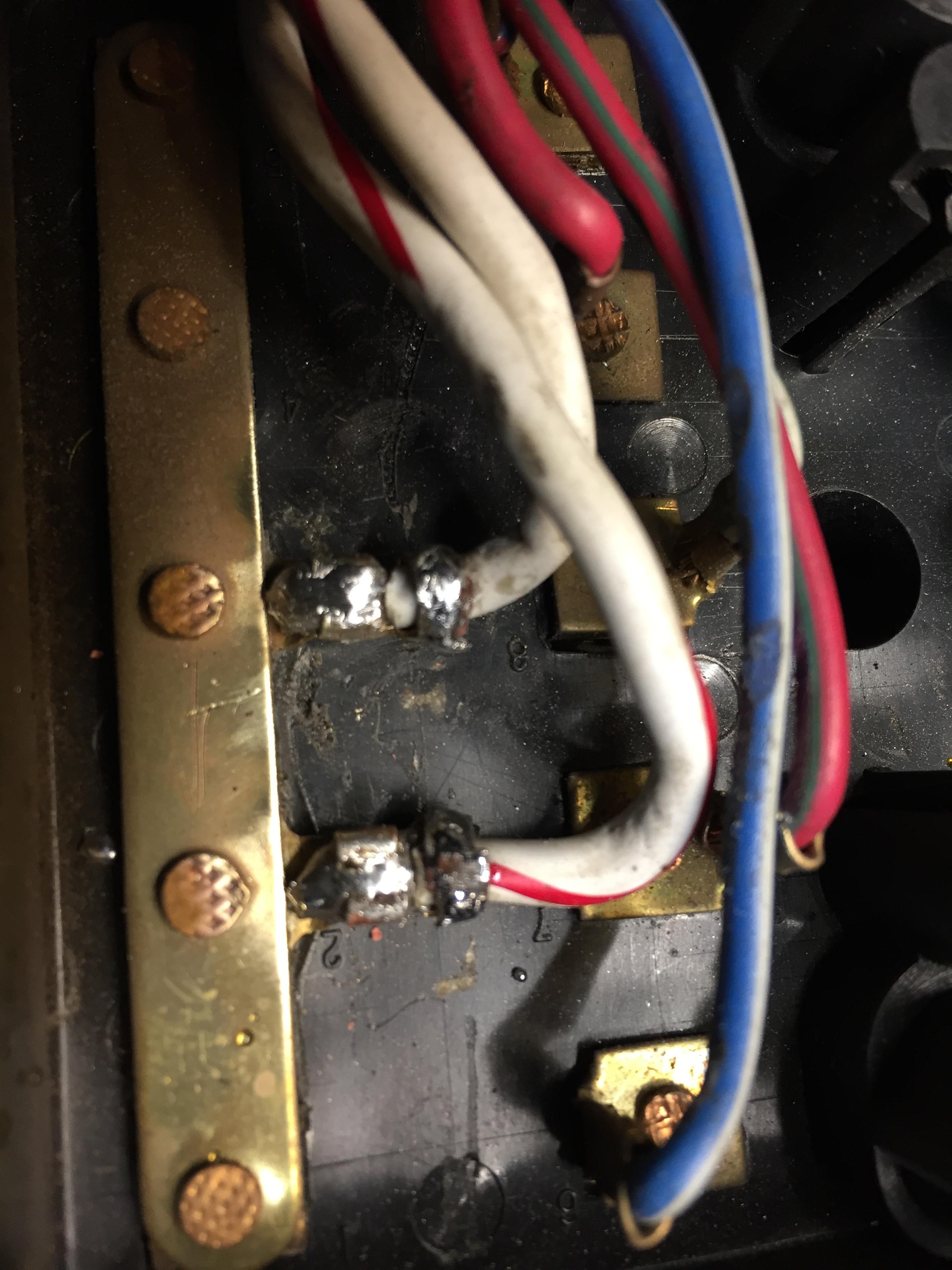

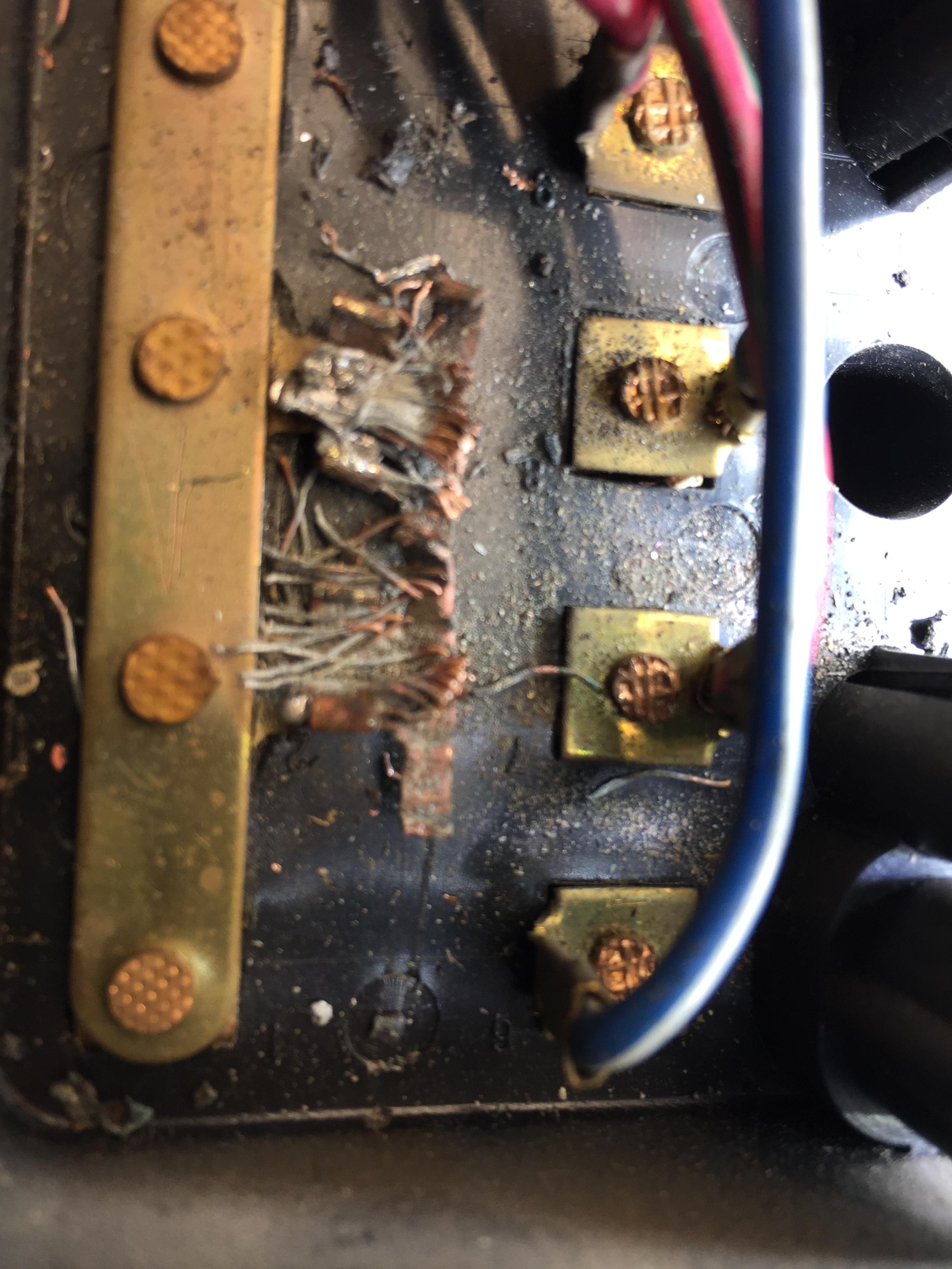

If any of you haven't experienced this electrical issue with Datsun's, let me show you something.
I need to clean and change some of the wires in the long-tail fuse box in this beast. The two 12 gauge white high current input wires needed new terminals on their ends, and appeared quite corroded where they were crimped onto the bus bar. So I decided to just change the wire.
When I opened up the crimps on the bar, the situation is much worse than it appears on the surface.
I had similar concerns over what I saw with those fat white and white-red wires in my 3xxx 70 Z.  Toasted, but not fried.  The challenging part is that the wire is rock-hard for about a half-inch inboard from the the connector and there's really no excess wire to let you just lop off the offending section and crimp on a new connector.  I've decided to just hold my nose and put in relays as 'triage'.  Also, I extracted all of the fuse terminals, c/w wiring, out of my 70 Z's fuse block and re-installed them in a good-condition block salvaged from my old 72.  It can be done.
Great photos, BTW... but not pretty. :unsure:
Without concern for originality, the "right" thing to do is install a new fuse block with modern ATC fuses ALA what MSA sells, or make a new one. Maybe a couple of more circuits so adding a couple of basic things isn't an effort in futility. I'm trying to get this thing reliable and mobile, restoration comes later. Maybe really later.
