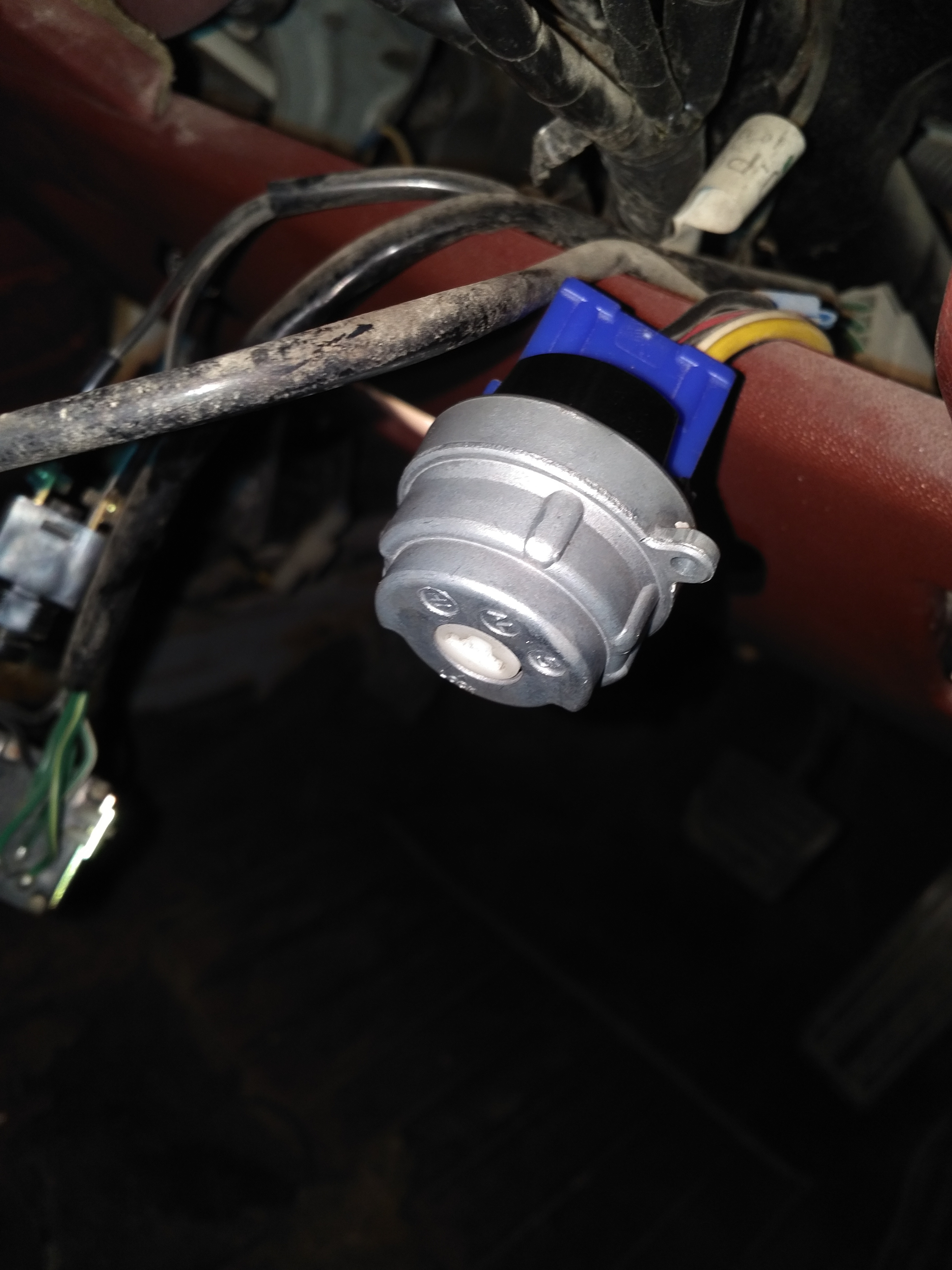

Are the ignition attached to the steering collumn some kind of important grounding point? I did put a wire between the minus pole and what's left of the ignition(attached img) just in case, didn't help.

The fuel pump only gets power when the engine is running, when the key is at Start, and, if it's working correctly, a 5 second stretch of power when the key is turned on.  It does not just keep running when the key is at On/Run.  You didn't hot-wire the car you just moved the ignition switch.
There are two fuel pump relays, one's called the fuel pump control relay and the other is called the fuel pump relay.  My impression has been that they're both metal but who knows.  There's a diagram and chart in the FSM, EFEC chapter.
Theft prevention devices have been around for a long-time.  I assume that colored blob picture is the back plastic-isch thing?  Can't really see any of it.

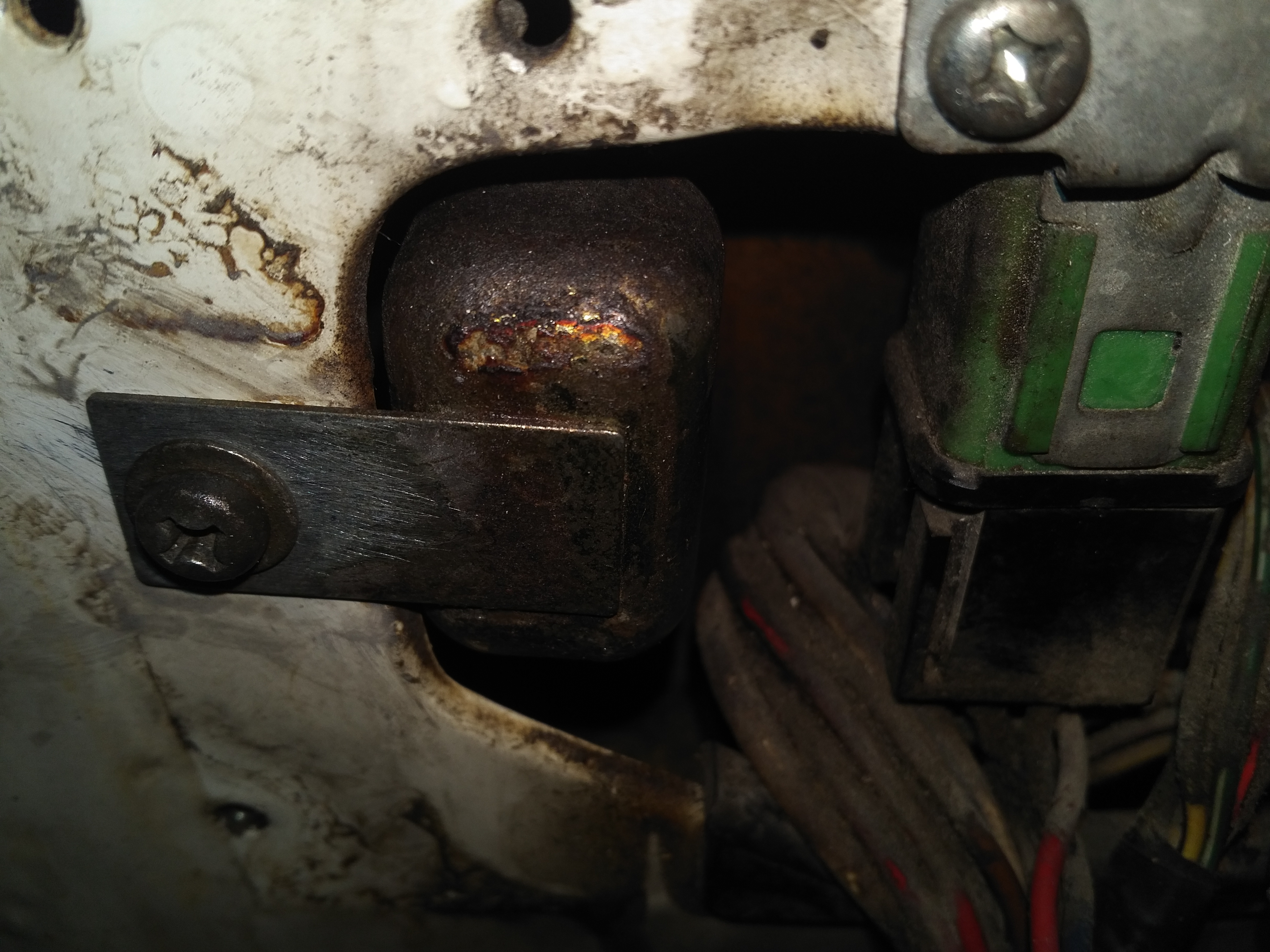

About the theft prevention, there’s this black thing where the key goes(attached img). Could this really be why the car won’t start? Feels a bit high tech for 1982..

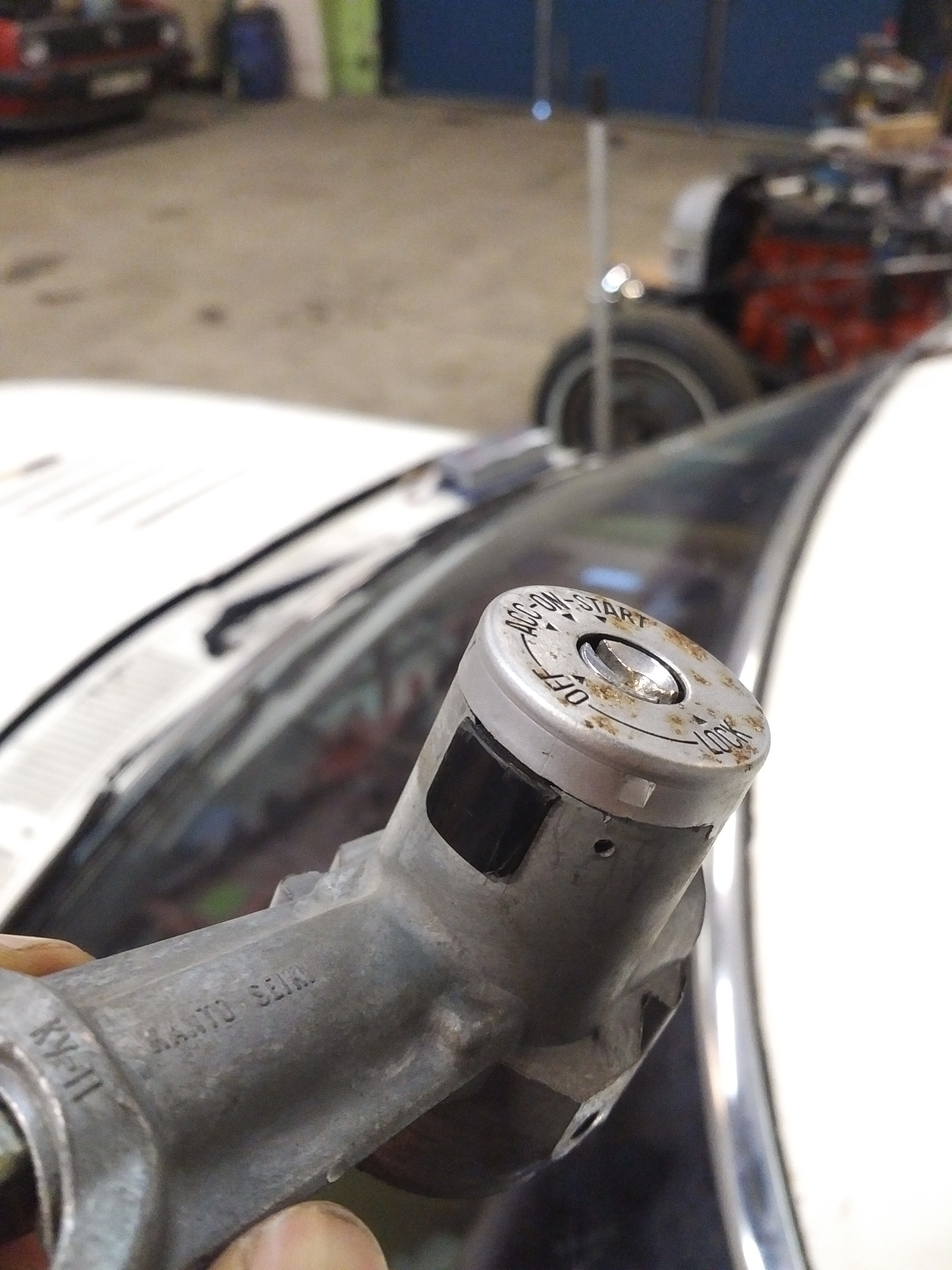

I'm assuming it still doesn't run.  Why is the ignition lock out?  Also have you tested the switch on the back of the lock to make sure that is good?  Wondering if it staying closed even when key is off.   You sure the key is really off?
The security feature is just a pin that goes into the steering column when the key is removed and steering wheel is turned a certain way.

No it doesen't.. The ignition lock is out because i don't have the ignition key, the lock has probably been replaced at some point. The switch that was on the back of the lock is still there as you can see on a img that I uploaded earlier, I just removed the lock så i could turn the ignition. So i can turn the switch with anything that goes in.
Oh, so the security is just the steering lock and nothing like a programmed key or anything? In that case i should be in the clear as the locks current placement are on top of the roof ;)
