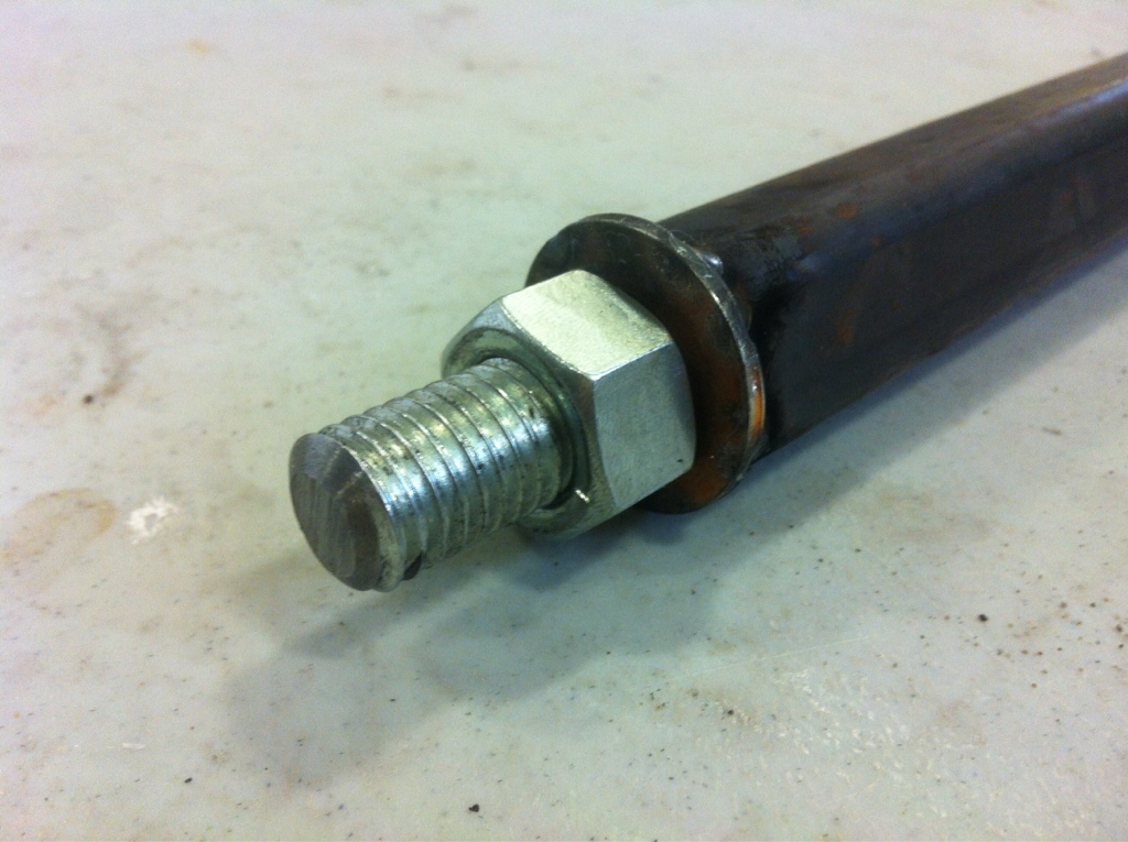

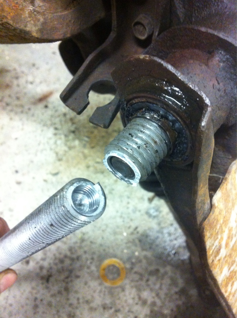

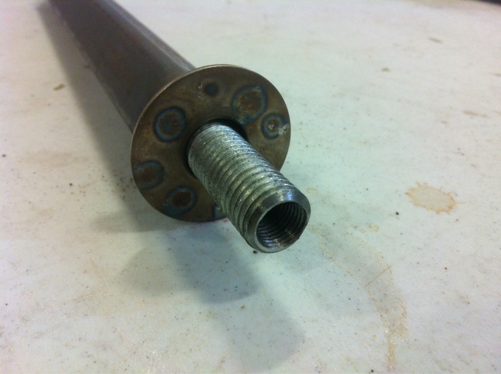

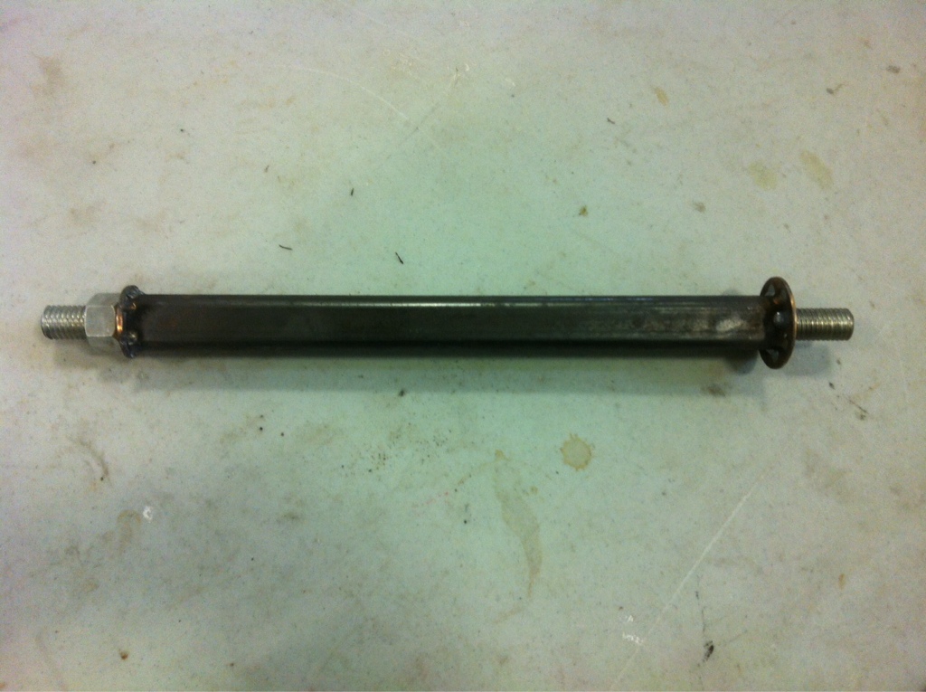

January 23, 20187 yr comment_540569 This was my attempt... the tool was simply not enough to break the force of the pin stuck in the spindle. No tool would have been in the end.... Link to comment https://www.classiczcars.com/forums/topic/58923-rear-spindle-removal/?&page=2#findComment-540569 Share on other sites More sharing options...

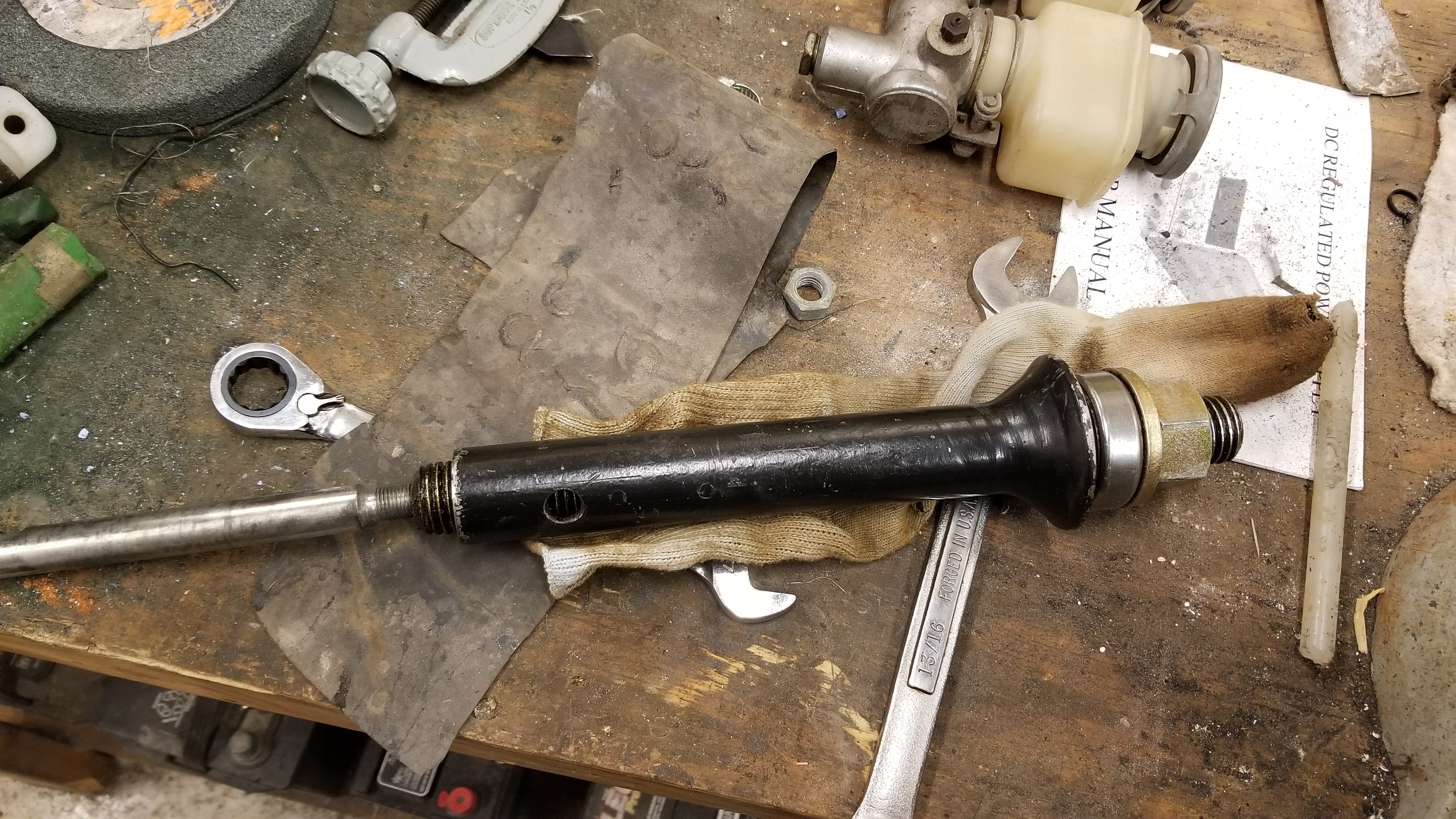

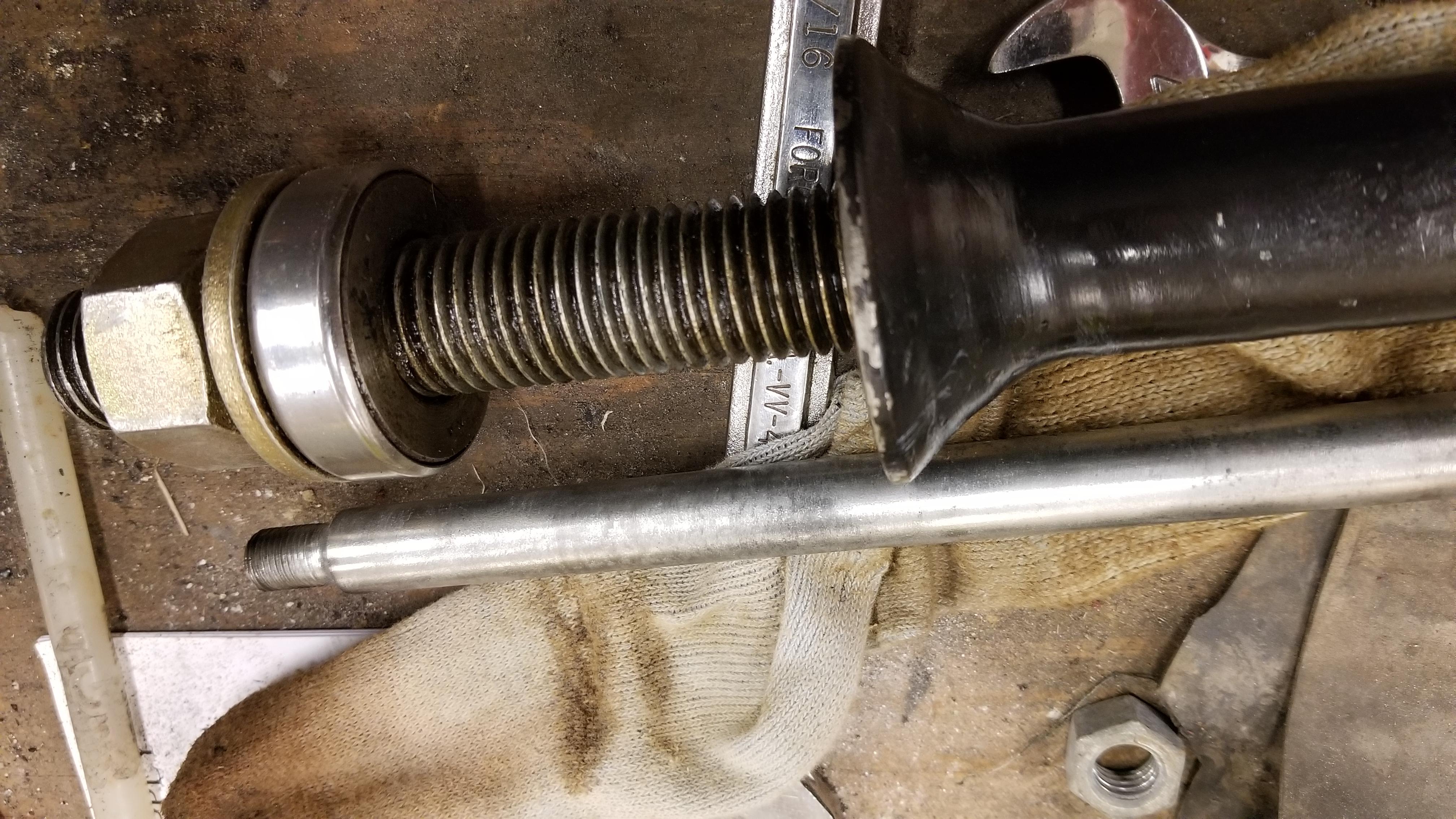

January 24, 20187 yr comment_540612 Here is my puller. I bought it from some one many years ago. He was making them for forum members. Might have been on Hybrid Z The all thread is 1" hardened rod. With a bearing to help with friction I haven't found one I couldn't pull yet. Even the ones I just separated that have been sitting outside for the last six years. I use wrenches to turn it so if it gets too difficult I fall back to heat and penetrating oils. I could see pulling the end off one being possible with this tool 8 hours ago, Travel'n Man said: I am installing coilovers in the next couple weeks. I installed new spindle pins a couple years ago and really hoping I put anti-seize on them! Keeping my fingers crossed for easy out and easy in Mitchell, Let me know if you need a loaner Link to comment https://www.classiczcars.com/forums/topic/58923-rear-spindle-removal/?&page=2#findComment-540612 Share on other sites More sharing options...
