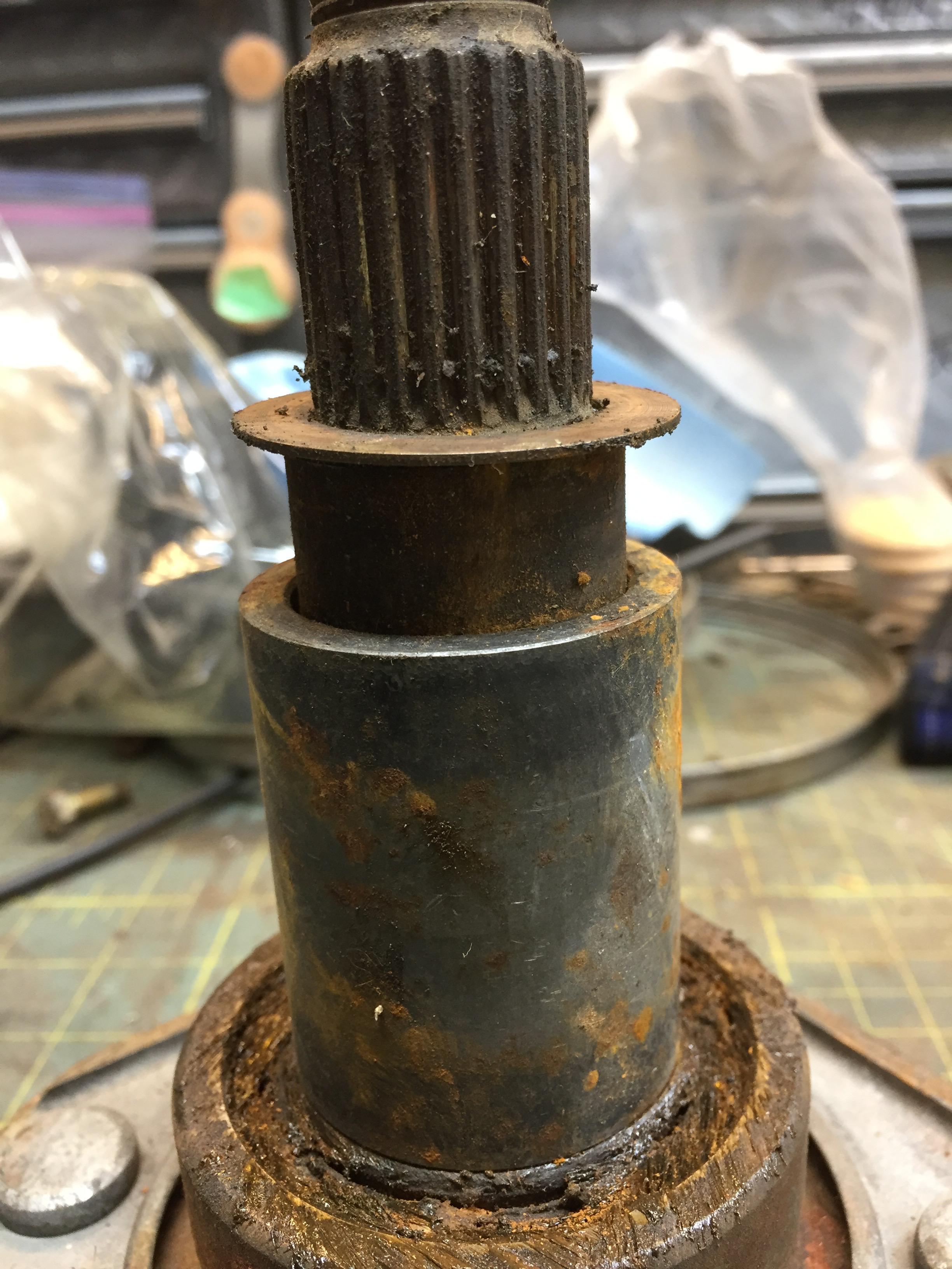

 Perhaps I can do the old "picture is worth a 1000 words thing" here.
The copper washer has an ID of 1.05 inch. The ID of both bearings (hence the OD of the place on the axle where they press fit)  is 1.25inch. That copper washer CANNOT be placed both above and below the distance piece to be used as a spacer.
Here's me putting it over the smaller 240 splined stubby. I have a "B" distance piece on the axle, and this axle still has a grimy outer bearing on it, so the distance piece sits in its correct location.
Here is the copper washer sitting on the upper bearing shoulder. IT CAN'T GET TO THE DISTANCE  PIECE TO ACT LIKE A SPACER. If you have some that will, someone has enlarged the ID of them.

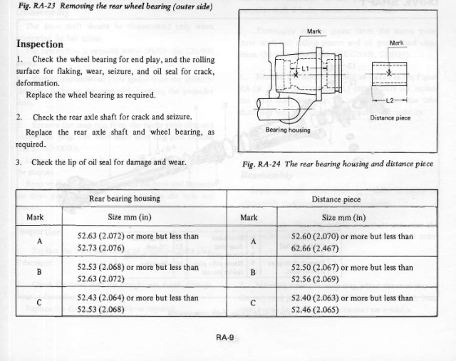

If those spacers on either side of the distance piece in that drawing DO exist as real parts (and they may have at some point) they are NOT these copper noise reduction washers.
BTW, the 280 stubbies won't even let this copper washer get over their larger splines.

A thought on being sure the distance piece is correct for the hub.  Stick the piece in without the axle.  It should be flush with the outer race seat on the other side, within a few thousandths.
....Without the perfect tools, a flush feel by finger is probably good.
Just realized that this doesn't fit my "ball bearing basics" criteria, using the old bearing's inner race.  The old bearing will have wear that allows the inner race to move away from the plane of the outer race.  A flat piece of bar stock or the end of a steel straight edge in the hole would work though, after the old bearing is removed.

Okay, duh. Never bothered to check that. We know the copper washers aren’t the washers in the illustration.
I think the measurement of the space between the bearing seats and the measurement of the distance bearing indicate that there is no room for a different washer to fit, let along two of them. We I’m all good now. Ready to reassemble.

The copper washer has no effect on how the bearings sit in their seats or the compression of the distance piece. It does affect where  the inner stub half sits when its all tight, in an in/out sense, ie spaces it out a bit, which might differ how it fits with the seal or interferes on the sides if the dust flange is bent or something.
Bottom line, that dang washer has nothing to do with bearing fit, preload, rotation torque, or anything important. If you have entire axle play, the bearings are not seated or the inner stub is not touching or compressing the two bearings against the distance piece properly, and about the only way that washer can affect this is if is jamming on the shaft and some force you appliying is bending the washer and not applying compression to bearing inner race. You didn't enlarge that washer hole and put it between the distance piece and a bearing did you?

To me, if your hub and spacer are matched with the same letter, I don't see how you could add a spacer between the bearing and the bearing spacer and have everything work right. Maybe they were mismatched and the spacers were used to solve the mismatch?

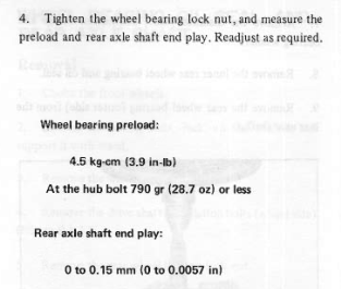

If you decide to not use the copper spacers, take a look at the technical bulletin mentioned above. There is a different torque spec with vs without spacer.

I then tightened the axle nut to 225f/lb to see if it made any difference. Not a bit. I should have thought about this a little harder though, as all surfaces in the front and back and up and down “portions” are a press fit (when holding the tire from the side. Tightening the bolt really wouldnt do anything.   More of an “in and out” when pushing and pulling the wheel.

The spacers match the hubs and are designated with a latter showing the size range they are in.  Most hubs are the same, "B" I believe.  Check the letters on your hubs. If they are the same then mixing up the spacers just moved the play from one side to the other.  So swapping them would just move the play back to the other side.
A better way to make sure things are right is to measure the spacers and the hubs before assembly.  And the axles do have some play.  About 6 thousandths.
