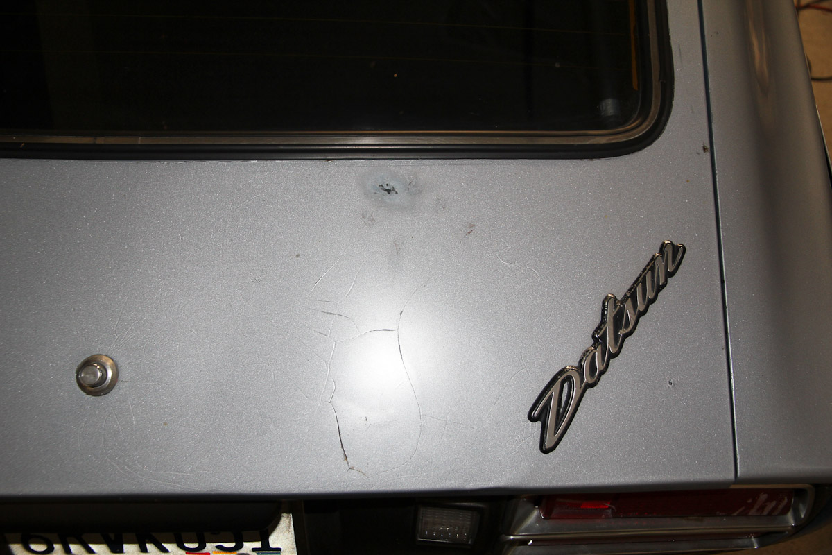

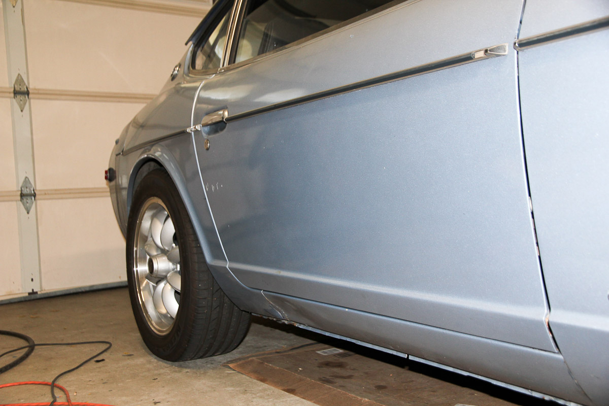

It's not good, but it could be worse. The car's had at least one bad respray, possibly more. The body work I can see that has been done is pretty terrible, and there's small dents on many panels that I'm assuming are areas where no work was done. The worst areas I can see are things like the hatch and passenger rocker, though if I uncovered something especially unpleasant as the old paint comes off, it wouldn't be a surprise.

  5. Fix the dents. This I'm probably the part I'm least worried about. I've done similar work before. And I can't make it worse than this.IMG_4943.jpg
