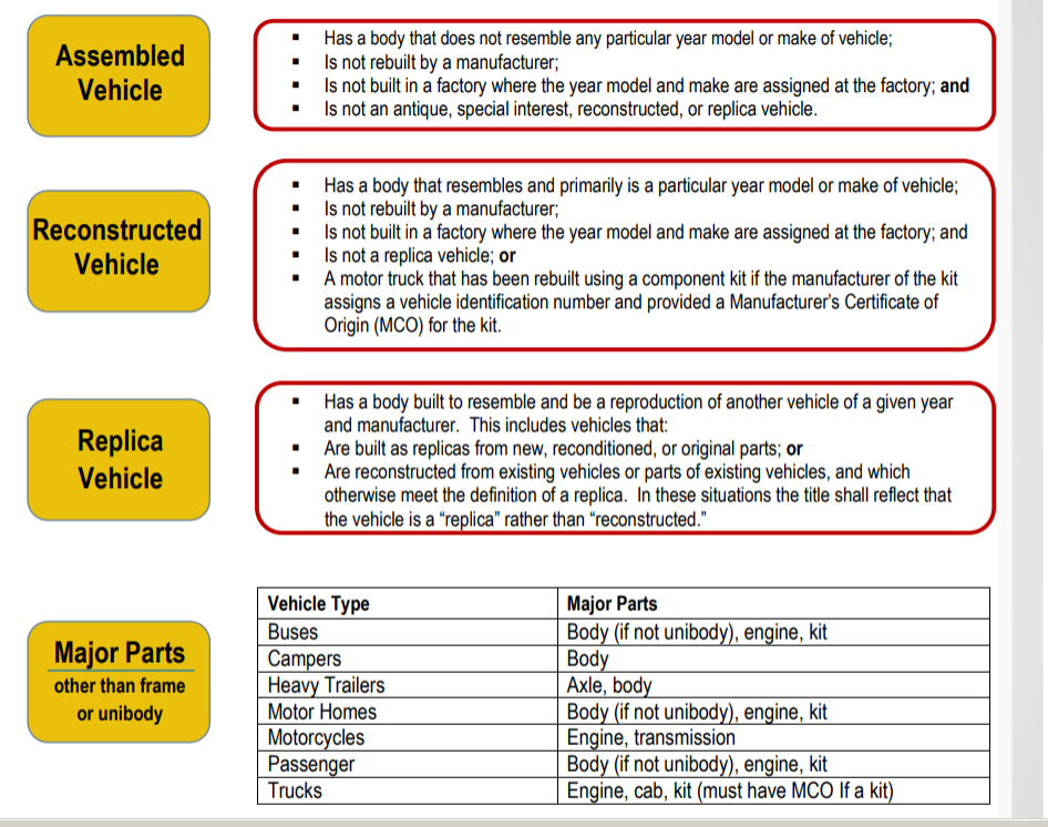

Here's a sampling from Oregon.  The link and a snippet.  The thing about the Z's is that their VIN format doesn't match the common databases that DMV's use.  So computer records are scarce, probably for showing that a car was stolen also.  87mj could probably file for a lost title and get it with the firewall VIN number, then change the other tags to match.
Question - does the engine code match the engine bay tag?  Might be a clue about where things came from.  Pretty common to combine cars to make one good one.
http://www.oregon.gov/ODOT/DMV/docs/trassembled.pdf
