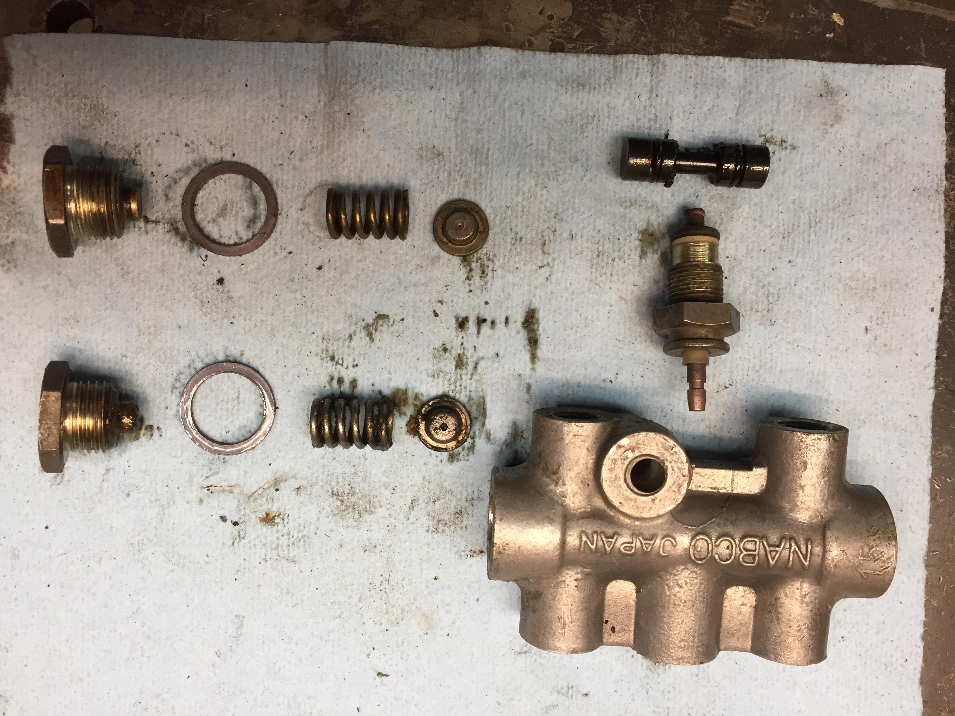

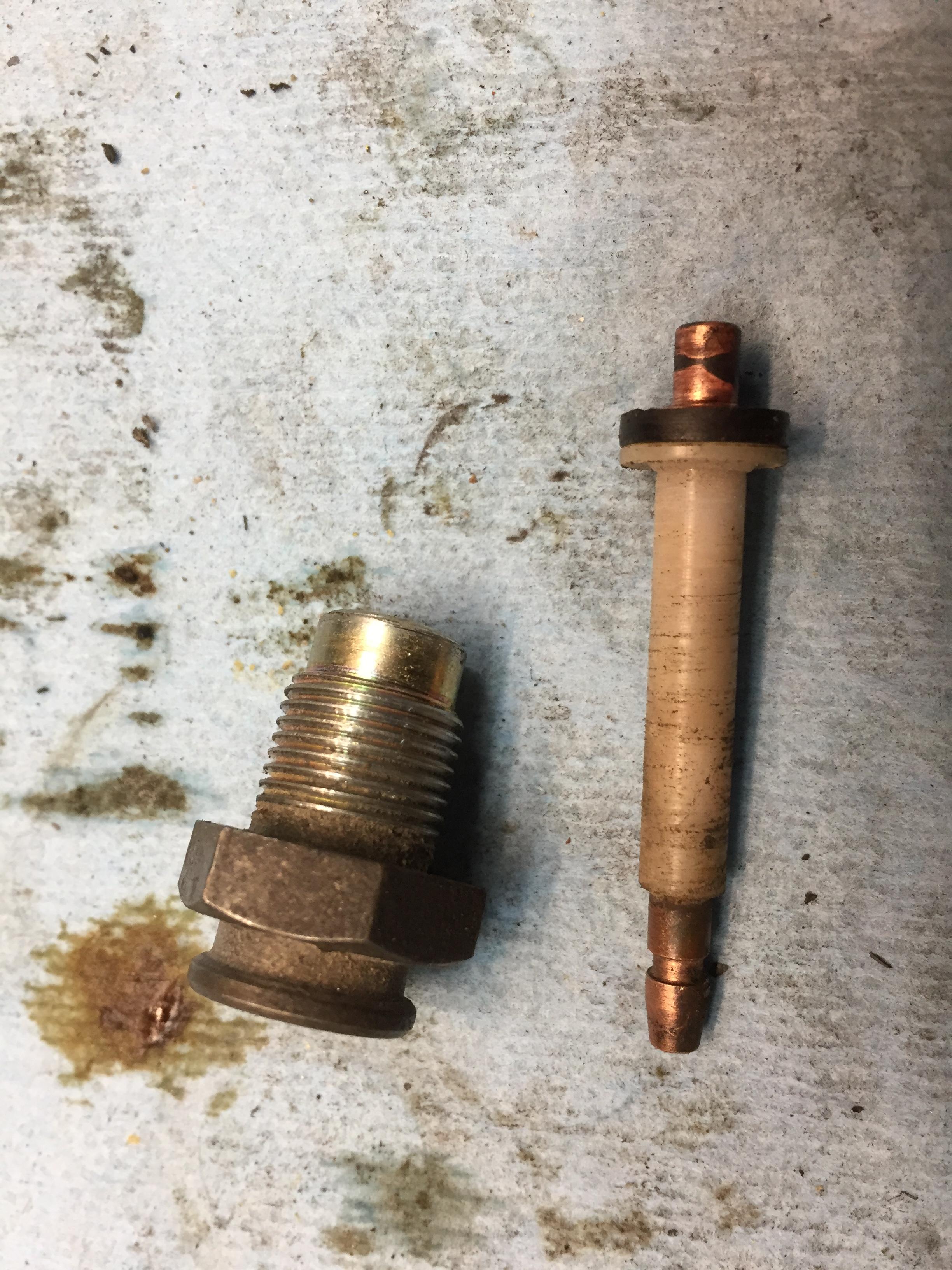

November 28, 20177 yr comment_536028 Yup, looks like mine. Notes. Both sides are identical, save for the hole in the one end cap where the 2nd front brake line goes. The center piston is symetrical as well. The center piston moves very easily and would take only a couple of psi differential to move it, other than the spring pressure. They are pretty stiff. The center electrode chamber and center of the dumb bell shuffle piston never sees brake fluid. The threads on the electrode retaining cap are not sealed to the outside world so moisture can get in and corrode. There is an o-ring at the base of the electrode that sticks into the dumb bell gap that keeps the outside world out of center of the dumb bell shuffle piston. The copper tip of the electrode needs to be clean enough to conduct when the shuffle piston touches it. Both the two I took apart were not dry or clean in that cavity. It's easy to damage the electrode ceramic coating when you take out the center retaining cap. It is supposed to be free, but its often corroded in place, as it has no seal to the outside. As you remove it, the electrode has to rotate along with the retaining cap or the ceramic may crack if the cap is coming off while the electrode stays in place. Gentle heat and penetrating oil and patience are a must here unless you're lucky. A bit of cleaning and two new orings on the shuffle piston are all it needs to work again if the bores aren't pitted. Unless you're doing a resto where stock appearance and function are important, I'd be doing this part instead to replace both this distribution block and the stock rear (or front, later) prop valve. Nothing worse than old brake parts. Ok, maybe old seat belts... Link to comment https://www.classiczcars.com/forums/topic/59039-1972-z-brake-switch-valve/?&page=3#findComment-536028 Share on other sites More sharing options...
November 28, 20177 yr comment_536032 25 minutes ago, zKars said: The center piston moves very easily and would take only a couple of psi differential to move it, other than the spring pressure. In a perfect world I had to soak mine overnight in thinners then spend a couple of hours trying to get the piston to move at all. Link to comment https://www.classiczcars.com/forums/topic/59039-1972-z-brake-switch-valve/?&page=3#findComment-536032 Share on other sites More sharing options...
November 28, 20177 yr comment_536033 1 minute ago, grannyknot said: In a perfect world I had to soak mine overnight in thinners then spend a couple of hours trying to get the piston to move at all. No surprise. Water in the brake fluid would cause total havoc in there. Steel caps, springs and shuttle piston, aluminum case. Everyone get out there and flush your brake fluid, now! Okay, soon, like before next spring. Link to comment https://www.classiczcars.com/forums/topic/59039-1972-z-brake-switch-valve/?&page=3#findComment-536033 Share on other sites More sharing options...
November 28, 20177 yr comment_536076 The early design centers itself with springs. The later design centers itself hydraulically. I didn't know there was question about how the early design centered or I would have jumped in earlier. I'm no expert, but I could have helped there. One question though... My engineering sense tells me the springs in the early design should be different on the two sides because of the proportioning valve. Are the two springs identical, or is one of them wound with thicker wire or have one more turn or something? Link to comment https://www.classiczcars.com/forums/topic/59039-1972-z-brake-switch-valve/?&page=3#findComment-536076 Share on other sites More sharing options...
November 28, 20177 yr comment_536079 Both springs appear identical. Proportioning valves are down stream of this device, which compares the output of the two master cylinder circuits. Edited November 28, 20177 yr by zKars Link to comment https://www.classiczcars.com/forums/topic/59039-1972-z-brake-switch-valve/?&page=3#findComment-536079 Share on other sites More sharing options...
