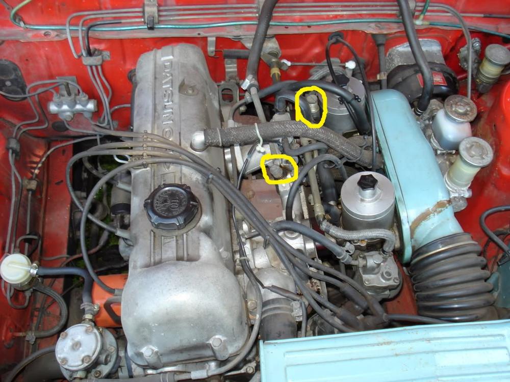

March 23, 20187 yr comment_545500 Borrowing a photo from another thread, you can see the distributor vacuum line going from the fitting on the manifold runner to the left of the front carb. Some manifolds have one threaded hole in each pair of runners, others only have one on the rear pair. From the nipple fitting in this installation, the hose is routed under the front carb and over to the distributor. You can also see part of the arched hose under the plug wires that connects the thermostat housing to the manifold. Ignore the yellow circles from the original post here: http://www.classiczcars.com/forums/topic/45006-twin-flat-top-su-problems/ Link to comment https://www.classiczcars.com/forums/topic/59088-510-sus/?&page=6#findComment-545500 Share on other sites More sharing options...
March 23, 20187 yr comment_545503 The option for vacuum is to take it from the nipple at the base of the front carb, where the yellow cap is in this photo. Considering the other comments, this would seem preferable. Edited March 23, 20187 yr by NVZEE Link to comment https://www.classiczcars.com/forums/topic/59088-510-sus/?&page=6#findComment-545503 Share on other sites More sharing options...

March 24, 20187 yr comment_545520 That sure looks like a ported vacuum source to me. My assumption is that the little brass dot above the "F" is the plug they pressed in after they drilled into the carb throat. On 3/24/2018 at 12:51 AM, Patcon said: That's on the underside of the carb. I will have to look again. I expected it to be on top like the 46mm carbs It's actually convenient to be on the bottom, right? Shorter line over to the distributor. Link to comment https://www.classiczcars.com/forums/topic/59088-510-sus/?&page=6#findComment-545520 Share on other sites More sharing options...
