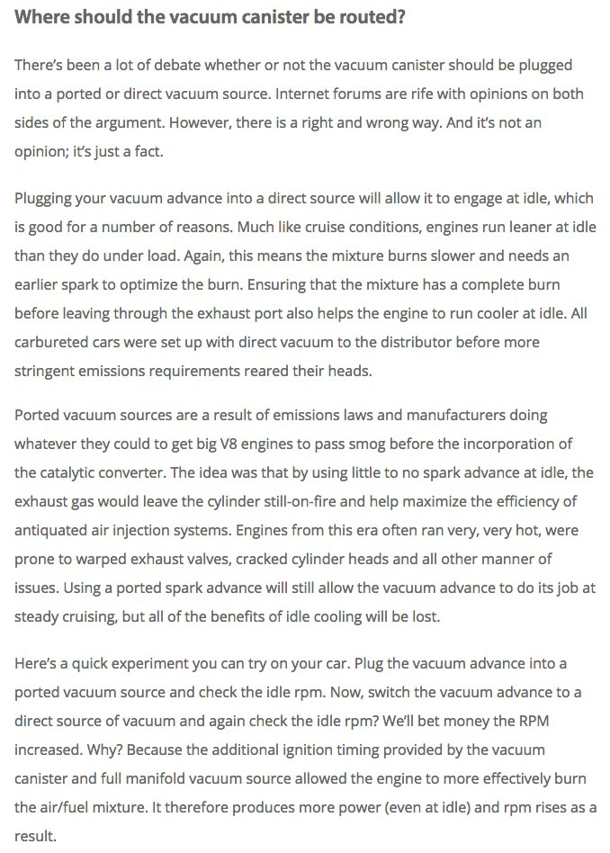

March 24, 20187 yr comment_545523 More discussion of vacuum sources from the Chevy guys: http://www.superchevy.com/how-to/additional-tech/1601-everything-you-wanted-to-know-about-vacuum-advance-and-ignition-timing/ Edited March 24, 20187 yr by NVZEE Link to comment https://www.classiczcars.com/forums/topic/59088-510-sus/?&page=7#findComment-545523 Share on other sites More sharing options...

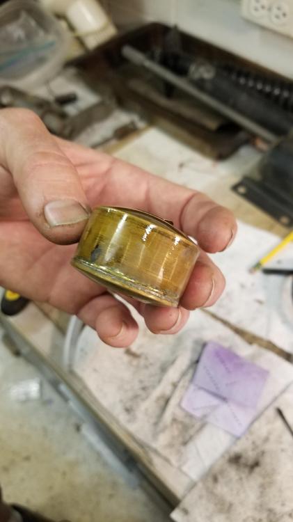

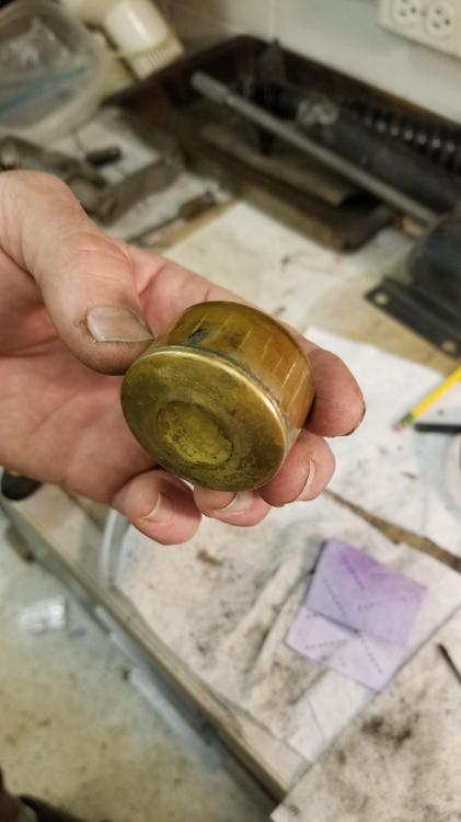

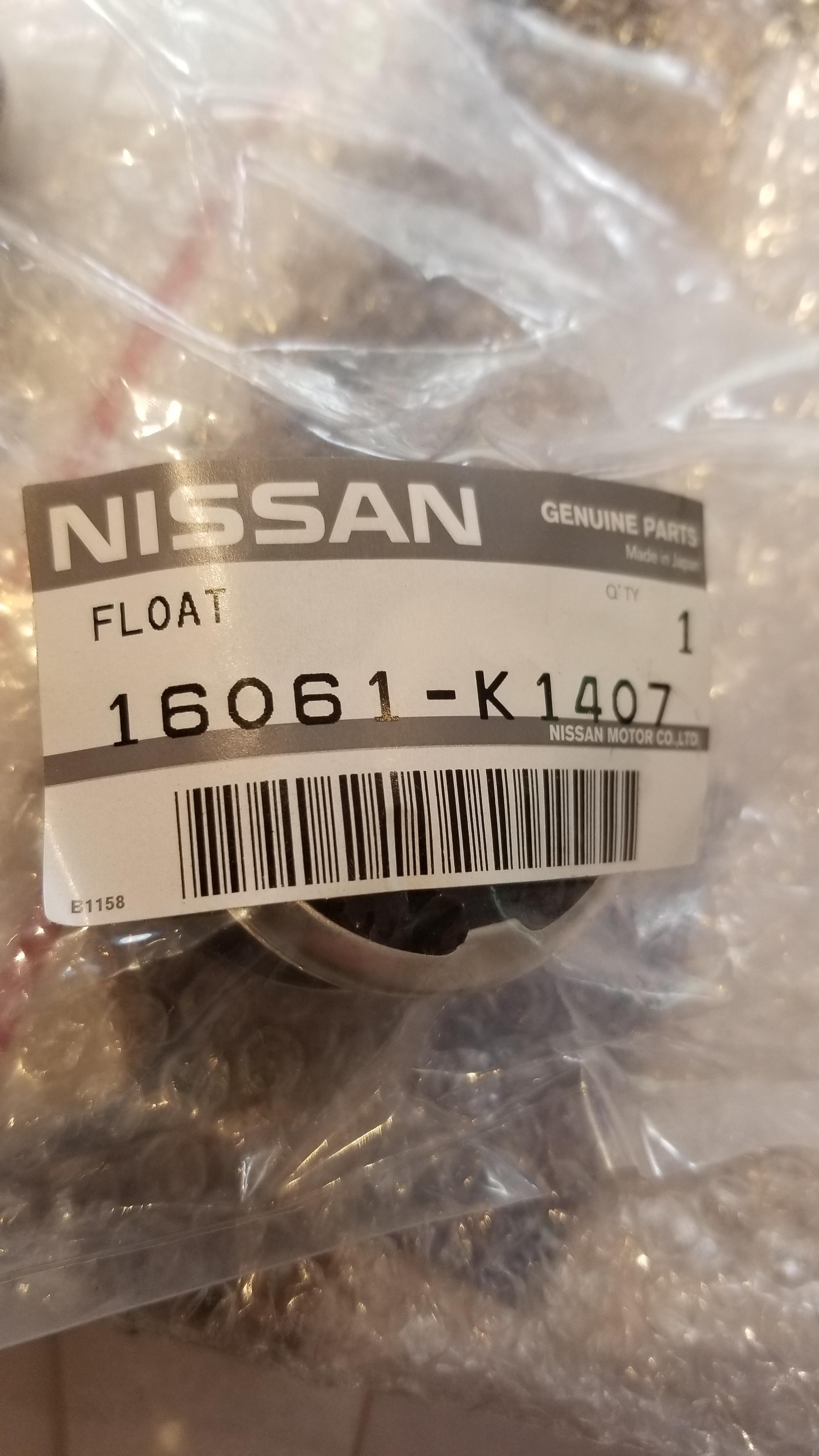

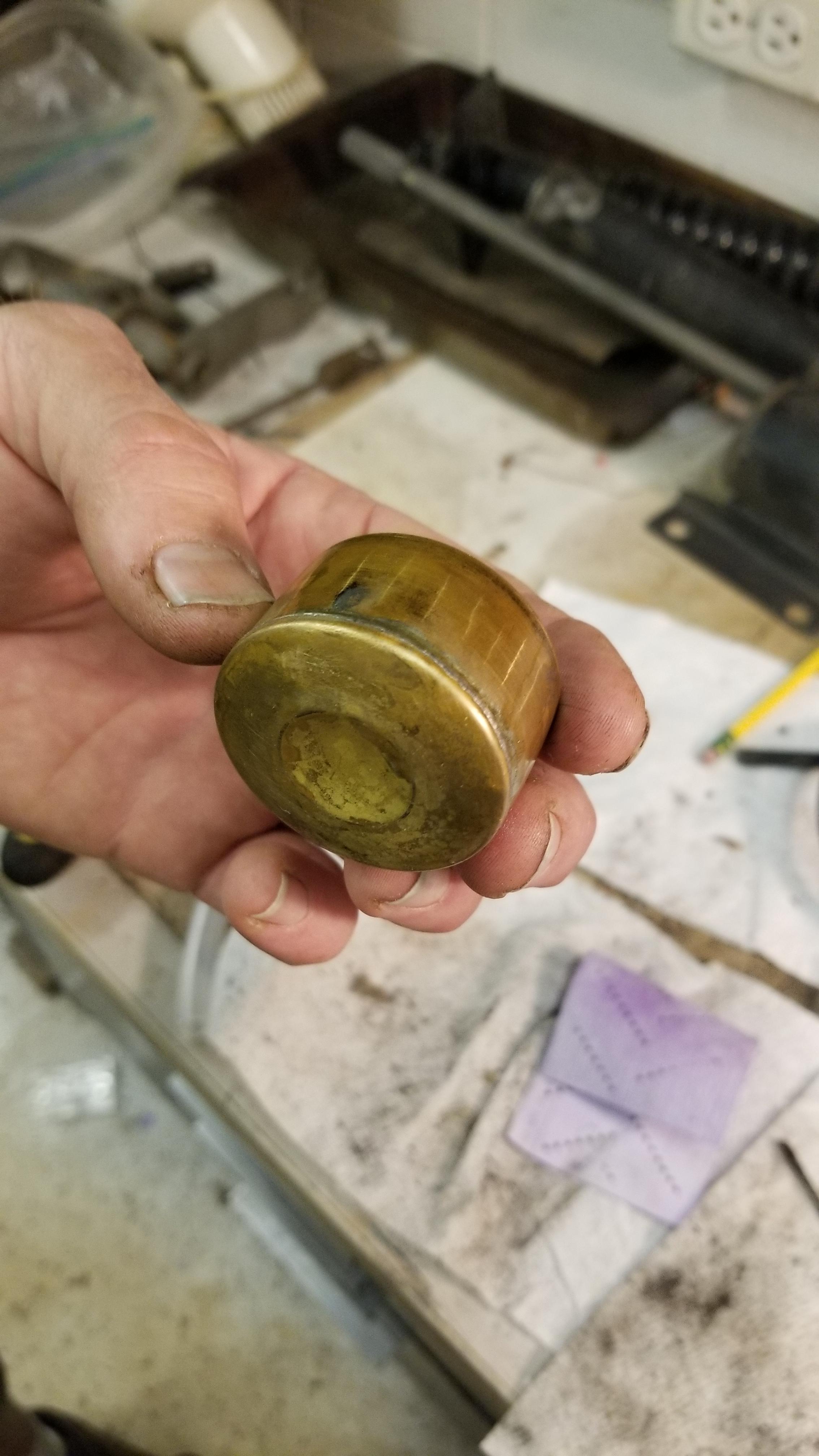

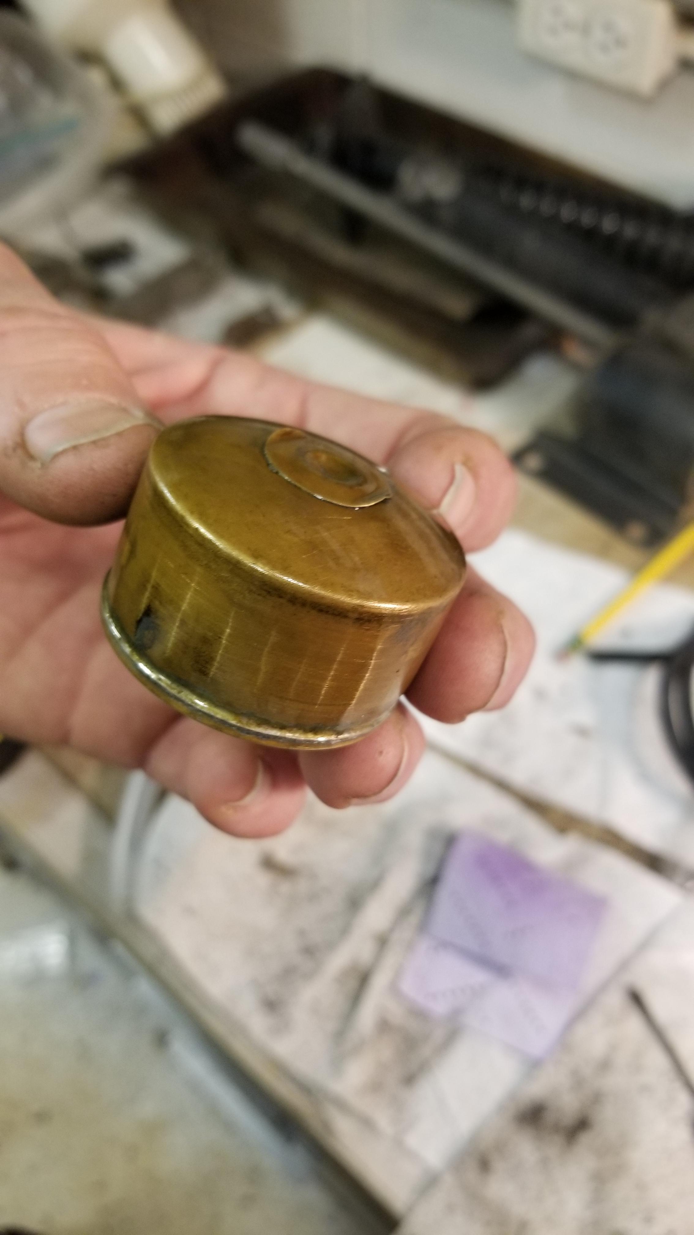

May 26, 20186 yr Author comment_549842 For reference these are the stock floats Pretty much every vertical line on the float was a small crack. So they fill up with fuel. Here is the replacement from Z therapy Pretty much the same price as Courtesy Nissan so I would encourage supporting the little guy who is so good to our community! Link to comment https://www.classiczcars.com/forums/topic/59088-510-sus/?&page=7#findComment-549842 Share on other sites More sharing options...
May 26, 20186 yr comment_549848 I have to get a pair of those too! A fella in town here had the same problem. Same cracks. Craziest thing I've ever seen. Float full of fuel, shake rattle and roll and can't get a drop to come back out. Edited May 26, 20186 yr by zKars Link to comment https://www.classiczcars.com/forums/topic/59088-510-sus/?&page=7#findComment-549848 Share on other sites More sharing options...
May 26, 20186 yr Author comment_549849 On 5/26/2018 at 11:29 PM, zKars said: I have to get a pair of those too! A fella in town here had the same problem. Same cracks. Craziest thing I've ever seen. Float full of fuel, shake rattle and roll and can't get a drop to come back out. I heated them with a heat gun and they would shoot out a fine line of fuel, like a syringe. Heat and pee, heat and pee. I got one emptied out that way. I thought about soldering them up, but when I found the others were available, it was a no brainer. The new floats are solid and will never sink... Link to comment https://www.classiczcars.com/forums/topic/59088-510-sus/?&page=7#findComment-549849 Share on other sites More sharing options...
May 27, 20186 yr comment_549860 Funky! I'm sure the old-time carb guys would recognize that in an instant, but that's the first time I've ever seen something like that. Makes me wonder what was going on and caused that phenomenon. It's so even that it almost seems a relic of the original construction method. Stress risers caused by the ring rolling process to form it into a cylinder? Gear driven, and the pitch of the gears has something to do with the distance between the cracks? Hermetically sealed container that has been flexing and changing shape with many years of temperature changes and finally gave out? Some sort of corrosion phenomenon? Funky! Link to comment https://www.classiczcars.com/forums/topic/59088-510-sus/?&page=7#findComment-549860 Share on other sites More sharing options...
